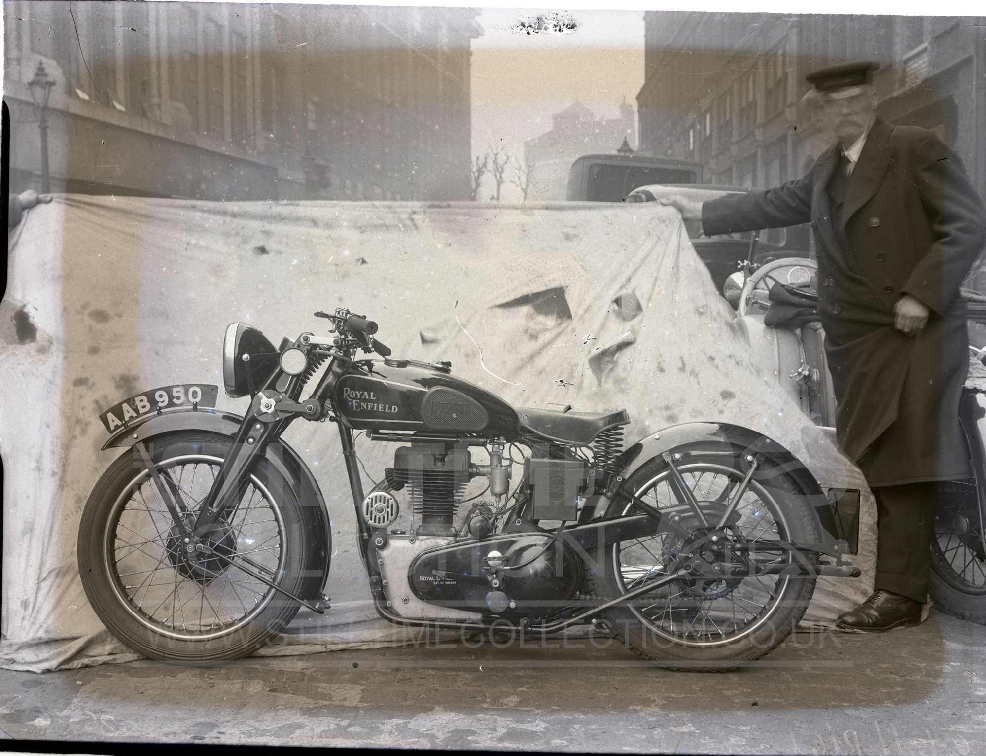

Do any of you know which horn was fitted to the 1937 J & G?
It wasn't a Lucas and I suspect it was a Clearhooters but which model?
I would be most grateful if you can help.

Good question !
Pretty sure you are right.
It looks like a Clearhooters ?
And, not surprisingly, there is nothing listed in the Lucas bible.
The brochure (throughout) only refers to 'electric horn'.
Doesn't go into any detail, and doesn't give a better view.
I've got a project one of these - note the J2 model has tubular girders - so I guess I need to find out ?
Or just use a supercheap $5 one, and ignore the pundits ....
It didn't come with anything in that dept ...

There is some discussion on the WD forum on this.
"This is the front of the rare Clearhooters HF320"
[Linked Image from i.ibb.co]
Inc some discussion that it may have had a Millers badge on the back of it ...

Thanks Rohan.
I have a derelict HF320 in my collection of horns. Looking at the rear view of the horn pictured, it could well be a 320.
This is not my project but I have so far restored the E3HB generator and am in the process of restoring the MCR1 regulator but in 1937 I would expect the bike to have an MCR reg, very rare these days.
I have made to work a Clearhooters HF150 as a temporary fitment for the J.

Have a look at: https://www.stilltimecollection.co.uk. Search Royal Enfield and scroll through photos - a number of them show the vertical slatted grille model
of Clearhooters horn, which could also be badged as Miller, Clayrite, Halfords etc.

Thanks Keith - thats a fabulous archive of pics there.
"vertical slatted grille model"
Mmm, indeed.
https://www.stilltimecollection.co.uk/collection/abn/abn620.jpg
So what model of Clear Hooters is that, do we know.
Details on this maker seem a little fuzzy.

Haven't figured out what model that is, at all.
Miller badge ?
Images seem to be entirely lacking ?

The vertical slatted horn that I looked at is on an earlier bike as it has the E3E generator which was last used in 1936.
I like Rohan's idea of the 1937 model having an HF 320 as the rear view shown seems to be just that horn.
Some of the others appear to have a Lucas HF 1140 horn.
