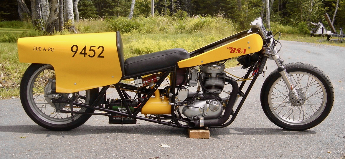

For comparison, here is a photo of my first tail section on my APS-PG that I ran at the BUB speed trials (BMST now). They consider this streamlining so had to run in that APS class. Loring and SCTA allow more streamlining in back to remain in open bike M class, but not AMA - BMST. We were able to form this from a single sheet of 22 gauge (I think) steel. Also, beware of the rules for MPS rear "there shall be no streamlining to rear of a line drawn vertically through the axle of the rear wheel, and the wheel must be visible for 180 degrees of its circumference to the rear of such a line." Tom P.S. The designation on the tailpiece had to be changed to APS-PG.

Tom,
I will need to dig a bit farther before finalizing the design and will send Joe Daly a quick email with a photo to verify but if needed I can notch similar to what you have done. Your Altered bike looks great, thats got to be a blast to run.

Spoke with Joe this morning on this and after his confirmation, I will be cutting a notch into the tail section similar to what what you have on your APS bike, thanks for commenting on the rule! Good thing this is only a cardboard template mockup and not metal so adjustments can be made. Hoping to have this tail section worked out in steel and mounted to the chassis over the next week so I can get the bike torn down and parts cleaned and prepped for finishes.

Just for clarification, the APS tailpiece only needed to be cut out behind that vertical line thru the rear axle at BMST until 2014 (I think) when they decided to allow full partial streamlining as did Loring and SCTA in APS class. But still required in M and MPS at Loring and SCTA. At BMST you still cannot use any streamlining behind the rider in M open class, but allowed in MPS. Which is a shame because it puts the BMST riders at a disadvantage as far as M class national records are concerned. Tom
