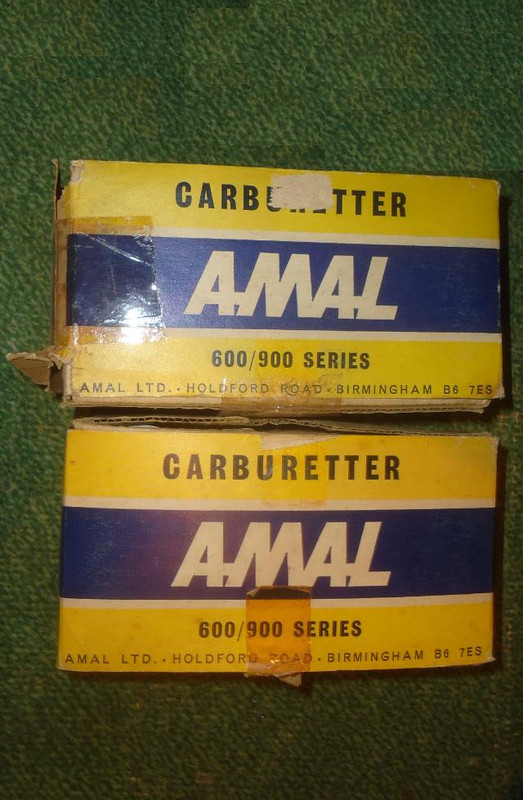

The carburetors were purchased from Andover Norton. According to the label on the box, the carbs received are labeled as follows.
GRN No. 390902
Type 930/38PREM
Main 240
N/Jet 106
Pilot RJ17
Valve 3.5
The chokes are definitely off. The main jets are #240. The smoke was definitely black, very heavy black. The ignition system is original points / condenser ignition. The battery is almost new and spins the engine over very fast. The actual compression I measured was 151 for the left and 152 for the right. Everything I have read indicates that this is good compression, especially since the two sides were so close together and there was very minimal leak-down for both cylinders. I find it interesting that hitting 3,000 RPM has such a dramatic adverse impact on running and power. While idling if I pull one spark plug off at a time, both sides continue to run very rough, to me indicating that whatever is happening is impacting both cylinders equally.
GRN No. 390902
Type 930/38PREM
Main 240
N/Jet 106
Pilot RJ17
Valve 3.5
"930/38PREM" is BSA B44.
https://amalcarb.co.uk/premier-carburettor-for-a-bsa-b44-victor-special.html
The correct Andover Norton AMAL kit for the 850 Mk3 would be PACK113 932/33 & 932/34 (but with 260 main jets for peashooters).
https://andover-norton.co.uk/en/shop-drawing/919/amal-premier-carburettor-packs-
If #17 pilot jets instead of #19s then I can't see how it could have been rich at idle.
Also without the flats on the unused inner throttle stop bosses and mounting flanges they wouldn't fit side by side on the manifolds without clashing if the carbs are not machined for a Commando.
You apparently own a B44 Victor Special so perhaps you were looking at the wrong AMAL box?

I am embarrassed! I was handed the box and didn't look closely at what I was reading. You are absolutely correct. The correct information on the new carbs is:
06.7334
CARB PAIR - AMAL Premier 32MM (850 MK2A/Mk3) 220 JET PACK 113
