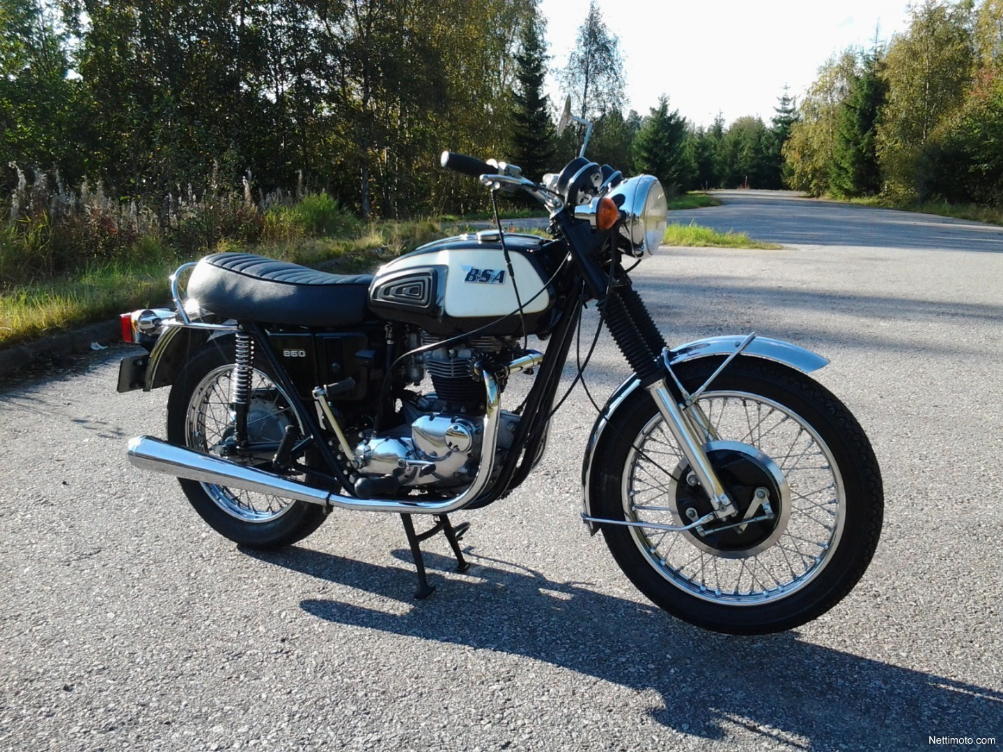

Now about the wheel: I had abandoned the whole idea because I thought I would have to use an OIF wheel, and the only one I have is very rusty. HOWEVER, I thought I saw a photo of an A65 with an OIF front end and a '67-ish front wheel. Unfortunately I can't find the photo now, but does anyone know if this is possible?

I think Mark is referring to the last of the BSA twins, the T65, this used the OIF forks with the earlier 68 - 70 front wheel, presumably the OIF wheel spindle fits the earlier wheel hub, or is modified to fit. https://cdn.nettimoto.com/live/2362893/BSA---d973119657e6fec9-large.jpg
