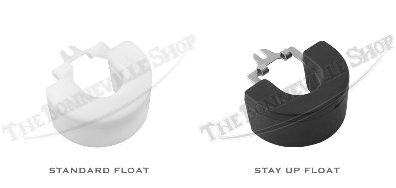

older floats were all plastic .
these tabs were not meant to be bent , so the valve seat would need "drifting"
to adjust float level .
newer floats have bendable stainless tabs .
so float can be set by adding a slignt bend in the metal ( seat does not need drifting )
[Linked Image from thebonnevilleshop.com]
https://www.thebonnevilleshop.com/w...-CONCENTRIC-CARBS-TRIUMPH-NORTON-BSA.jpg

Well That is interesting. Paging Wade!
Posts: 7,350
Likes: 173
Posts: 7,350
Likes: 173
I went through this a couple of times with the VM Mikunis. The first time I was setting height to the wrong reference point. I got it right, but it didn't change much after I re-jetted.
As for the MkI AMAL, I always checked and set them according to the service bulletin. However, my new Premiers came with the floats set even with the top of the bowls, so I left them there and they work well. Could be that the newer floats and needles cut off fuel flow better? Could also be that the original bulletin assumes the use of the stock nylon float needles, which require more pressure to shut of fuel flow?
Perhaps someone could compare the actual fuel level between an old and new carb.
