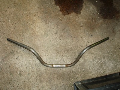

here is as close as i can fund to the full western look
https://www.trojanclassics.com/assets/full/BAR0099.jpg?20200707030809
the Semi westerns are more like this......not exact but best i can find
https://i.ebayimg.com/images/g/JaUAAOSwsypeutKS/s-l400.jpg
but yes what you say ......the full are droopier (good word)
its subtle but they are different

Posts: 8,010
Likes: 148
Posts: 8,010
Likes: 148
I have both the bars you link to ignoramus, the first set “full western” I got from LF HARRIS, if you mount them with a forward lean as per the advertising drawings they are quite comfortable. The “semi western” ones were ordered by a supplier for me and not what I wanted, I did try them and found them uncomfortable, almost like a high off roading bar.
I didn’t get the feeling that the full western was any higher than the semi western, just one set was more swoopier than the other.

Posts: 1,877
Likes: 39
Posts: 1,877
Likes: 39
I like the Semi westerns ........the droop angle (dont ever use that term to a woman hahhaahha ) is to hard on my wrists, horses for courses i guess ....i think the full are slightly higher but due to swoop angle your wrists are in about the same height from tree .....dont know for sure about height need some one to measure them
i think the point we have established is that there IS a difference in who calls what what ...........DANG
