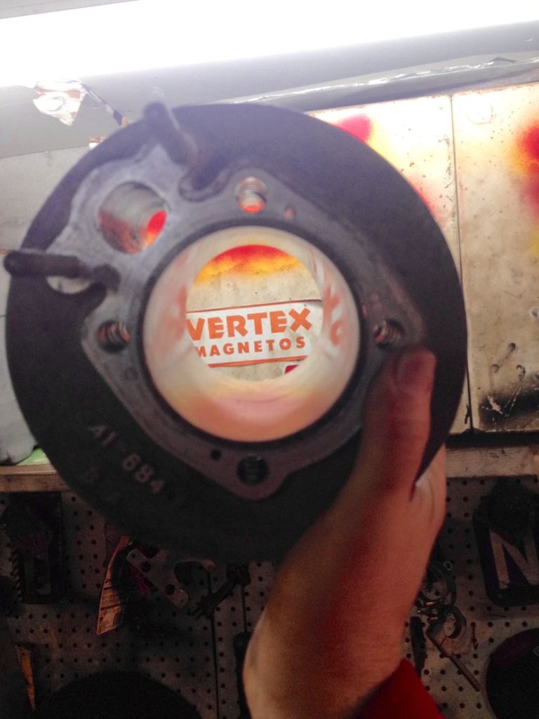

Once the barrel was off I was grinning ear to ear.
Pretty clean inside and no rust that a honing didnt take care of in the barrel. 4 thou clearance piston to cylinder wall. and zero up and down movement on the rod.

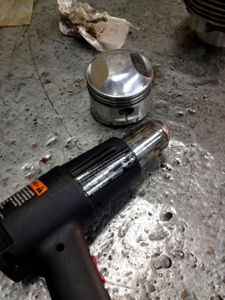

Piston is Japanese made and is 20 over I believe . Looks like it was polished before being put back together
Used a heat gun to try and remove the rings but it only worked on 2 of them. Top compression ring is really stuck. I will try boiling the piston next

Barrel honed and looking great
Like a freshly cleaned shotgun

HNY Wade, for the top ring keep alternating heat ( gun, or blow torch) and cold ( ice pack )it will come eventually, the prep on the piston looks good, nice find.

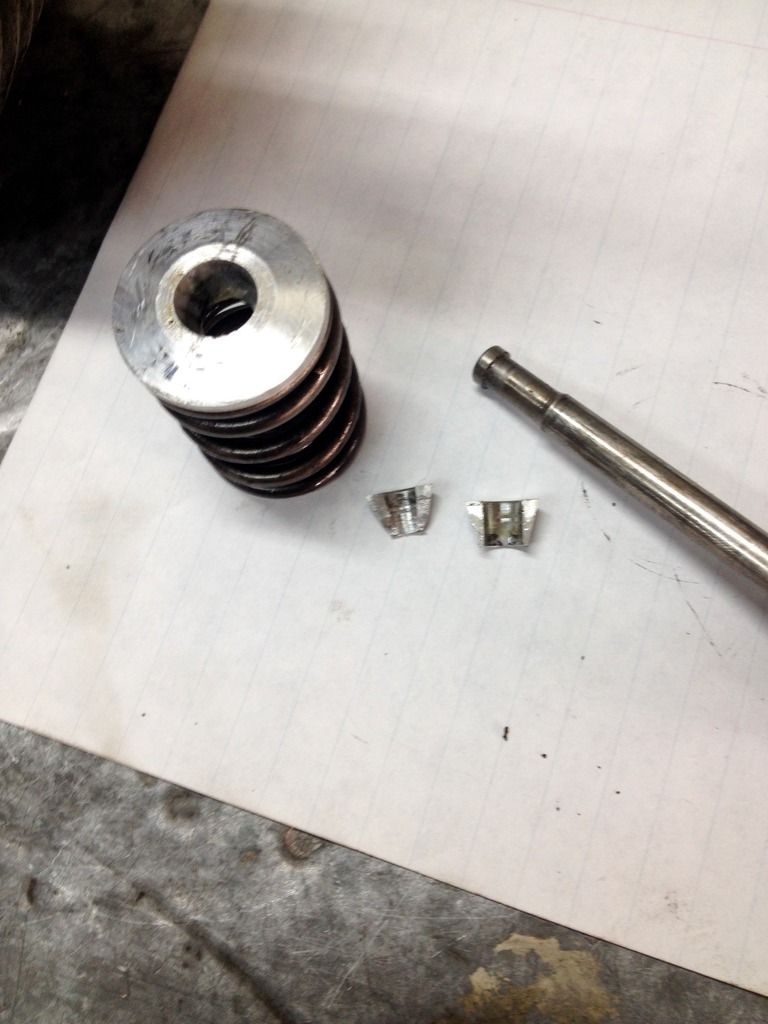

Lighter valve gear is usually a good thing, less stress on cams and valve gear, less chance of valves and piston getting it on when missing a gear.

This looks like it may have been a home made conversion..... Dont know....I say that just because the flat side of those four cone halves seemed to have been hack sawed to make fit the modified valves.
Any other opinions ? Keep the lightened valve train or trade it in on standard????

Its not exactly a high revving engine,, alloy keepers can pull through so I would go back to std.

Did they lighten the rocker arms also or just install
the keepers?

Good question. I will look in the morning . I didn't notice anything but I wasn't looking for it.

Heat gun - Boiled several time frozen then boiled again. Ive gotten the rusted rings out of the piston all exept an 1.5 inch piece of the top ring. Back in the freezer and will try again before I go to bed. Trying not to damaage the ring seats with my jeweler screw drivers that I am prying with.. Pain in the arse !!! But its coming along I guess. Progress is progress smile

Hi Wade , the freezer is a bit slow, a wet rag and a blow torch will give more thermal Shocks per unit time, if you can pin the free ends of the rings in to the slots with a clamp that will help push the rings out, the last bit is tricky, its tempting to lever hard, Ive snapped rings at this point knowing they were never going back.

The freezer bit worked this time. Was able to get my smallest flathead screw driver under the broken ring. When i turn the screwdriver the ring slowly came out . Dont think I hurt the seat at all so I think I have a good piston here :bigt
