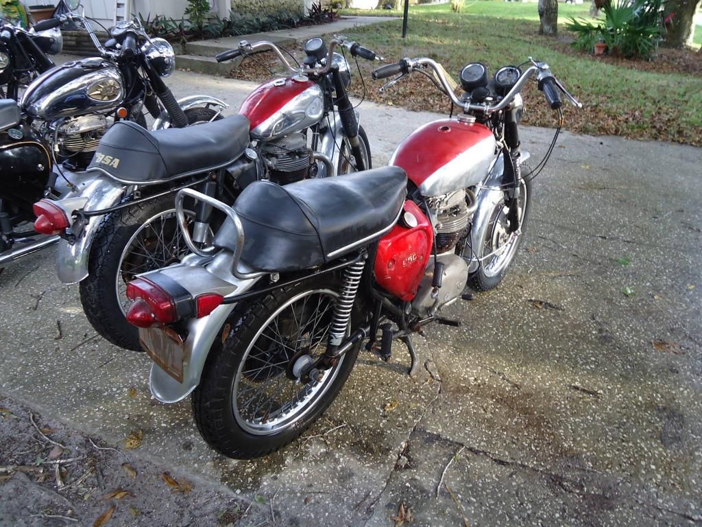

Here's a 70 FS photo.

Thanks J in KC ....The Brochure is nice. So it the red bike . Yours? Looks very original. Wondering about the side cover decals . Didnt know if they had the flags or not and I see quite a few with that decal on the tank. Not on the brochure though. Still a really sharp looking bike. I think I have everything (or a lead on everything) for my bike except paint and decals.

The brochure is correct, which isn't always the case.
Obvious non-standard things with the red bike are:
  • tank colour
  • tank decals (shouldn't have any)
  • side panel decals (should be the later style, as per the brochure pic)
There appear to have been at least 3 variants of the 1970 Firebird Scrambler
  • Candian
  • chrome / blue tank - possibly restricted to the US East Coast
  • arrowhead tank with chrome knee cutouts as per the 1970 Lightning. This might have been a "rest of the world" model.
    Just to confuse things further, the December 1969 Cycle Guide has a road test of a 1969 Firebird.

    Just to add a bit to Shanes assessment of the "red bike": The instrument brackets & cups, headlight brackets & headlight, and apparently, the left sidecover are not correct. Save for the pipes, tank, and front fender, it could well be a modified Lightning. K.C. is correct regarding the sidecover. Stock FS one has the front 2 oddie holes only 3 1/2" apart. Decal is `68 FS only. The `70 catalogue has only one frame part # listed for all model twins, and I can`t recall where that lower oddie anchors. BritTwit will know where.

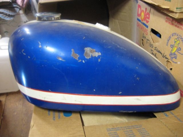

    Boomer,...The `70 Starfire tank was unchromed and entirely blue paint with white stripe. Albeit the same Starfire tank, `70 FS configuration was chromed with either blue or red upper panel. I`ve never seen a `70 FS with the `69 style "under-inflated football" tank. Leon,..is your machine `70 or `69? And, I found the oddie bracket that mounts to the battery cradle - - part # 83-1375 - -FS only. Thanks for the photo clue.

    Like this.....

    I have an NOS '70 FB blue tank in a box somewhere. I always thought it odd to have a BSA tank with no Badges. ........We don't neeeed no Steenkin Batges...... Also, the center mounted cap and welded lower edge is almost like BSA found a bunch of old '66 tanks stock or something, and made do with it for a new model. 1 Year only.
