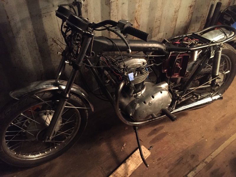

Hi, my name is zoltan and I just picked up my first BSA, british bikes were what got me into motorcycles but could never afford anything but a japanese bike until recently. I have been working on japanese bikes for a while now, but this is my first british bike. I acquired this bike in Connecticut from a big british bike fan who told me the bike runs and rides but theres a clanking noise inside the engine and hasn't dealt with it or care too. I got the bike started, however its not idling, though I have yet to clean the carbs and do some basic maintenance on it. What is more concerning to me is the engine clanking, which increases with revving. I am not against pulling and opening the engine. This is going to be a fun winter project for me. The sound, sounds like it is on the top but maybe you guys can give me some further insight from the video below.
Any general tips regarding british bikes or common issues with this model would be greatly appreciated, thanks!

Welcome, Zoltan, and congratulations, the bike looks very nice. I bought my first BSA, a 1971 A65L, three years ago, and this forum has been a great help. The sounds coming out of my BSA are different than the sounds that come out of my Triumphs, I am still getting used to that.
First thing I did after getting the BSA was to buy a FACTORY shop manual, a genuine parts book, and an original owners handbook. You should be able to get them from some of the forum sponsors, or resort to eBay (I confess!).
Thanks for posting the pic and the vid, it really helps. Please post lots more pics, or link to an album, I for one will be glad to look them over. If I lived closer, I'd offer to have a look in person.
It sounds like it is running on one cylinder -- are both head pipes getting hot? If it is running on only one, the clank could be the sound of the piston in the dead cylinder slapping around. Since you have worked on other bikes I'm assuming that you know how to check for spark and check compression.
Before starting my bike the first time, I pulled the carbs off and apart for cleaning and to check all the components. Lots of help on this forum on what to look for if you do.
But "clanking" may be cause for alarm. Might just be time for that winter project you mentioned.
Please tell us what are the two letters after "A65L" in your frame and engine numbers. That way we can tell you if it is a '71 or a '72. A few things on it look like '71 at first glance.
In your clip, one thing I hear is intake noise. Your air cleaner covers are swapped right-for-left so that the rubber hoses are not connected between the air boxes and the carbs. Here's mine:
Hope that helps, others may comment with different views, I expect,
Kurt
PS -- My bike was a total rat when I got it, then after cleaning it up, fixing it up, and getting it running, I rode it 20 miles, then decided to tear down the motor, and it is in pieces now, my winter project. In retrospect, I think it would have been better if I had taken it apart before riding it. I found broken valves springs, and the exhaust valves are very loose in their guides.

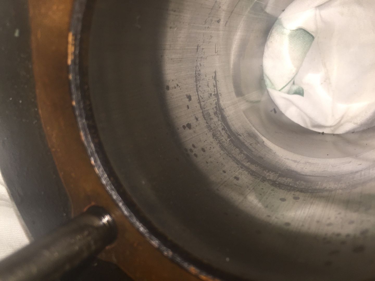

So, since I've been on break I have gotten some time too work on the BSA. I plan on making this bike into a flat tracker with modifications done that can always be reverted back to the stock bike.
The image attached is a little old but I cleaned the carbs and put them on and the bike is idling well. The left spark plug was fouled and I think that was the cause for it not idling along with messing with the jets. The carbs probably didn't need a cleaning, good to do anyways however.
So I got under the cover and I found a free large washer smirk I looked hard but it really didn't see a free nut or something of that nature or anything missing something like that. Not sure if the past owner just accidentally left it in there or what, but it is a little concerning. The valve clearances all checked out to spec but I redid all of them anyways and the knocking noise does seem less prominent but I feel like its still there and or now that both cylinders are running they're maybe muffling the sound a bit making the sound less prominent. No metal flakes anywhere or anything loose though. Now that the bike is idling, even with the engine issue its may be hard to resist to take the bike up and down the road since its going to be 50 degrees on christmas tomorrow here in NYC laugh. Though, I may wait to not cause further damages and problems down the road, I will post a video of the current engine sounds and I have my fingers crossed its just normal bsa valve noises.
left side: [Linked Image]
right side:
Also need a new gasket smile

You don't need to open the timing case to check valve timing. You can check it if you remove the rocker cover.
Bring the engine to TDC. On one cylinder, both valves will be open a little over 1/8". The intake valve should be open slightly more than the exhaust (maybe 0.040" more), but they will be close to the same lift. If you're out by one tooth, the difference in valve lift at TDC will be huge, more like 1/8".

Tracker aesthetically, without any irreversible changes, no I don't plan on racing it, for those who keep bringing up the tracker thing up.. didn't mean to step on any toes haha.
Anyways, some more info on the bike: title says its a 1972 lightning, and the engine has a little over 2000 miles on it.
Engine knock is still there! Rockers and everything appear to be assembled correctly, and valve clearances are correct as per the manual.
Oil is getting to the top end, I know this because I ran it without the rocker cover on :p. Nothing dangling around in the tunnel. Everthing simple seems to be out of the question, however I haven't checked for the loose rotor, though it just seems to top - endy to be that, but may be worth a check anyways..
https://www.youtube.com/watch?v=WFYl1_bhl-8&feature=em-upload_owner
any other ideas before I have to really dig into this engine and remove the head! thanks in advance!

So, some bad news! I called a british bike shop in Connecticut (maciag) and they have the bike on file and it had piston slap. Called a couple places and a full engine rebuild is really out of my budget. One place said that the piston slap is probably from something about starvation of oil and the crank, a 3-4 thousand dollar job. Now I could tear the engine down, maybe get the cylinders honed / bored with new pistons, but it seemed that the crank issue is what most likely caused the piston slap in the first place, so I don't wanna put a bunch of money into the top end and have the same issue not too far down the road. Do you guys think it'd be worth it too tear it down anyways?
Are all A65 engines interchangeable from various years? Was thinking it might be worth just finding a new engine entirely as a full rebuild would be far more expensive... than even an entire new bike really. Let me know what you guys think.

Yes I know it is still firing on only one cylinder, the left ones not firing... didn't think it had anything to do with the noise, and its hard for me too notice the difference I'm not use to bsa's idle - along with this engine clammer..
I just ordered some 2 dvd course off eBay on a65 engine rebuilding haha... manual finally came in the other day as well..
looks like I got myself a project ahead of me... I'll be posting lots of pictures in hope for suggestions.
pulling the engine tomorrow laugh

Also I don't feel any play on the rods so fingers crossed i don't have to split the cases...
having trouble getting the pistons of the rods
however I believe the pistons look a bit scored? However it feels smooth theres not pitted scoring
not pitted scoring on the cylinders either..
cylinders:
Some advice I got about the noise and rebuild:
Zoltan,
If you're going to pull the head off, I should tell you this: If the engine did not suffer oil starvation, and simply ran enough miles to wear the cylinders past normal wear limits, then with just the head off you'll see cylinders that look reasonably smooth. They would be actually worn oval, but you'd probably need to measure them to tell they were worn oval shaped.
If, as you were told, the problem was oil starvation, then you will no doubt find severe scoring and grooves worn into the cylinder wall. If you do see such scoring, then you may well need more than a top end rebuild.
Zoltan,
Without having the engine here to look at, this is all guesswork, but, I can tell you that I've seen very few A65 engines suffer from oil starvation. Also, I haven't run into a lot of those engines that have cylinders worn so far that you hear the piston slap about in the cylinder. It is much more common to have loose gudgeon pins, AKA wrist pins. It isn't actually the pins, but the small end bushing or the hole in the piston itself that gets worn and the noise is referred to as 'loose wrist pin'.
There is a way to get a good indication of whether or not you need a total rebuild versus just a top end rebuild and it's not very hard to do.
Do this: Remove the round cover located in the primary case over the alternator rotor. It's just forward of the brake pedal and has the BSA logo cast in it. (Of course, this assumes that no one has put a different year cover on your engine.) With the cover off, you be looking a the end of the crankshaft and a large nut holding the alternator rotor in place. Now, get a large pair of vise grips and lock them onto that nut. Once you've got a firm hold on that nut, push and pull it back and forth to see how far the crankshaft will slide, in and out. You should find almost no movement as the proper end float should only be 0.001 to 0.003 of an inch. If you find the crank moves only this small amount, then the crankshaft assembly is probably ok. Putting an oil pressure gauge on it to test the running pressure would be the next procedure, but that would be more involved.
If the crank moves in and out much more, like 0.050 inch or more, then you may need a complete rebuild. I say 'may need' because I have seen engines with way too much end float on the crankshaft, but the top ends were just fine.

Unless you split the cases and clean the sludge trap, any money you spend now will have to be spent again on a full rebuild very soon. A while back I bought a "fully rebuilt, zero mile" engine, which had obviously been worked on - very clean, new bolts, new gaskets, obviously new valve caps and springs etc. I won't go into the horror details, but within a few weeks of fitting the engine (with an oil filter and good oil) it was totalled. All the bearings were shot, the crank oil feed had blocked and the heat popped the left hand gudgeon circlip and destroyed the barrel. Looking at the remains, the big end bearings had been replaced (along with valves and so on) but the sludge trap had never been removed in the life of the engine. End result was around $4000 in repairs. It doesn't take much to split the cases once the engine is out of the frame and the extra couple of hours is time well spent. With the damage to that tappet I'd be very wary of spending anything without a full pulldown.
thanks for the reply.. I was hoping not to split the cases but its probably the right thing to do and that chip is probably somewhere down there as well.
I guess now I need the special tools to split the cases.
Joined: Jul 2014
Posts: 42
Joined: Jul 2014
Posts: 42
If you have a local BSA guy, take the inner timing case off along with the oil pump and so on, remove the primary case cover and take the plates out of the clutch then take the remaining lump over and let him split it. It really only takes about 20 minutes for an experienced BSA mech to dismantle one, so it shouldn't cost much. You'll need someone used to the engines to set the crank end float etc during reassembly.
Joined: Jan 2015
Posts: 139
Joined: Jan 2015
Posts: 139
If you're going to do all that, it isn't much more involved to split the cases.
Just take your time and pay attention to what goes where, maybe take pictures as you go. While you might get away with new cam followers, the cam is probably damaged looking at the cam followers I'd say the PO was a POS when it comes to maintenance. As others have said here take the time now to do the whole job and you'll thank yourself later.
FWIW the sludge trap in the basket case I'm working on now was clogged and it took out the left side rod journal, rod, piston, and put a hole in the left side case. There are videos online of sludge trap cleaning, check those out.
Have fun smile

Here are some pics of the cam: there doesn't appear to be any chipping or visual damage however I don't know what cam wear looks like anyways sick
hoping not a lot of things need replacing only 2000 miles on the engine but it appears it was abused.
they're smooth to the touch

As much scoring as I see on the cam lobes, that was a dirty engine, rarely getting the oil changed often enough.
The pistons and cylinder exhibit this as well.

With only 2k miles on the engine, the pistons and bore should be FAR from worn out.
Likewise, the small end bushes...
But, the cylinder should have at least a light honing, and a thorough cleaning, then the clearance checked by someone who knows how to do this properly, then you can say weather or not it needs to be bored oversize...
Oil starvation... I have yet to see where this may have happened, I'll bet whoever said this to you, was fishing for higher profits.

Having trouble with the bike wiring again. The little bulb in the front headlight (not the headlight bulb) it's attached to a the white wire... Well when I try kicking the bike over the power dies and it won't start... Then the light will pop back on on its own. I was thinking a short somewhere or something but even then the bike would start. Went through the harness for hours can't seem to figure it out, any help or suggestions would be really appreciated
Posts: 6,200
Likes: 317
Posts: 6,200
Likes: 317
Ignition switch. clean and check resistance across contacts, or a poor connection somewhere else on the ignition feed.
Or bad earth connection, positive side of the battery.

Thanks for the suggestions, it isn't the ignition I even tried hot wiring it. Ignition light still goes out when I kick it over. Bike will put and turn over but won't idke - ground is very secure I made sure of it. At a loss of ideas
Posts: 6,430
Likes: 682
Posts: 6,430
Likes: 682
Zoltan--what you are referring to as the ignition light is NOT an ignition light as you would see it in a car. It is actually an oil pressure warning light. When you switch the ignition on with the engine not running the light will come on because the oil pressure is low--zero in fact.
When you start the engine the light will go out as the oil pressure increases.
Then when the engine idles the light may come back on or even flicker--this means that the oil pressure is low---nothing to do with the ignition.
The light going out when you kick it over is just that the kicking builds up some oil pressure and the light goes out. Then when you stop kicking the light will come back on as the oil pressure reduces to zero.

Hey thanks for the suggestions guys, not sure what did it, should've went one at a time, however I adjusted point gap and threw on some new spark plugs, and cleaned the jets even though I know I've been ONLY using clean fuel - tank is sealed as well - and the spark plugs that were on were only a few weeks old, well she fired right up and idled well.
Bike was running well then -wtf - never knew what a bike sounded like when it jumped a pushrod. scary might i add... thought i blew a hole in the piston or something... Seems i tightened the lock nut like a pansy- anyways tightened the rest of the locknuts better - bike sounds a lot quieter now too. However NOW there is a lot of smoke coming out of the left pipe - white grey- definitely oil... did I tighten the clearance too much now. I have almost sacrificed enough to appease the motorcycle gods shocked
never smoked before even after replacing the cam follower
going to check for wet sumping - though wouldn't that cause both pipes too smoke? valve guides were good last time I checked - thinking perhaps theres excessive oil in the top end - maybe slight blockage in the return.. will check tomorrow
still need to put on the stock tail light, need new gauge mounts, and turn signals. still needs a good cleaning probably won't tear her down completely till next winter. Any trick to put on an led tail light to this positive ground gal

Zoltan, first of all, congratulations on sticking with it, the bike and this forum. You are "learning by doing," has its risks, outweighed by the rewards.
As to the LED taillamp, most of those you see on eBay are for negative ground only. Check here for some + ground LED replacement bulbs:
http://www.norbsa02.freeuk.com/goffyleds.htm
I'll leave the smoking to others, more perceptive than I ... .
BTW, bike looks good. I'd suggest adding the stock rear fender loop, otherwise, the fender will no doubt shake itself into two pieces. [edit: Looks like you have the grabrail&fender loop in the first post&pic of this thread, and a subsequent pic shows the frame loop intact.]

A LED taillight assembly will save you a lot of bulb changing. I'm very happy with mine, which is now eight years old
- a local Dutch product.
The pictures suggest the frame was cut behind the rear shock lugs. I may be wrong though...
With a grab rail through the taillight horn you may be able to solve that.
Joined: Nov 2014
Posts: 59
Zoltan Offline OP
Joined: Nov 2014
Posts: 59
I plan on putting the hoop that connects to the fender back on, it's not cut haha I wouldn't cut into this thing
Posts: 5,864
Posts: 5,864
Some frames got cut up by previous ownes, people who want to turn a bike into a bobber or chopper.
I'm happy I was wrong.

The smoking is more than likely fuel if it's grey in colour, white( steam) is water ( and if your getting that then there's problems) and blue is oil.
So you either running rich or your valve clearances are a little tight, book states .008" inlet and .010" exhaust, you really do not want to go tighter than that. You also want to check your idle mixture once the engine is warm and that the needle position etc is correct according to AMAL ( and not always the WS manuals, as these can be incorrect even at time of print)

I believe its definitely a white is blue - hard to tell. Getting oil dripping out of left exhaust. Thought maybe theres too much oil getting to the head - could anything be causing this? I have the return line working well - tested when the bike was running.
Thought bike was running rich but right pipe starting to glow at high rpms could be timing? or something else?
Idle mixtures don't seem to be having any effect on the idle.
Really want to get this bike going by this weekend, but too many issues. Hoping the piston rings are fine... as well as the hoping that oil isn't leaking down the valves smirk
Is it possible I installed something wrong under the rocker cover causing excessive oil to get to the head..?
thanks in advance to any suggestions
So you either running rich or your valve clearances are a little tight, book states .008" inlet and .010" exhaust, you really do not want to go tighter than that. You also want to check your idle mixture once the engine is warm and that the needle position etc is correct according to Amal ( and not always the WS manuals, as these can be incorrect even at time of print)
Thanks, my plugs definitely indicate that I am running heavily rich and they have fouled twice now. Going to do the valve clearances again, hoping its nothing serious like messed up rings or leaky valve guides

My experience has been that when my bike wet sumps while on the side stand it will smoke from the left pipe on starting. More oil on that side.
