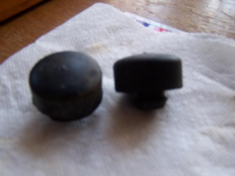

For BSA's the air cleaner tops are flat rather than stepped as in the images.
If you want to sell the domed covers, I'll happily take them off you, I prefer them and also have the matched domed screw on portion

Would like to see pics of those. I only remember mine having the one big bumper at the bottom on the batt cover where the hole is. Suspect you know that but I don't understand "clips". Memory hazy tho...

you need 2 buffers # 40-8046 ( see pic) and 2 clips one at the top of each cover

When I stripped an original 1970. The left hand buffer ( battery side ) was the larger type. The oil tank side was the smaller type which is the same as used under the seat ( supposedly although I have never seen buffers under the seats)
Note: on the bolt on bracket that holds the rear of the left cover, 70' models should have a distance piece between the bracket and the frame tab. Without this the big rubber buffer is too big ( and the small one is too small ) I was cheap and cut a big buffer down to size.

See item #5 (below) from the spares catalog. They are referred to as "buffers". I have 4 clips with a rubber hose that slides over each one, then they then apparently clip around the frame tubes (somewhere) to prevent the covers from rattling. The idea makes sense but where exactly are they supposed to go? The only place I see as having a clearance issue is at the top of the cover so that perhaps explains where 2 out of the 4 go. I have the big rubber buffers but the replacements I bought from BrittishOnly seem way too big and will not fit behind the cover and the lower frame tube. If someone can make a measurement of the proper thickness of this big buffer/bumper/snubber thing (item #12) then I'd appreciate it. And the foam pad, #3, goes on the cover or the frame?
You've built up a very smart looking A65, and I understand your reasons for a "stock" setup. However, those clips you refer to won't stay in place. I have an original one and it's simply not tight enough to stay put during use. I'd ditch the clips and use a piece of black foam pipe insulation . This stuff fits very nicely around the frame and provides good protection to both the cover and the frame. Unless your not going to ride this bike, put the foam pad and clips in a box.
Also, cut those oversized rubber bumpers down just enough (about 2/3rds) so that the side panels are snug against the foam insulation when the oddies are pressed in place. Those panels won't budge when the bike is in use.

The metal band clips with the rubber around them go on the frame tube just below the seat, so the very top of the side covers ride on them. The fiberglass side covers crack right there in short time. I put multiple layers of thin strips of black tape around the frame tube above and below the clip to keep it in place, as it vibrates out of position.
