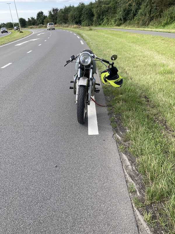

yesterday, shake down cruise, after the sixt roundabout lost the clutch, how lucky can you be.
did all in all about 190 miles, things to sort: carburation, riding position otherwise fun to ride
how lucky
