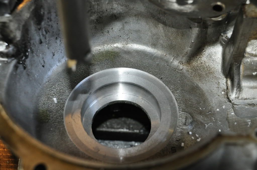

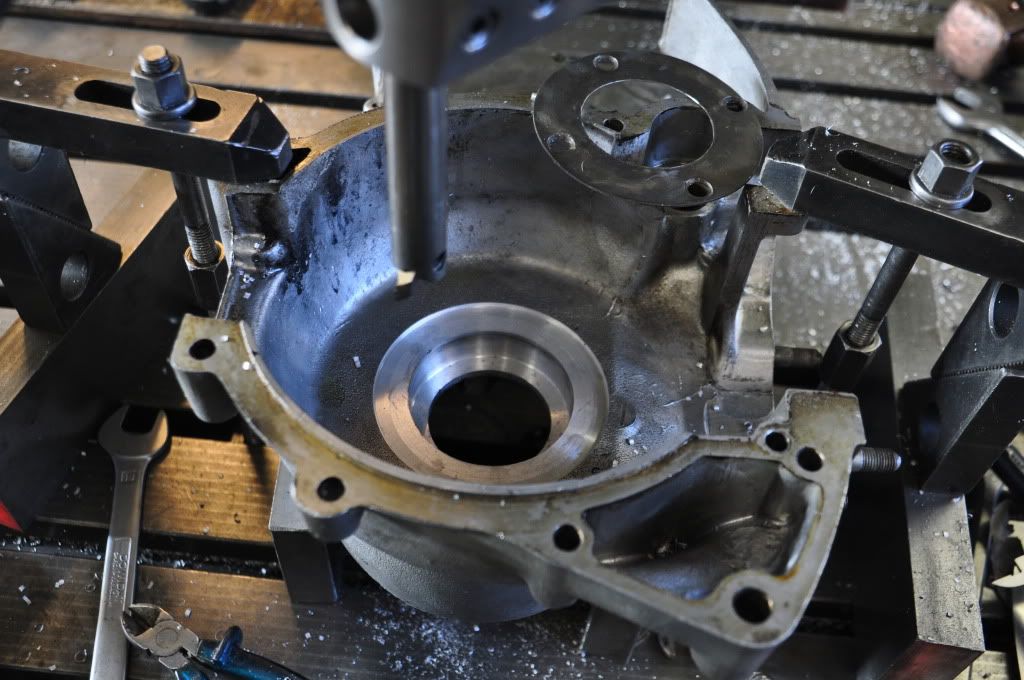

Adam: the cranck is locked on the driveside by the plate inside the superbland bearing. you can see it on the picture I posted before. On the timingside its a bigger , wider needle bearing than SRM uses, because ther is no need for a trustbearing/ballbearing on the end. As you know SRM are using a combined ball and needlebearing. that makes the needlebearing shorter and therefore has a bit lower radial bearingload.
Posts: 198
Posts: 198
machining of the cases for new bearings
