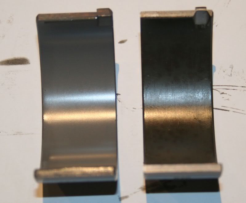

ACL bearings for Mini compared to VP Norton bearings.
If there was a demand for smaller Norton rod bearings, like My crank needed, -.050" perhaps ACL would make some. However if one doesn't mind modifying rod bearings the Mini cooper ones are very close:
The main difference being the width, which in itself is not a problem because theres plenty of room in the rod and on the crank for the extra 1.6mm, the complication is with the tag (in a std rod) if its filed away on the outer side till the tag is the same width as the Norton bearing it will clip into the rod but a little off centre so when rod and cap are put together the shells are staggered to each other, if the shells are linished to remove the extra 1.6mm so they are the same width as the Norton shells they would be in line.
As it is The ridgecrest rods I use retain the bearings with a central pin, so I have them centred keeping the extra width.
