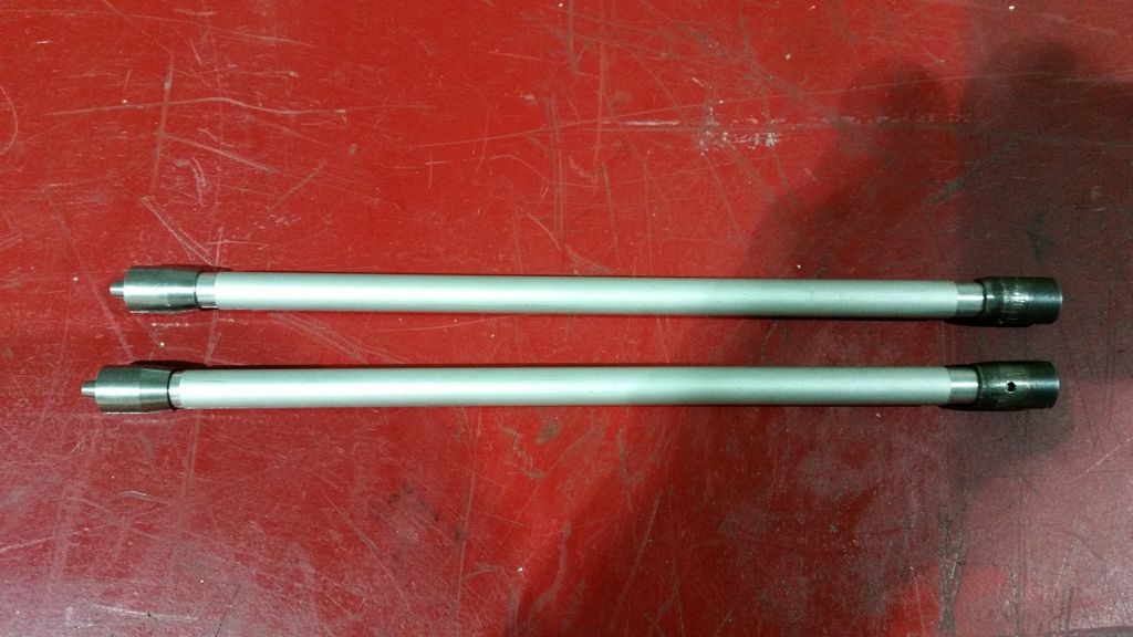

The pushrods are now finished and the head is on tappets set to 0.006"

I've just about had it up to here with the front forks!!
I have a set of Kommando's cartridge dampers, I bought a pair of A65 bottoms with the holes in the bottom to secure the dampers. After I got them back from the powder coaters I realised that theRH bottom had been badly bored at some point and had about 2mm of clearance between the slider and bushes, it was also like a ploughed field.
I saw another RH bottom on eBay so I hit buy it now, then I realised it was in USA and there was a stack of postage charge. Oh well it will be ok I thought, then another hefty charge for import duty F*!!k.
I tested the fit of the bushes and it felt ok so off to the powder coaters it went last week. This evening I decided to assemble the LH leg, the fork bottom must have been twatted hard at some point at it jams half way GRRRRRRRR

Re: B31 "clubman" [Re: Andy Higham] #681747
01/18/17 9:34 am
01/18/17 9:34 am
Posts: 9,147
Posts: 9,147
On the fork lower the first check is to see if its bent or a narrowing. Leave the top bush out and put the stanchion with the bottom bush into the lower and see if it reaches the bottom, if it does then the lower is bent, if it jams then it needs boring out in some way, I rum a 38mm reamer down Triumph lowers, need a 37.2mm reamer to do a BSA. There is possibly another route, I will post details later with pics.
