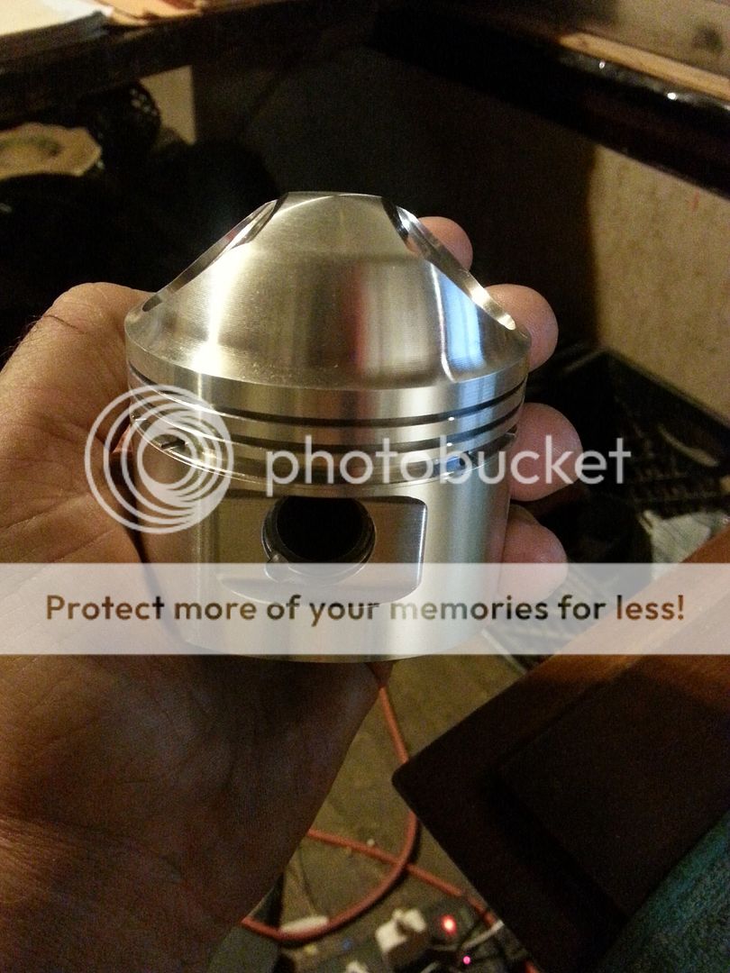

i'm running 11.75:1 JE pistons, but i'm not fast yet. the dome is really, really, high.
237 grams, i think they were.

Originally Posted By Allan Gill
Kevin, have you tried advancing/retarding the ignition timing yet? It will take more time for the flame to travel across a domed piston than a flatter crown.
I believe Kevin is using a dual plug head so flame travel is less of an issue....
There's many opinions on high domes and flame travel...
I ride dinosaurs that eat money
not yet, tony-- the current head is one plug per cylinder, which is why i haven't messed with the timing.
on my twin-plugged street bike, it's fastest with the spark retarded 8 degrees, to 30 BTDC. at 28, it's slower. more than 38, and it pings.
i plan to twin-plug the next head because i want to run much closer to the edge than i am with this one. the domes are way up there:
