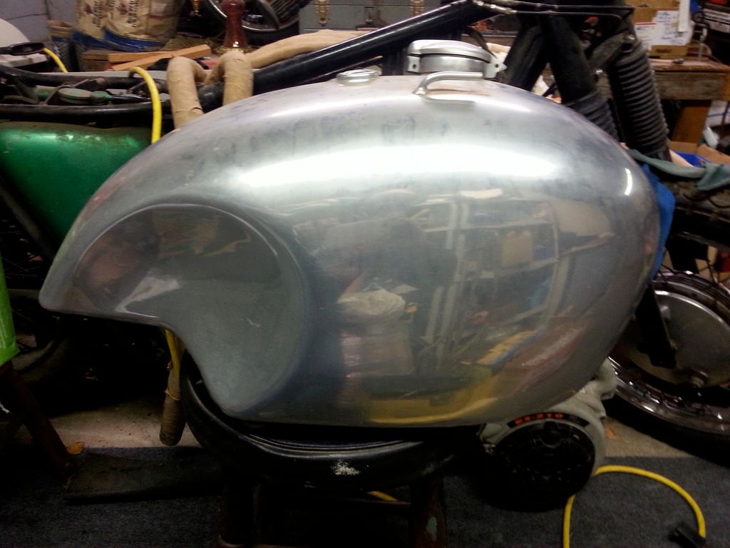

Possible to get a pic Jools?....straight on side pic and ideally one of the bottom if not a great inconvenience or if it is not currently on a bike.
Here is the side view of the second 'Lyta' - Tank #2 - is that more in keeping what you have?
Update: This tank was on eBay back in Nov....went to 1,271 pounds and didn't meet reserve! Lots of people seem to think it is genuine...

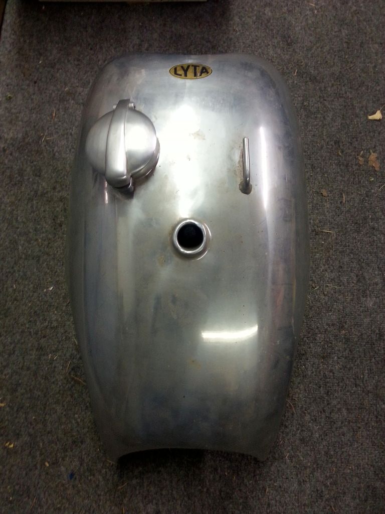

Hmmmm...here is another (we will call this Lyta 3):
Looks a bit different from both, more similar to #2 but knee cutouts appear larger and it appears taller and a bit more rounded...the plot thickens.
These are hand made so probably no two exactly alike and maybe changes to the pattern over time?...but how much variation is to be expected? Is one of these correct?
I for one would like to see one that came from the builders hands...

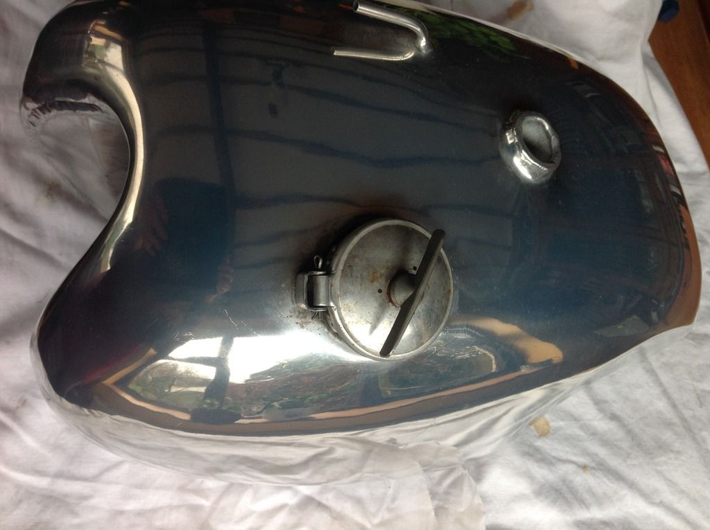

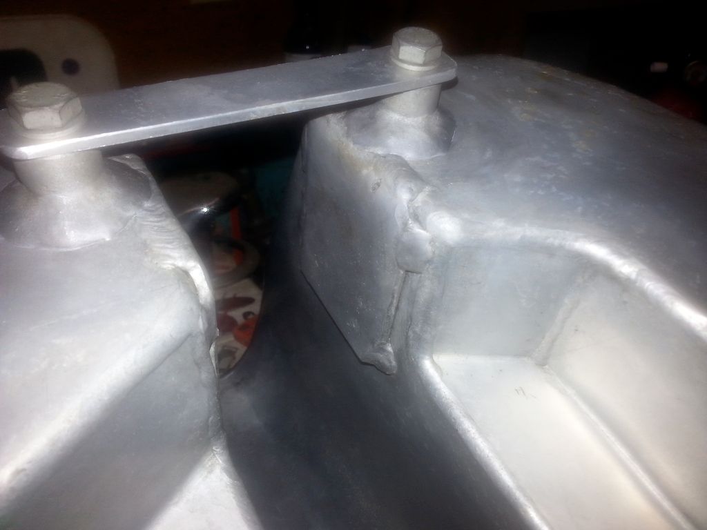

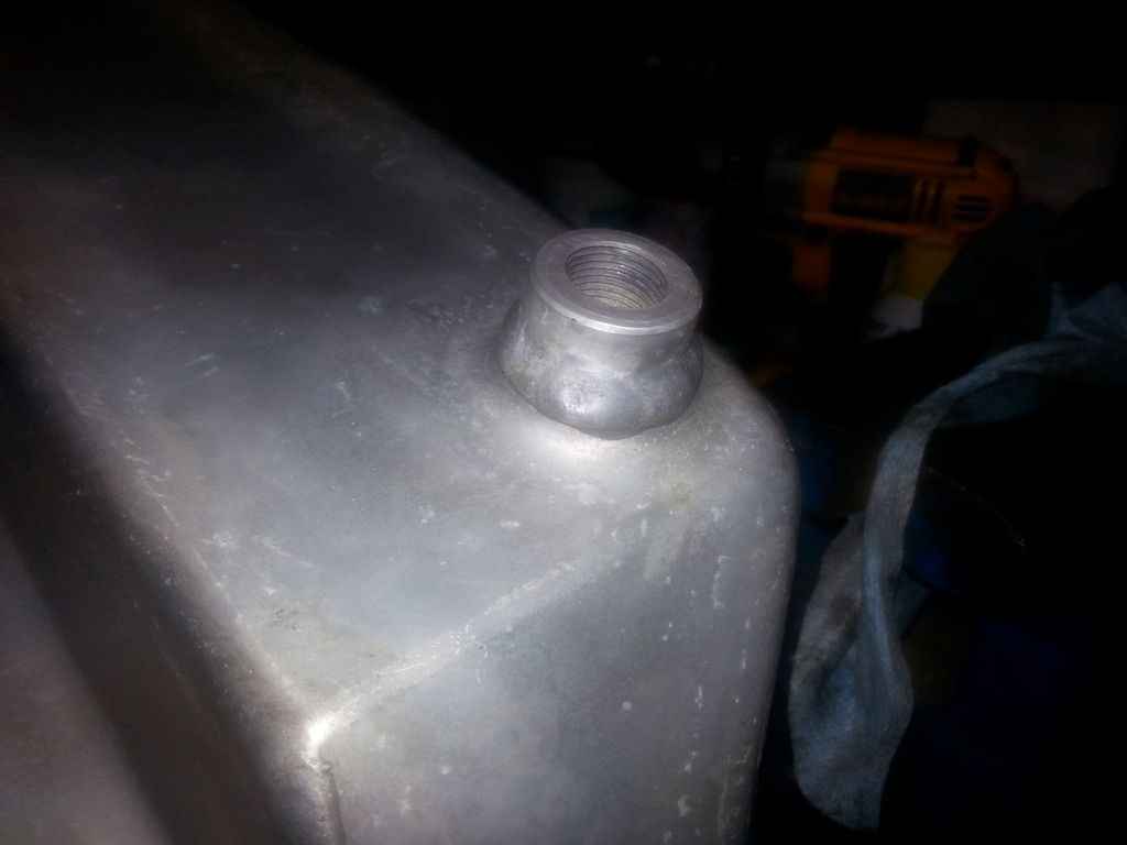

This came from the builders hands himself. A friend brought it back from the UK in the late '70's and hand carried it all the way. It is yet to be mounted on a machine or have fuel put in it but will be going on my '57 Clubman. Some of the details that indicated a Lyta tank were:
1) The fuel tap bosses were welded to flared out openings in the tank, not just welded straight to it.
There was a cutout, like Peter referred to for clearance of the throttle cable.
And there should be pads welded to the inside of the tunnel to snug the tank to the antisway rubber pads on the frame.
I also thought the big tanks all had the vents but maybe Peter's was requested to be left off.

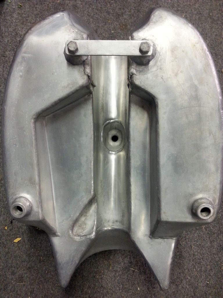

OK, so I took the tank off the bike and made some pics, as said, it has no vent tube, and I do not recall that this was requested or even discussed at the time.
I first laid eyes on a Lyta tank in the shop of Eddy Dow in Banbury around 1973,actually a Renault car dealer with the Goldstar department on the top floor, they had a Goldie on display with a Lyta tank and they supplied me withe the name and adress of the maker. Mind you, Goldies were just no more than old bikes in those days, and I wondered if the purchase of a Lyta tank was a wise investment, but I bit the bullet and ordered one. It arrived at my home a few weeks later.
I can't remember anymore how much I payed for the tank, but it was (at the time) quite a substantial sum.
The original Lyta sticker got damaged, and I removed the remains long ago. (stupid me)
I also made brass adapters to accomodate fuel taps with 1/4BSP thread.

Great! Many thanks Peter and Boomer for your pics. And the fact that they both can be traced back as original is awesome. From them we can see some must-haves to be a genuine Lyta:
- flared out at fuel tap bosses
- non symmetrical reservoirs on the bottom
- re-enforced at the front for rubber mounts
- cut-out for cable for GP carb cable (at least for GS single)
The shape of both of these is the same. Interesting that the first tank in the thread has all the above criteria but appears to be a different shape...was there a 4 gal Lyta? I suppose if you were getting a custom tank you could request a GS base and change the top portion?
Tank #2 on eBay uk does not meet the above criteria...hmmm.
