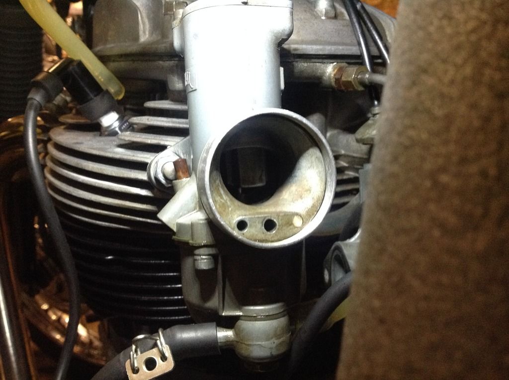

Strange how some bikes start without choke. Here is a pic of one carb with the choke on. Does this look about right or should it/can it be adjusted lower?
Also, I note my needle is set on position 2 (mid way between 1 and 3) whereas the book says 3. The bike runs well like this but wont start. Shall I revert back to position 3 or leave alone?
Answer to both these questions.
The choke slide should completely bottom out on the bottom of the carb, otherwise when the slide is closed the choke is. It low enough to function. Without stating the obvious, the choke is to choke off the air supply, if the slide is closed and the choke isn't visible below the cutaway of the slide it isn't choking anything. To have ultimate effect it has to seal off as much air as possible. Halfway up is not doing anything when the slide is down.
If your running standard setup as in silencers and filters then your best starting with stock jetting, that's slide numbers and main jets especially needle position. #3 being the lowest groove on the needle which raises it to be at its richest point.
I will add that those carbs are the originals, who knows what has happened to them in 50 years, the jets could be worn out hence the needle position change and the slides could have worn in the bores which would alter how the fuel is drawn through the carb through vacuum losses.
It might be wise to fit new AMAL Premiers which will certainly help and improve how the bike runs.
As for the none use of choke, winter in California might be lovely, but if a carb is dialled up correctly at the temperatures we're getting at the moment, you need choke. If you don't... then it's too rich when the bike is warm.

Looking into your carbs I see that the chokes are not full down. In cold weather, like it is now, you do need to make sure that they fully 'choke' in the down position to get a rich mixture needed for starting.
To repeat what has been said before, if an engine starts easily without the choke ON in cold weather then the carb is very probably set too rich (or the float bowl may be flooding).

Regarding the pilot circuits,as well as the jets there are two small holes in the floor of the carb bodies on head side of the slide seating zone,these must also be clear.
An alternative to fitting new carbs is to replace the slides, this will help minimise air leaks.
Personally I am not convinced the fuel circuit is the fault,if it starts and runs OK when hot then either you have compression issues or sparks are not good.
Use a meter set on ohms to check resistance across switch contacts,continuity of earth paths, set on volts check battery, check volts at switch and at coils, new batteries can be duds, check battery volts before and after starting. A spark at plug resting on head may not be strong enough to fire under compression.
