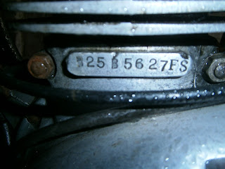

That is a B44 or a B25 (smaller 250 version of the B44) in a B44 frame. Would need a closer pick of the rocker box from the right hand side to say 250 or B44 engine. Either way well worth $100.
Seen 2nd pic, definitely a B44.

Engine number is just below the barrel on the crankcases, frame number is on the frame same side on the front engine mount casting.
I would say that is a 69 and was a Shooting Star, look under the engine and you should see mountings for center stand which the Victor Special did not have due to the sump plate and being off road based.

That is the only numbers I can find anywhere on the bike

Well its not an A65, you have to assume its a B44 doctored to fit an A65 title, if there are no other numbers then its past cannot be traced, selling it on will be an issue.
Eng number location
Frame number location

Well I don't see a center stand bracket and I still don't see an engine number anywhere on it!!

Edited the post above to add in photos of the stamp locations.
