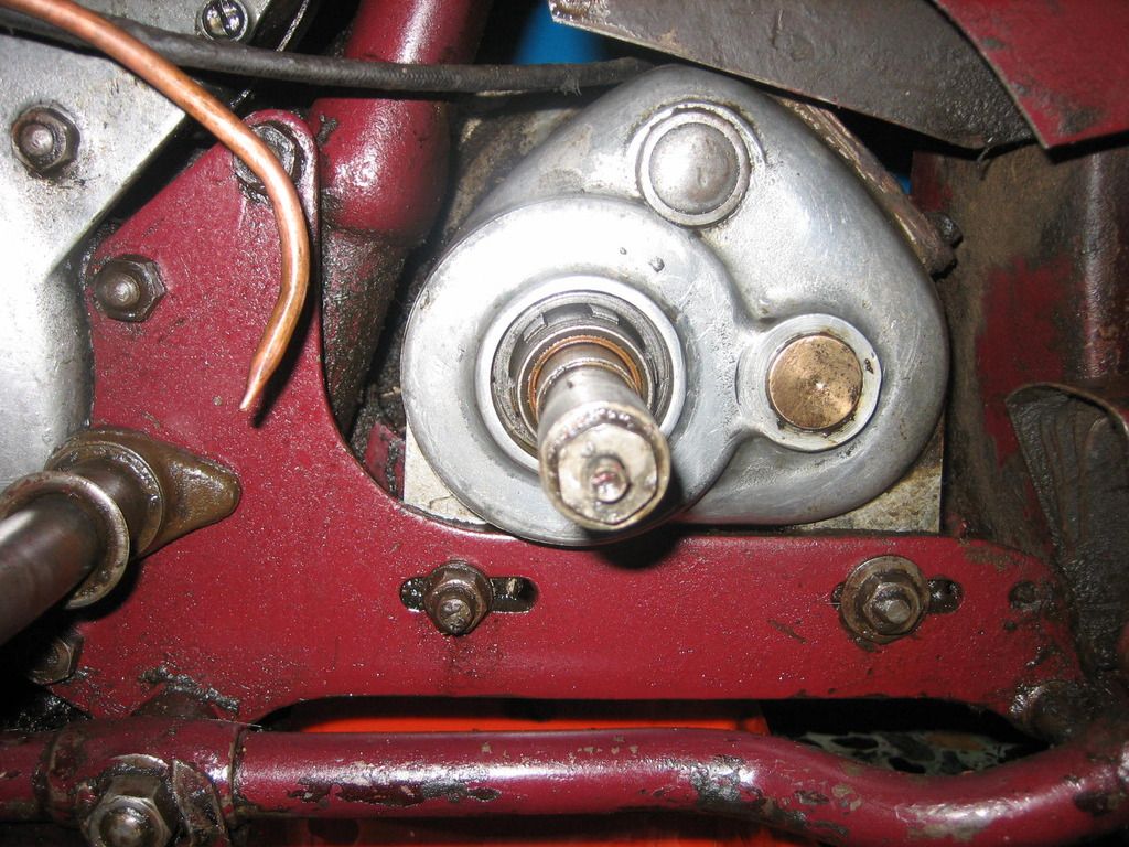

Hello there,
i own a BSA M20 1942 and i have an oil leak between gearbox final drive and chain sprocket.I removed the clutch and the sprocket and i didnt find any seal. Only saw a bronze pipe ring(sleeve).
Does anyone knows how can i stop the oil leak? Thank you very much in advance.

There is no seal here, replacing the main bearing with a sealed bearing will slow the leak but also check for excessive wear in the sleeve gear bush.

It might be just the angle of the photo but that gap between the sleeve gear bus & the main shaft looks huge.
The oil is retained by a spiral cut into the sprocket which directs the oil back into the gearbox.
For this to work a close fit between the sprocket & the hole in the gearbox is essential and I am yet to find one that is not decidley oval.
The copper tube you have pinched closed is the engine breather and unless you have the latter model breather in the timing cover this will cause the crankcase to vent through the primary as there is no oil seal on the crankshaft either.
The excess oil will pool in the primary and leak out usually around the clutch sliding plate.
The box was not oil tight in 1942 when it was new and the passage of 70 years will not have made it any better.
The militayr M20 crowd have a habit of fitting a sealed bearing on the top gear then a tiny AND I MEAN TINY amount of silicone on the very internal end of th spline to slow down oik wicking along the spline.
I use generous amounts of very high temperature bentonite grease on the spline.
This goes a long way to preventing oil escapling and water penetrating plus it keeps the splines in good nick as well.
When the box comes out you can then either machine it to take the B series oil seal and use late model sprockets or machine out the gearbox mouth and fit a bush to return it to the original clearances which from memory was around 0.002" to 0.005" but check the wear on both the bearings first.
THe bush will be thin so it has to be steel or you can get the box built up and machined back to original.

The gap between the sleeve and mainshaft is not too big, but more than normal .
The copper tube that you see on the picture may have excesive wear !!! and need to be replaced if can find this as sparepart.Can man replace that without dismantling the gearbox ? or put in place one special o-ring in front of copper tube using also high viscosity gearoil ?
Thanks a lot for your help.I have to find the proper solution and all the spareparts .

Originally this bearing was an open bearing fitted with a large shim and seal in the casing. It leaked when new. The trick is to replace the original open bearing with a sealed version. These are easy to source - from memory a 6207 RS or RS2. BTW It would be best to run straight 50 weight oil in the gearbox - that's what is meant to be in there. Unfortunately, this means removing the gearbox from the bike (not a big deal). check out the instructions in the technical section of the WM20 website - http://www.wdbsa.nl/technical_section.htm
The crankcase vent should run further back so excess oil is directed onto the chain. They are not expensive - https://www.draganfly.co.uk/index.php/accessories-a-misc/product/13342-
