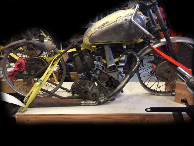

120 hours, hah! The photograph shows how far I got in 90 minutes and, as anyone can plainly see, it's essentially done...
Trevor, don't look too closely, as I did this today mostly as a proof-of-principle for myself. Rather than, say, trying to rummage through 50 lbs. of fork internals at the back of a shelf I grabbed what was easiest. The same for the oil tank and mudguards (and fuel tank). In all cases there are plenty more where they came from, including the front half of the hinged rear mudguard. Also, in doing this I discovered one of the two barrels I have is for a 500.
Interestingly, there was a plunger ZB34 on eBay until earlier today that was less complete than this one already is. With over a day to go before it was supposed to end it was already over $1500.

Nearly there, I spat my dram out when I saw the pic. Nice one.
Nuts and bolts ?

90 minutes--nice one MMan!
But the old saying is that the devil is in the detail---like small brackets, fasteners etc.
IMHO that will take you exactly 18 1/2 hours giving a total of 20 hours!

Originally Posted By Magnetoman
Originally Posted By GrandPaul
120 hours.
Just needs finishing...

As the earlier photograph shows, right now it looks like the remains of an exploded airliner the FAA has pieced back together. Floor space is at a premium so it sits on a rolling stand that is very easy to pull into the working area when adding parts, and shove back out of the way when I'm working on something else, leaving the floor space free.

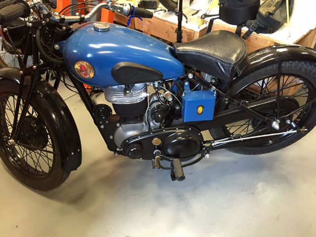

For me to find 20 hours to assemble this puzzle over the next few months is one thing, but it would need at least 10-20x that long to then restore it to good condition. Because I have other projects and time commitments, once it is assembled it will sit complete, but unrestored for the foreseeable future.
Although I have no intention of selling it, a few recent eBay listings have made me curious what such a bike is worth. When I'm done it will be more complete, and in no worse condition, than this bike that reached $1500 before the auction was terminated a day early.
Or this one that sold for $2800 in July.
So, what are your guesses/estimates of what this M20, B33, B34 hybrid bike in complete form would sell for on eBay?
