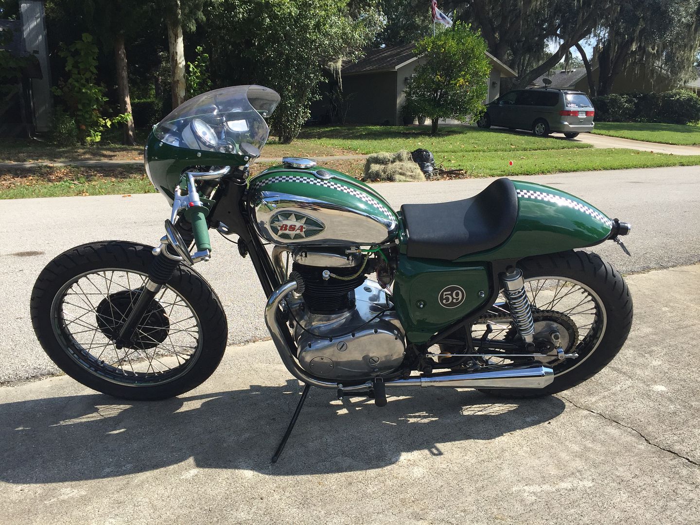

but the 66 café is done some purists may not like it but had to be done to save a classic

I don't know if I'm a purist or not, but I like it!

That is a great looking motorcycle. Nice work.

Good Lord, is that the shifter on the wrong side?
good eye

And hasn't it been neatly done ! Clever thinking.

Nice. Details on the shifter and brake lever swap ?

And not meaning to be picky, but if you have decided to run without a front guard then consider fiting some sort of brace to the mudguard mounts.
It is a nice looking bike and you would not want to wreck the paint job by tossing it down the road cause it get the wobbles under breaking.

After a ride or two in the rain, the front fender idea will look better and better!

looks fantastic, but ace bars and stock footrests, ouch! Maybe you have long arms and wee legs.
interesting exhaust pipes , what are they?, they dont have the usual big swoop.

thankyou for the comments yes I'm sure the fender idea would be a good idea but I like the look without
as for the front braces to you mean from one fender bracket to the other over the wheel ?
yes the gear and brakes have been swapped I did that 1 to see if it could be done and 2 I have a few other bikes and I just didn't want to make the mistake of hitting the wrong lever even once
the pipes came with the bike not sure if there specials but I like them
I will post some pics re the lever swap soon

Yes
The top of the sliders need to be joined together or they can "walk" particularly under braking.
A very slight difference in the angles of the legs as they compress will twist the front wheel and makes handleing well, interesting !!!
You have done a top notch job on the paintwork so you don't want to toss it down the road.
I had to ride for just a few days without a front fender, after tracking down the cause of serious front fork stiction to a badly-made bracket. frown Even though I never rode in the rain during those few days, I was surprised at the amount of crap stuck to the front of the bike in a direct line with the naked front tyre! eek If you fit a brace between the sliders, a well-chosen small fender attached to it shouldn't detract from the "look" but will keep an awful lot off the front of the bike.

ok points taken looking into it all thanks
