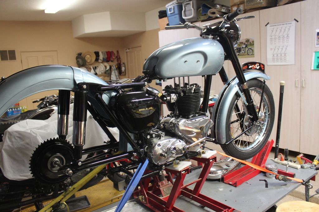

A big thanks to the Hawaiian Tiger and Irish Swede (and others) that have helped in the past answer my questions. Itís a little difficult restoring one of these 50ís bikes properly without a local reference. The project is starting to come together, still working through proper alignment of the sheet metal prior to painting.

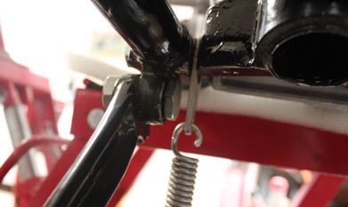

I have several more questions: 1) on the center stand spring that is attached to the lower frame, it is what appears to be on a swivel bracket, 82-3618. Is this bracket in the correct location on the frame and should it move freely, (mine does).

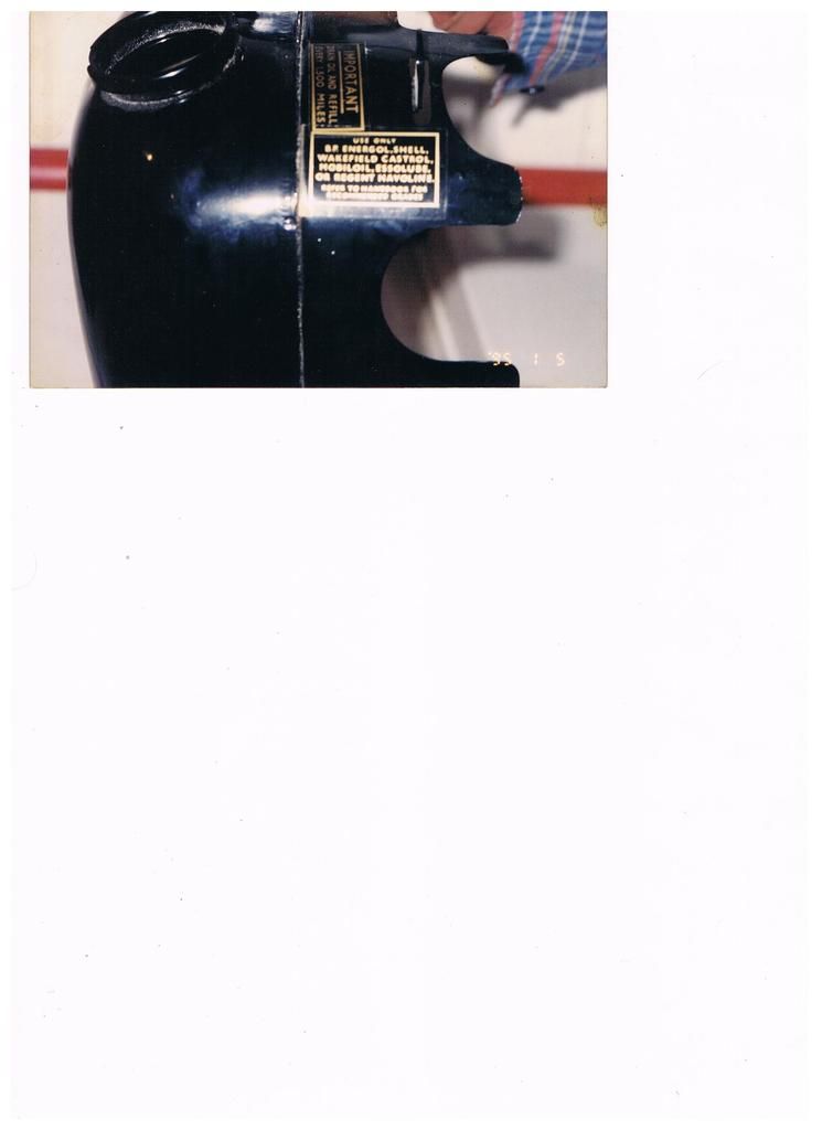

2) Trying to get the decals sorted out, on the top of the oil tank, there are two decals. In an earlier post you mentioned that one in the picture was not correct, so I would like to verify if these are the correct ones.

Your center stand link looks correct. They are meant to swivel.

Found the pic.
Restorers tend to do a more tidy job than the factory did. This is a duplex frame oil tank so the transfer may be different for yours.

"Swede" here. YES, that's where the decals are supposed to be placed.
Bill is correct: The factory got the decals on the tanks in the right area, but not always perfectly "straight."

The restoration is coming along and taking shape.

Looks stunning. Great work.
