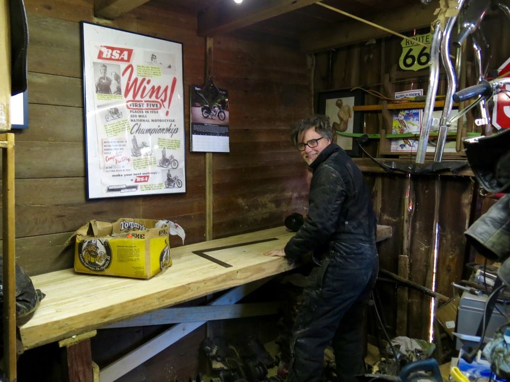

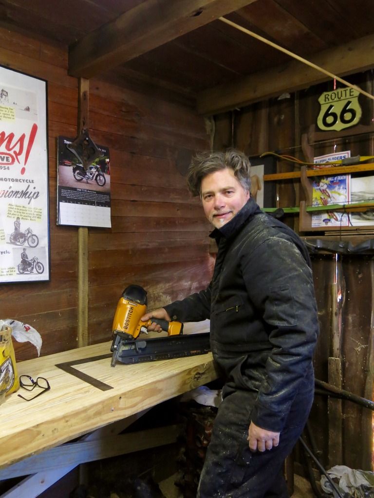

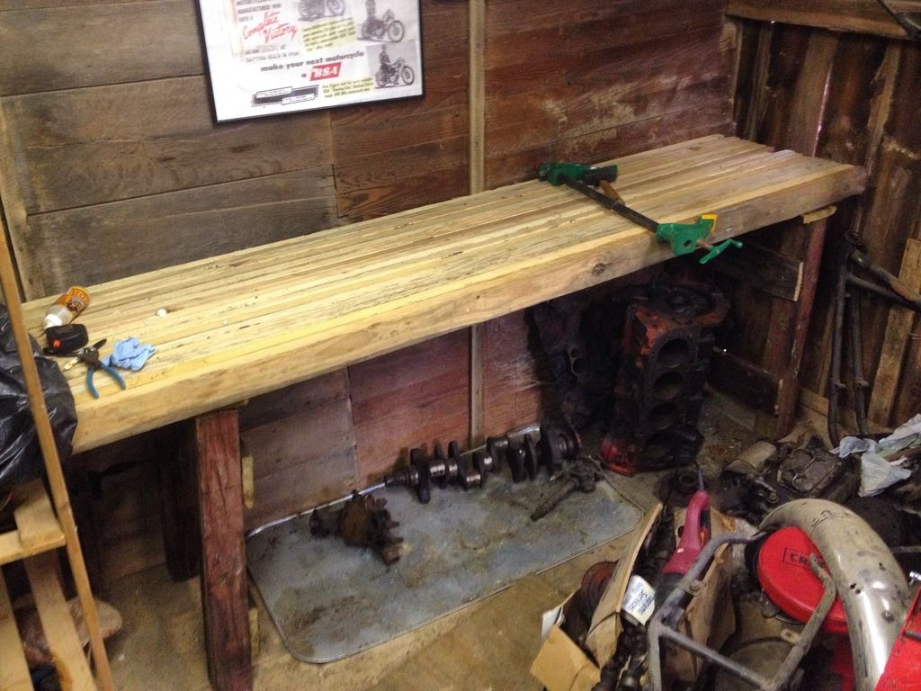

Or not !!! shocked
But I did build it on Easter.
Then last sunday I planed it down . Couple hour to build and totally free . Almost free wink
It may not be pretty but it was free to build. Not counting nails and glue of course.
Heavy Duty is an understatement I could barely lift it to plane down the bottom side of the 2 x4s . I only did the underside cause I am thinking about attaching some drawers that I have laying around. Wooden drawers that came from the old kitchen. Any good simple ideas for that plan?
The lumber was free from my brother who unloads trucks at a warehouse that he manages. He managed to save the 2x4 s for me out of the trucks. smile
The 4x4 legs are from a pile of them that came with the farmhouse.
I planed the top down so it was even. It will probably be a splinter maker. Would I stop that with a shellac or something?

Find a local metal fab shop and have them cut you a sheet of 16g steel. Make it 1 1/2" wider then the top and and have them put a brake of that dimension to cover the front edge. Drill countersunk holes for bugle head wood screws to hold it in place.

I would put a few coats of polyurethane on it. Gotta be harder than shellac.
Go to the local dump/auto junk yard. I bet you could find a piece of 24" X 18" or 24" X 24" piece of steel to attach to one end of the bench.
Attach a nice big vise with some lag screws or carriage bolts. bigt

Full sheet of stainless is what you need.
Brake for the front and the backsplash on the rear.

I'd polyurethane the top. Then buy a 18 x 24" aluminum baker's tray. Work on your engines and trannys while sitting in the tray. That will protect the surface AND catch all the spilled oil. And be cheaper.

Any kind of plywood or melamine coated particle board is also a good way to top the bench. Remember if you coat the top of it, you should also coat all other surfaces to prevent warping.
For the drawers, you could make "L" shapes from 3/4 or 1/2" plywood (verticals) and cleats & 1X2 or anything (horizontals). Space em about 3/8" wider than the drawers. Make your verts about 1" deeper than the drawers and use more strips of anything to act as supports/slides.

The guy I bought my house from left a workbench made out of 2 X 4s, but with gaps between the planks. I got tired of fishing screws and bolts out of the gaps, so I bought a sheet of thin plywood, and screwed it to the bench top.
Now, if the new top gets badly oil-soaked or beat up, I can just repeat the process with a new sheet of plywood and start over.
I thought about a steel top, but decided "easy to clean, but TOO SLIPPERY."
