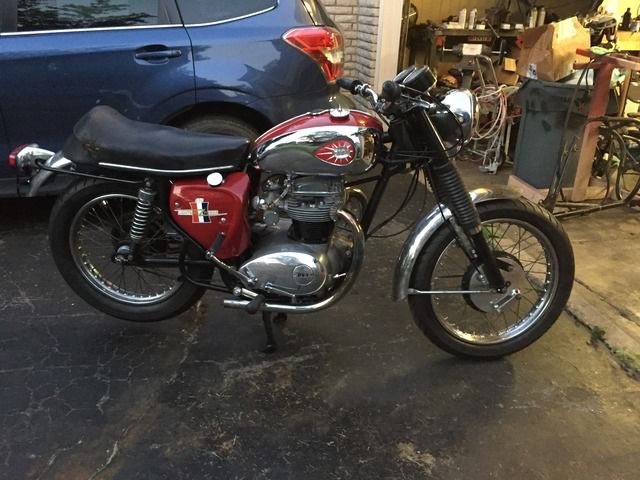

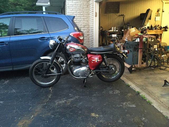

After 3 years and a little less than a week exactly, I'm finally ready to ride. Correction, went on my first full lap of the neighborhood!!!!!!!! I'm so excited I almost went on to the main road, decided a ticket for no plate/insurance wasn't worth it though. It revs so nicely, I only got into second gear but it felt good and smooth and starts on the first or second kick thanks to the Pazon ignition.
I need to set the idle up, and balance the carbs but the baby was sleeping so I couldn't rev it in the garage. Will also need to check the timing.
Only real thing that felt weird was the forks. They don't really rebound very well for being rebuilt, I'm pretty sure I did it right too. There is also a lot of brake dive which is no fun. Any thoughts or things to look at?
I am going to keep and eye out for new fenders with good chrome, correct shocks, order up some knock off mufflers but haven't decided on pea shooters or dunstall style (input welcome.) Also need the lightning decal for the tank, and I don't like the decals on the side covers either so I'll probably order more correct ones.
Heres some photos pre and post ride-
I'd like to thank everyone for all their help in this process, I'm sure I've asked some dumb or annoying questions so thanks for dealing with me and helping me along the way!!
