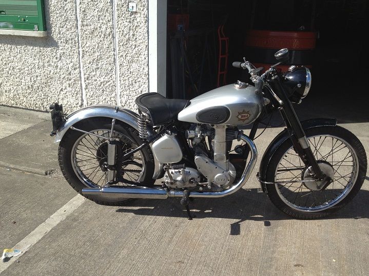

I would go with the Concentric.
The seller of my rolling chassis had supplied a Concentric in it's box from 1990 or so. New and selected for my machine, but in it's box, never fitted for 25 years.
Without exaggeration- the bike started and ran perfectly after 3 kicks- I did not even adjust the tick-over ( which it does) and have used it for the past 3 years without fault (touch wood)
Sort of looks the part as it has a stack on the back
Can't fault it
