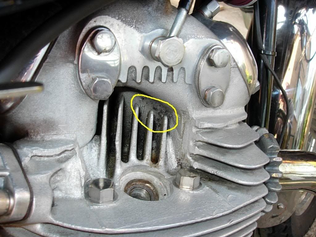

Wish mine was that simple...... Oil is indeed working through the inner fins & out the front - problem is where it's coming from!
Yellow arrow points to a little puddle of oil between the first & second inner fins. You might expect this to be coming from the oil feed banjo, exhaust rocker cover or spindle gasket, but these (and all other gasket joints) are dry. Rear wall of the exhaust rocker box is wet behind the inner fins (see photo 2) and I can't see where it can be coming from other than through the casting itself. This is certainly not a big leak (yet...) but I've put a lot of effort into getting the bike oil-tight, so this is a real bummer. Any suggestions for a fix gratefully received. (Head is an RH10, btw)

Mitchp,,Yes I see the problem . I was under the impression the porous head was rare, but possibly, no one really new they had one, and chalked it up to leaky gaskets.
FWIW very minor stain. Looks like you take care of it. You can clean it up with a little degreaser when you wash it.
