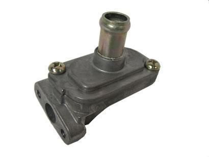

Hi All,
Has any body experimented with one of these on a big twin?
https://www.mikesxs.net/parts/yamaha-xs650-reed-type-engine-breather-valve-pcv
Yam seem to think it worth while.

Very common on Commandos, works very well as the reed valve stays responsive at higher revs which is the problem with non return valves with ball bearings etc. To get one cheaper and in different configuration put EGR valve into eBay, used on modern small bike engines for emission improvement. I go for the 180 degree ones as its easier to fit.

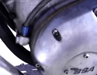

I have one on my A65. The breathing is modified to work like a later Triumph twin. I mounted the valve in the front of the air box (OIF.) It works well.

From the front of the primary case.
Most of these which I've seen exit from the top of the case, but this is where PO put it.
Works a lot better since I removed the crank seal. grin

I've had a look on eBay but can only find the actual reeds, not the whole valve. Have you a particular bike and model to recommend.

Have 2 of these 180 degree ones
http://www.eBay.co.uk/itm/YAMAHA-YZF-R-125-R125-2008-2014-EGR-EXHAUST-AIR-VALVE-/171540935709?hash=item27f0a2f41dgFZUAAOSwuMFUZH8T

The reeds work much, much better than the older spring loaded plunger type. Several cars use the same reed design in their PCV valves, which can be had in black plastic at Walmart in the $5 range.
