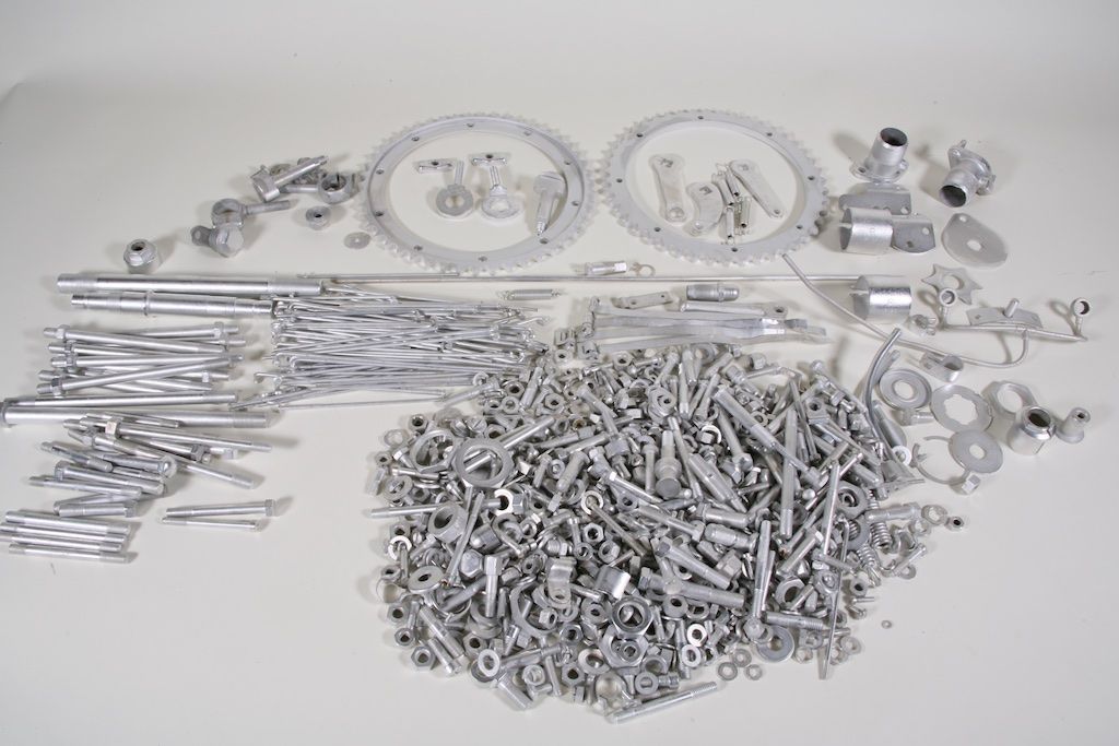

Hot off the truck (well cold actually, Minnesota, it's winter...), my freshly cadmium plated hardware! I can start going clockwise on Friday. The final parts are trickling in and when I get a window of time, this bike will come together rather quickly.
Ray, I bought quality Japanese Nachi wheel bearings so I should be good to go.
It would be interesting to know how they plate all these tiny bits without there being "bare spots" where they are touching each other at some point .... ?
Are they all completely plated when you get them back or are there little "contact points"? I've never had anything cad-plated ....

Lannis, I believe they "barrel plate" hardware. It is loading in to an enclosed barrel and rotating while in the plating solution. The tumbling action ensures all surfaces are plated equally. I did not have any areas that were not plated, but this time there were some spots from the solution which wiped off. Normally everything comes back shiny and clean.

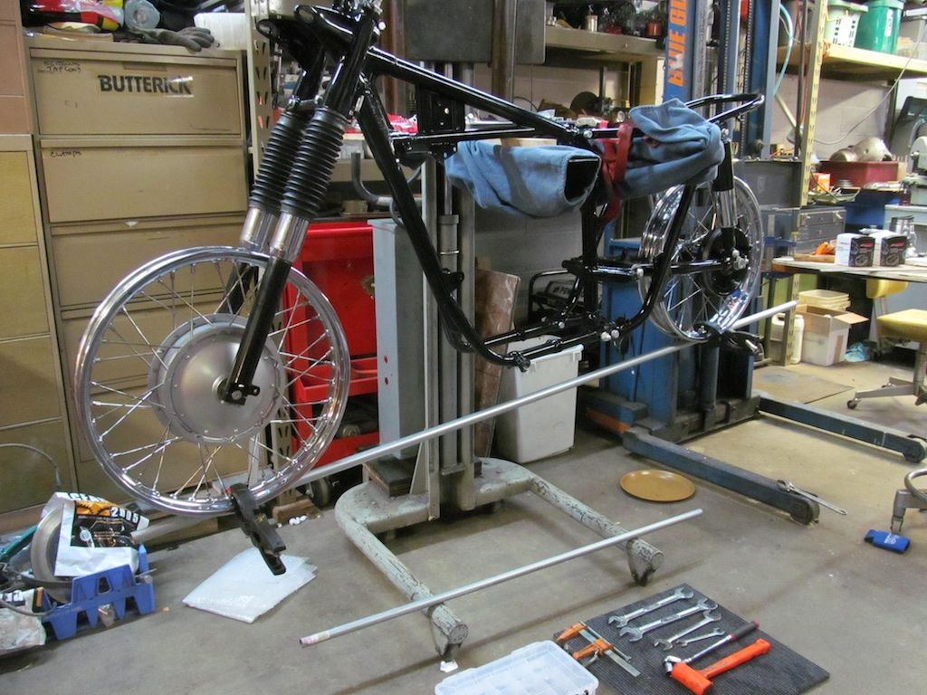

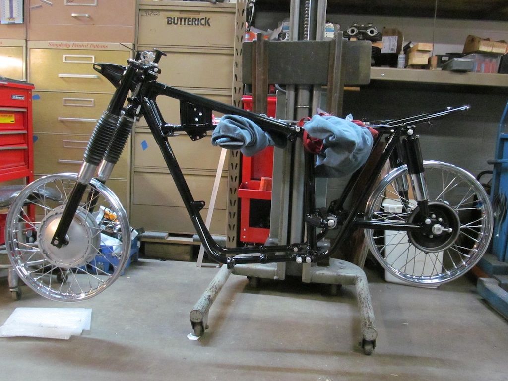

3 steps forward, two steps back… After two days in the shop I have the wheels laced and trued and am doing the final alignment of the center of the rims. It is is a long, slow and tedious process to get the center of the rims perfectly offset and aligned to one another, but worth the effort. I trued both rims to .004" radial and axial runout. The front fork seals and fork sliders took a couple of hours to clean and chase the threads because there was old paint, thread sealer?, teflon? crud and the seal holders would not go on easily until perfectly clean. I should be able to mount the tires, rebuild front and rear brake drums, and have a rolling chassis by Friday. Skip bored and honed my freshly painted cylinder barrel and I can start on the motor next week. The days are getting longer and looking forward to the first ride this spring. Onwards...

I thought this picture look familiar, then I remembered the Goldie looking similar at this stage.
It certainly appears that you tackle a restoration as if you were following an order. That's nice and it could be why your restorations always look really good!
Mine work off. Rolling budget usually, ( unless I am fortunate to buy everything outright first, like when I did my 400/4) so when I get a part or component, mudguard/engine/ etc I will fit it providing I don't have to remove it again

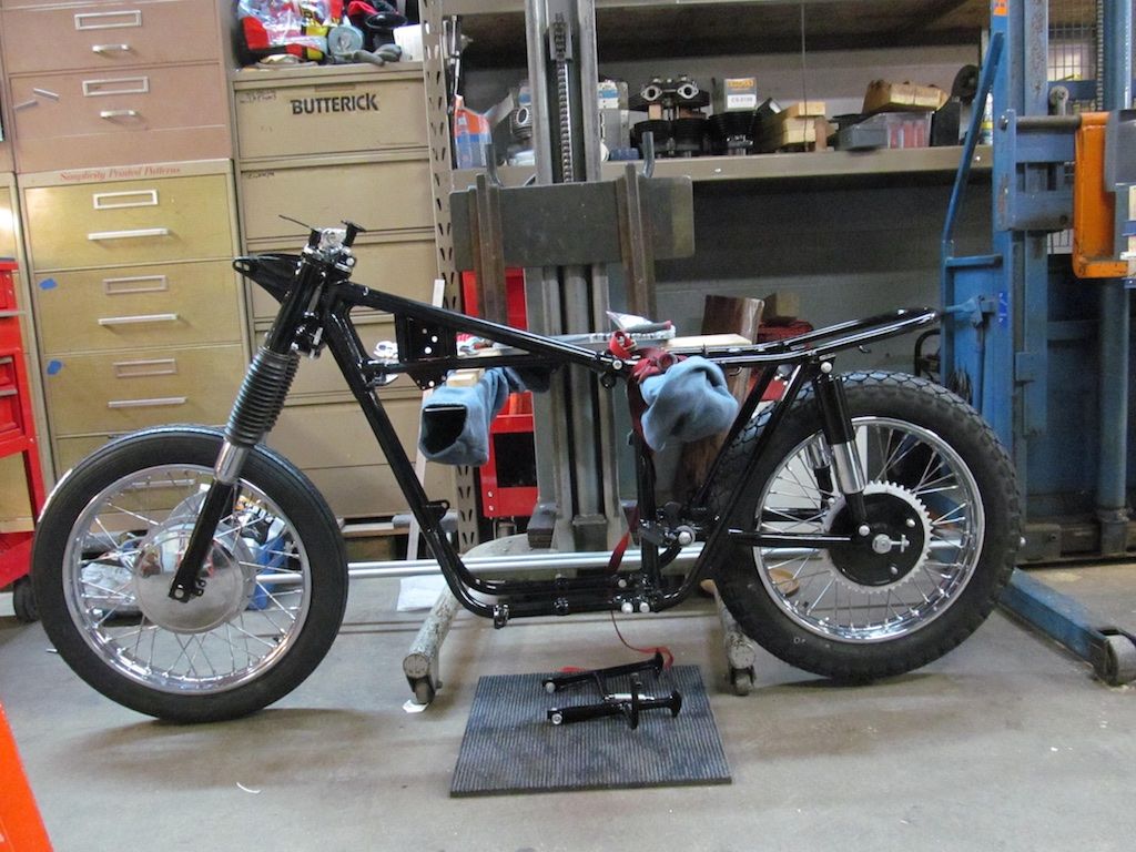

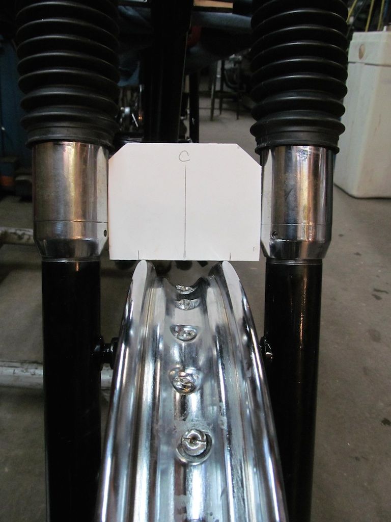

Thanks Allan and TR6. This bike is starting to come together. Allan I have done 5 CB400F's.
They grow up so quickly… I had a productive evening in Skip’s shop last night and finished aligning the rim centers, mounted new tubes and tires, assembled the brake hubs and now have a roller! Skip finished a perfect hone on my cylinder and the ring gaps were dead on. I have a little bit of time this evening to mount the centre stand, bars, brake stay, fender stays, and more. More good news, AMAL/Burlen emailed me this morning to say the Monobloc carb set I need was back in stock so I ordered them. The carbs the final piece in the puzzle so the bike should come together fairly quickly (when I can eek out some free time).
Rubber meets the road, err, the shop floor

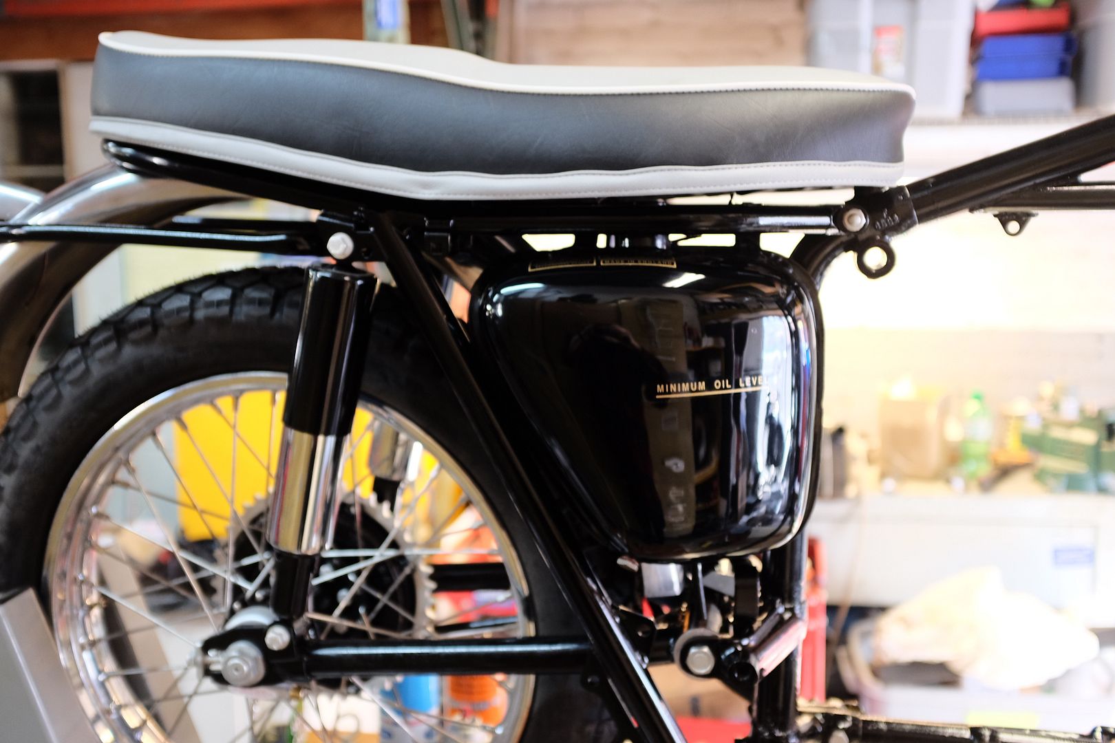

With very little free time this week. I managed to place the decals, clear coat, sand, polish and wax the oil tank. It looks much better than when I started:

I dig the wheel alignment method.

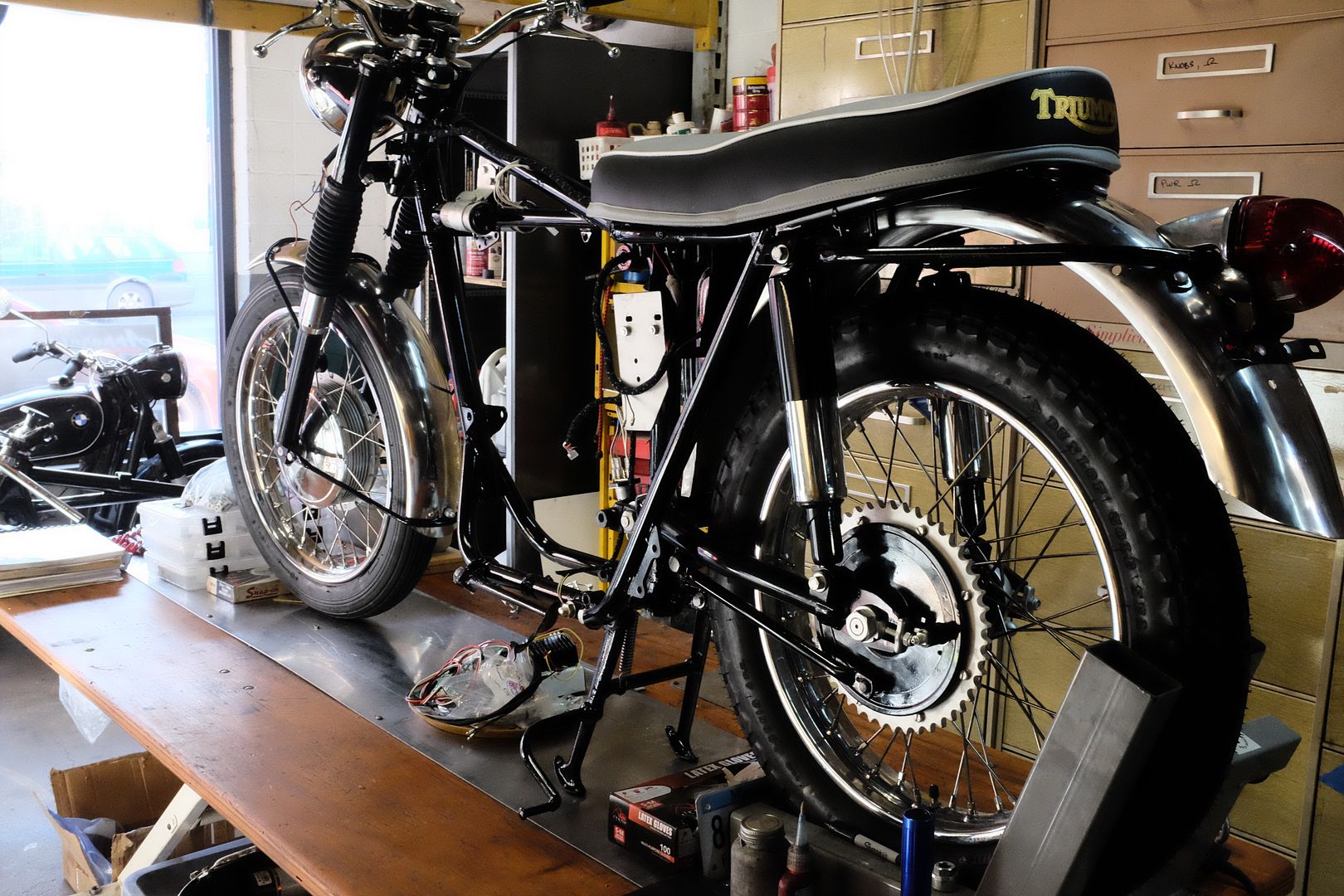

Thanks all! A quick update, I have made intermittent progress in the last 2 weeks. Although it does not look like much, it took many hours. The fenders were repaired in the English wheel, sanded, polished, and mounted. The tail light and seat were installed and I started on the oil tank I bought off E-bay only to realize it did not have mounted tags as my original chrome oil tank has, so I fabricated two tabs and had Skip weld them. I cleaned the interior of oil tank a few more times, fogged it with oil and then mounted it. We also welded up the crack on the side cover and I will finish prepping and painting it this week.
I started on the wiring yesterday and finished all the wiring, soldering new bullet ends, etc in the headlamp assembly. I still need to research and decide how I want to wire a kill switch. There is a lot of confusion on the kill button for this bike and I am not sure which to use.
I should be able to finish the wiring, mount the new Podtronics regulator and Boyer ignition this week and then hound Skip to finish cutting my new valve seats so I can build the motor. Spring is here and I should be able to get out on the Gold Star for the first ride of the year! Soon I will be riding this bike too.

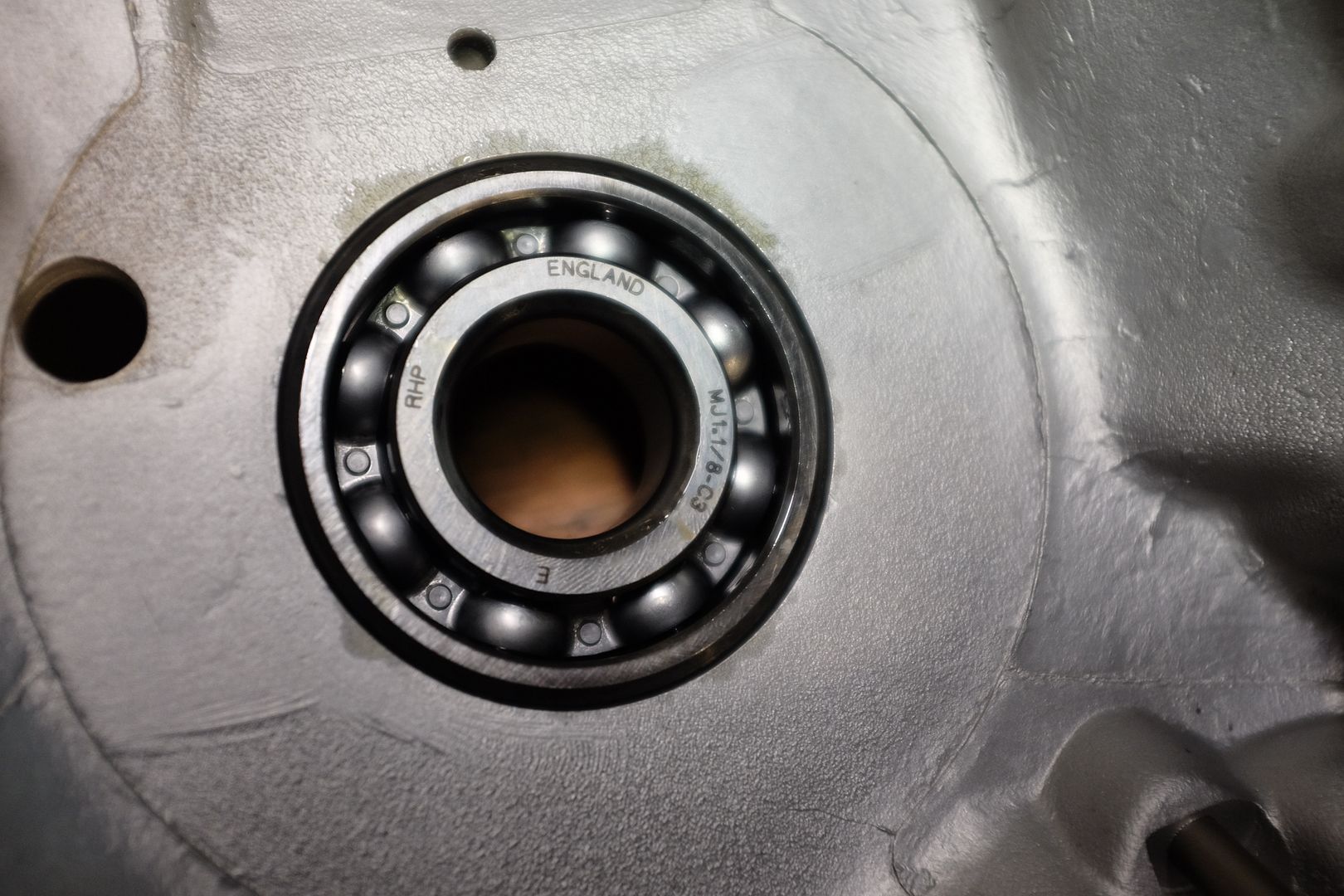

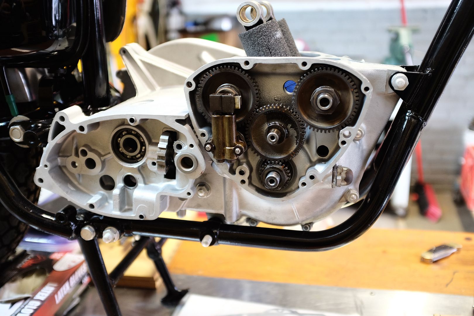

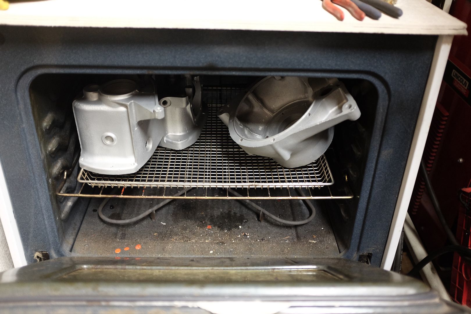

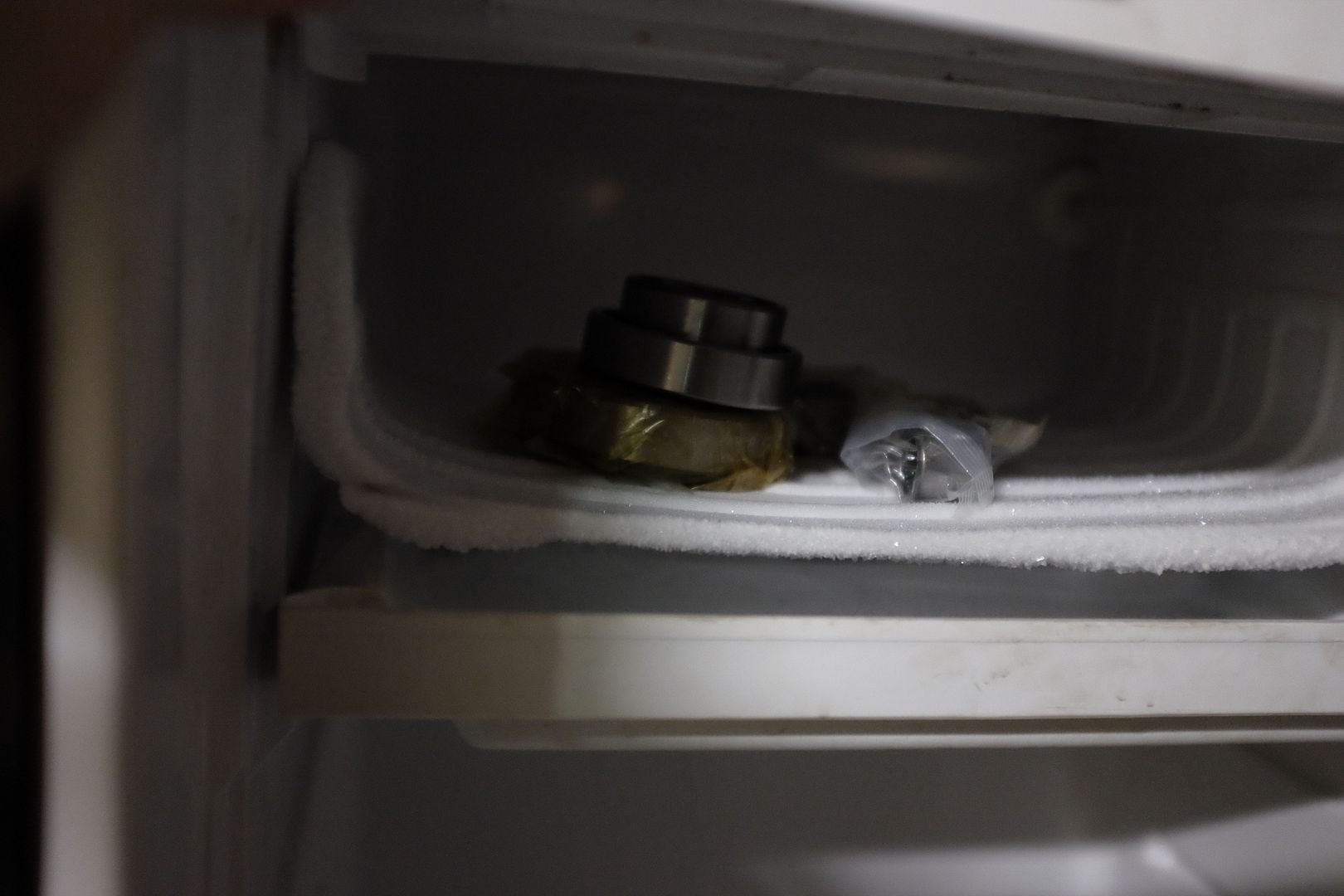

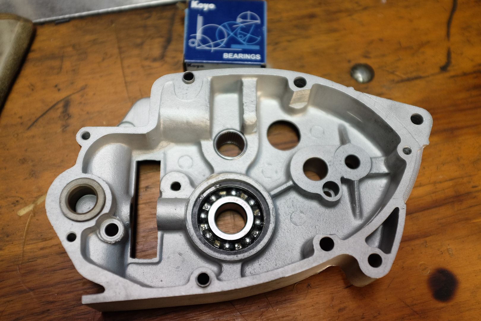

I eeked out a few hours of free time this week and continued to go clockwise.
[/URL]
Heated in the shop oven
Bearings in the freezer
Here we go…

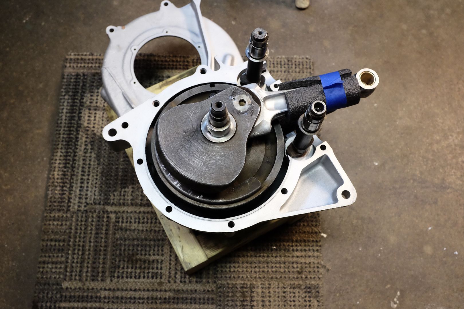

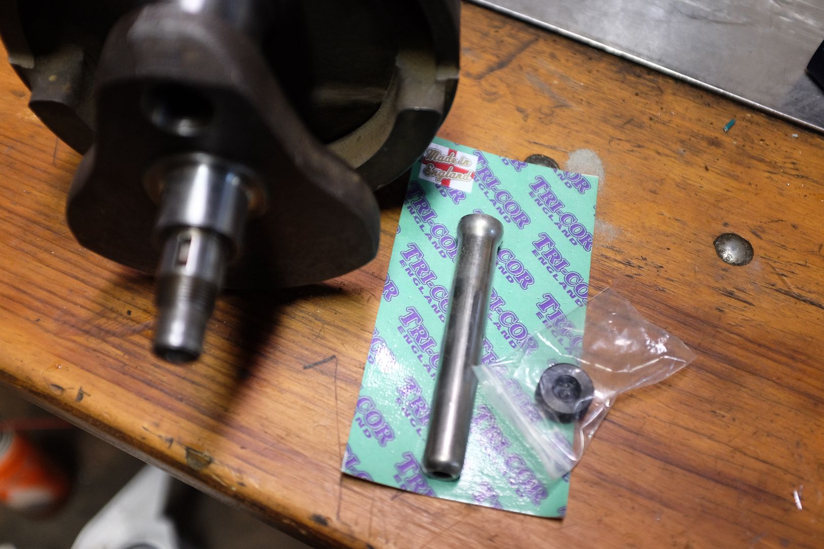

Clean and reground crankshaft, new sludge trap and cap

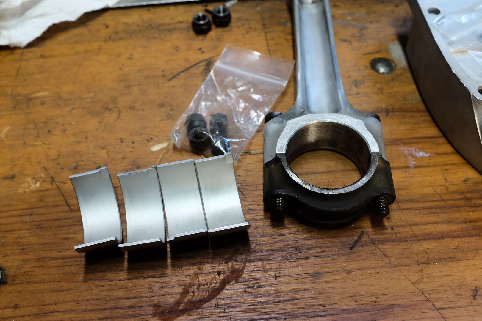

Machined con rods, new small bushes, new shell bearings, and con rod nuts.
The lower end is in the frame, timing side is done, and I’ll try to find the time to install the gearbox, primary components, pistons and barrel this week. Skip will machine my head’s valve seats this week too, so the motor can be finished soon. Onwards…

Regarding the kill switch. You can use a short to earth method by attaching a wire to the yellow and black trigger wire, run it to the handlebars and push to earth Button.
It's good because your not building up extra resistance in the feed side of the circuit and it doesn't harm the Boyer or overload anything.
