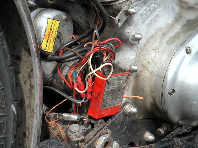

Some years ago I was riding a friend's A10 in Ireland to diagnose an intermittent fault with his magneto-replacement ignition system (the twisty mountain road from Glengarriff to Kenmare, for those who know it). The ignition abruptly cut out as I was passing a truck. Had I not been riding with this possibility in mind it easily could have come at a time that left me as someone's hood ornament.
In the case of the A10 the issue was with the "black box" control unit, but it just as easily could have been a wire that came loose from a connector. The consequences of bad wiring can be much more serious than having a dim headlamp. The photograph is of the connectors that someone is relying on not to fail while riding his Vincent:
If your wiring looks anything like the above, my answer to your question #3 is a definite 'no'.

I would not have considered riding anyone's bike with wiring like this and a Boyer-Bransden MicroDigital e.i. John H will doubtless give me a hard time for posting it but, in my personal first-hand experience, the MD e.i. is particularly intolerant of anything but perfect wiring and connections. Fwiw, first I would've rewired it, then taken it for a test run to see if I'd solved the problem.
I see now my post might have been misread. The problematic magneto-replacer in Ireland was on an A10. The Vincent also was in Ireland but had nothing to do with the A10 I was riding. That turned out to be a design flaw that caused the electronics to abruptly cut out if the battery voltage dropped below some value that was at the borderline of where 6V batteries operated.
The Vincent's wiring was just too photogenic to pass by without capturing. It illustrates that someone who rides a bike worth ~$100k (it was at a Rally, so it was ridden) doesn't necessarily know how to wire a motorcycle. Hence why some people might see a need for a thread on the topic, even though some angels object.
