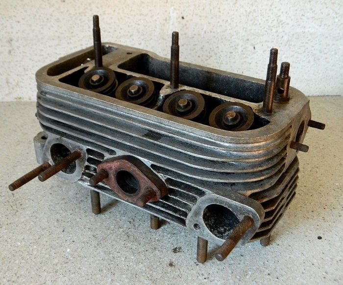

I had purchased all new parts to recondition the Sunbeams cylinder head quite some time ago but had had some concerns about the sealing face for the head gasket, old mate from its past had been there and there were signs of some heavy handedness in the form of some gouges etc.
The thought had been to fly cut the surface but it would be a large cut perhaps 1mm (0.040") as a minimum.
A welding repair perhaps another option with a light fly cut, anyway I had started by boring the old valve guides so they could be removed with little to no impact on the head itself.
As it turns out a cylinder head came up on UK eBay, auction ending this week and looking to be in fine fettle, oddly only one other bidder so was lucky to get it for a little over $200 + post.It should be here by the time I return home in a few weeks.
eBay auction pictures.
The pictures have been resized but were large and the casting including the all important gasket surface looks to be good.

The cylinder head from the UK had arrived and did make time to strip it and put it in the kerosene bath to soak (for a month)
The number stamped on it would place it in the 1951 year and seems to be in excellent condition for its age with no damage, all threads look good and even the iron guides have very little wear.
