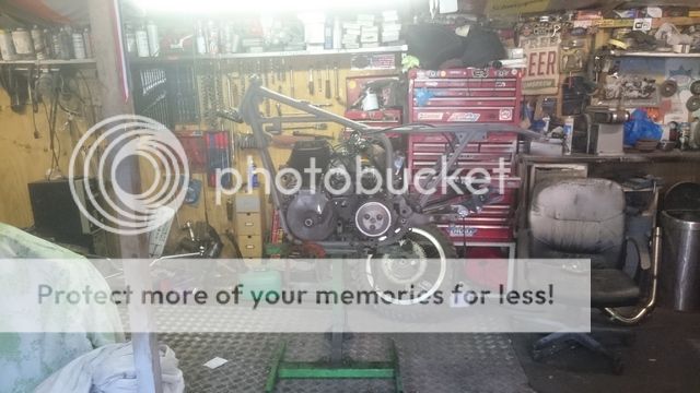

Not been on for a while ...merry xmas to you all
put this on another forum,but didnt go down to well ,i wonder why??
Plans are to build and enter into the dirtquake 2016 ,just a bit of fun really nothing serious ,a collection of about 10 different type of bike parts plus any bits ive got that can be cut,bent and made to fit ,its not my intention to win any beauty contests ,just a strong bike that can ride over buildings and plough the odd field now and again,oh its going to be road legalish
Be good for you gurus to look over where i am with this and offer your advice on when i go wrong
To give you a idea
1941 war department Norton 16h engine ,later Norton laydown dommie 4 speed box ,bsa clutch ,going in a 1958 ariel capr hunter swing arm frame using a a10 swing arm

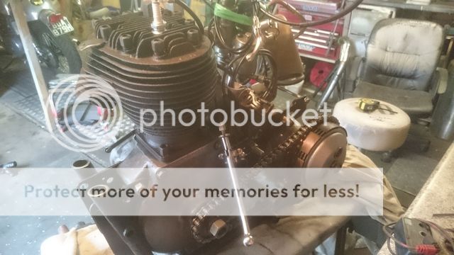

great to get a responce guys ,i know its a odd one and not to everyones taste
kevin, dirtquake england is all good fun just a crazy race on crazy bikes ridden by fools like me ,i will post the entry rules later
boomer, now that jap engine is a true stump puller , i would love to do something with that ,always wanted one but not been lucky enough to find one as yet
Well it would be great to say that it was a amazing engineering feat to put the Norton engine in the Ariel frame, but it wasnít, it just sort of fell in, 16h engine plates only needed to be modified slightly and had to remove one frame lug that was fowling the gearbox, sort of worries you when things go that smooth, perhaps it will bite me as I proceed,
Next job modify the swing arm to take the MX rear wheel and large sprocket and also be able to gain the clearance for the drive chain to clear either a 410-18 or 400-18 rear tyre, then make up a rear axle, spacers and adjusters so the rear drive sprocket, engine sprocket and primary chain all line up, that should be fun

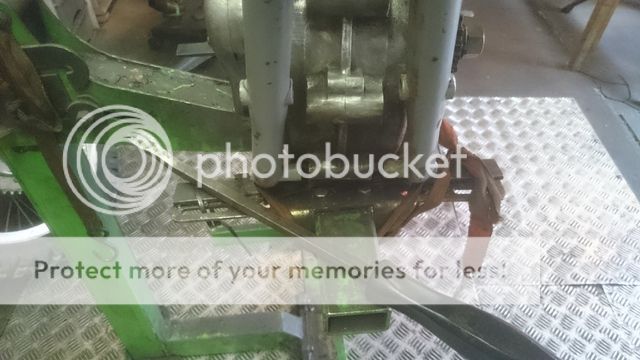

drive and primary chains all lined spot on ,axle ,spacers and adjusters all made

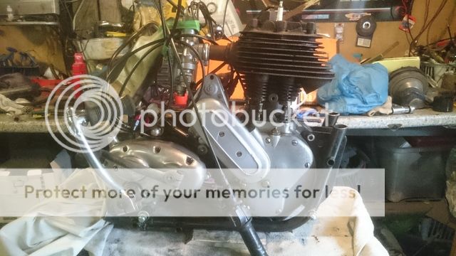

moved on a little ,all up and running ,probabley 10 different bikes in one ,about 85% brit 15% alien

oh well short and sweet, time for the next one ,which is a ARMHA style tracker based on a a50r bottom end and thunderbolt top end should be fun ...another to upset the purists lol i will put another short build thread up ,many thanks guys for taking time to post
the fantastic feeling you guys will know im sure is when a bike of many bits gets you up and down the street for the first time, its like winning the lotto...aint that what its all about
spec
1958 modified Ariel capr frame
1941 16h 500 Norton engine
AMAL pre Monobloc carb
Norton dommie laydown 4 speed gearbox
BSA clutch
BSA a10 cut shut and completely reworked swing arm
ariel trials alloy fuel tank
universal trials seat
forks jap unknown
reworked yolks jap unknown
21" jap unknown wheel and brake
18" MX rear alloy wheel 55 tooth sprocket
bsa a65 foot pegs
bsa reworked rear brake pedal
e18 road trials tyres 21-300 and 18-4.00 rear
triumph speed triple handle bars
home made oil tank
domino throttle
5.5 c section rear mudguard
every other part handmade
probably missed loads
oh gold star tank badges ha ha ha

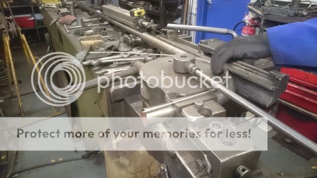

i all ways build to a complete bike first ,ready to ride,then break it down, do what your doing cosmetically and its only a day or so to bolt it back together
front race plate just a off cut of 3mm alloy plate ,cut an oval first but didn't look right
saving the last job till the weekend ,a nasty job but someone's got to do it ...and thats to get it as dirty as i can, he he
show ponys are defiantly not my thing ,if bikes could talk they would shout "please use me "put some flowers in a vase if you want a ornament lol
