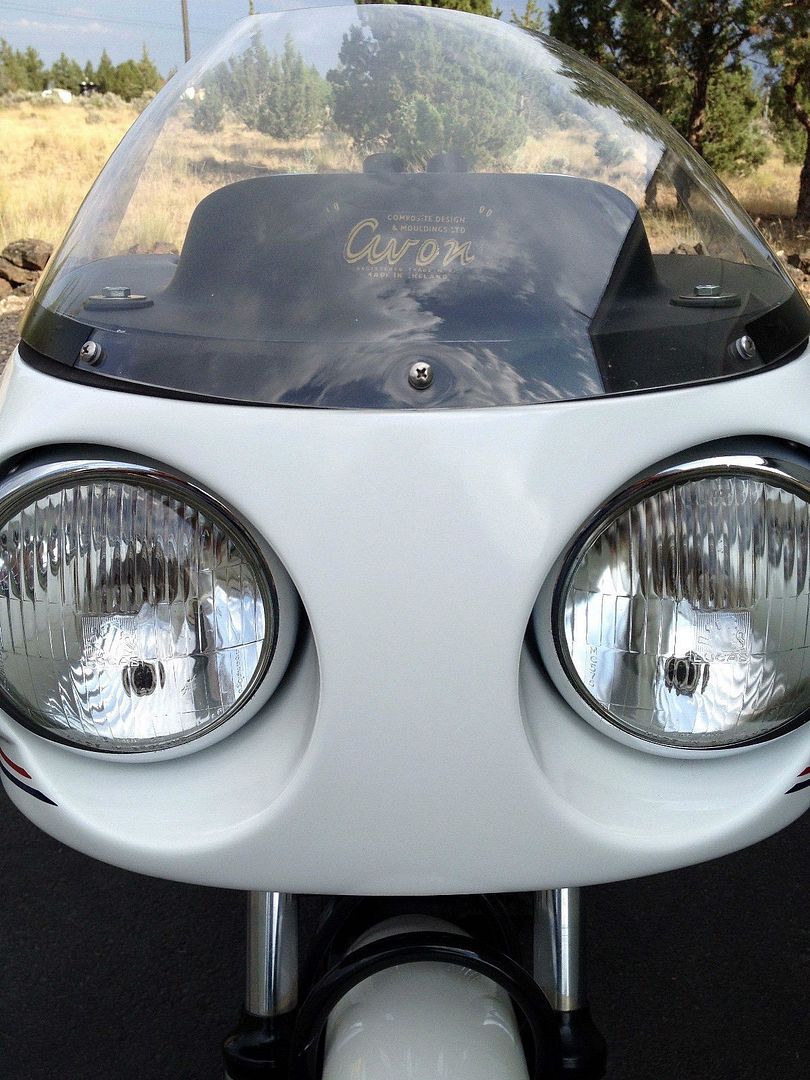

11/7, From AccessNorton member Robert_Norton:
Original JPN's would have a plastic airbox, which I think in turn means a different battery tray than earlier styles of 850. So you could check for that. The shift lever is also unique, and from your photos it appears you may have the correct one.
The JPN license plate holder is unique among various Nortons. Your bike appears to have the correct one, but your photos make it difficult to tell for sure.
JPN Nortons also have twin Zener diodes, and this bike seems to have the correct Z plates to support that feature. The (alternator, rotor, or both?) were also higher output items than other 850 models (except the MK III).
You have the correct left hand side cover for a JPN.
The fairing bracket is not correct.
Did you get the original fairing?
I recently acquired a JPN, and it came with a 2nd fairing, made by Sprint. The previous owner commented on how it was substantially thinner than the original Avon fairing, which I just verified and it appears to be.
A good thread is needed here documenting all the little details about the John Player model.
Years ago I had one that had the horizontal stripes and the cutaways in the cowling to access the spark plugs. It was originally sold in San Jose, if I remember correctly. It looked like the one featured in the sales brochure. The lower stripe was black, not blue, as was the lower parts of the left and right seat stickers. In the brochure the colors do look to be red and black.
Andover Norton may be making JPN parts now, as indicated at the below links. I doubt they've got the finer points sorted, though. Search for "JPN" on the first link, as they don't refer to the after market parts with the full "John Player Norton" name on the web page:
http://www.nortonmotors.de/ANIL/News.htm
http://www.nortonmotors.de/ANIL/Norton% ... art=067345
My reply from 11/8:
I have a plastic airbox complete from my '75 Interstate which I can install if it comes down to a total restoration, I know it's not going back on my street bike.
Looking like I will PROBABLY paint this fairing white with the commemorative Blue and Red/Gold stripes, maybe something on the seat as well. I kinda hate to paint the tank, even though it's already been somewhat "distracted" by smoothing over the topside welds; the Black paint job it has now is quite nice...

From Robert_Norton:
The right-hand side foot peg in the photos Jean posted is not original. The triangular plate that would attach to the Z plate looks original.
The upper fairing bracket shown in Grandpaul's photo is nothing like an original. I assume Jean's comment about the fairing bracket being correct is referring to the lower fairing bracket.
There is a lot of variety in the centerstands fitted to the JPN's. For a long time I thought there was one correct one, the type with the round toe catch that has a couple of 90 degree bends in it. Perhaps someone with more knowledge of the progression of kickstands can chime in.
I think another tell-tale sign to consider when sizing up a JPN for originality would be the style of chainguard fitted. All correct JPN's that I've personally seen (just a few) have all been fitted with the brake inspection plug and correspondingly correct chainguard. Did all MKII A models have the rear brake inspection plug?
I believe JPN models also had a unique foot peg rubber, flattened in a similar style to the ones Paul Dunstall made.
Original fairings were made by Avon, with aftermarket ones made by Sprint. The original Avon fairings have a decal placed at the front, beneath the windscreen. A Sprint manufactured fairing would not have the Avon sticker.
Below are some photos illustrating a few of the recent talking points of the thread:
My reply:
Looks more and more like mine is quite original, apart from the fairing, seat and mufflers, which I already knew were not original.
I've definitely got the rear brake inspection plug with the appropriate cutout in the chainguard (and it has the plastic splatter guard also).
I hope to have the bike running in a few days...
