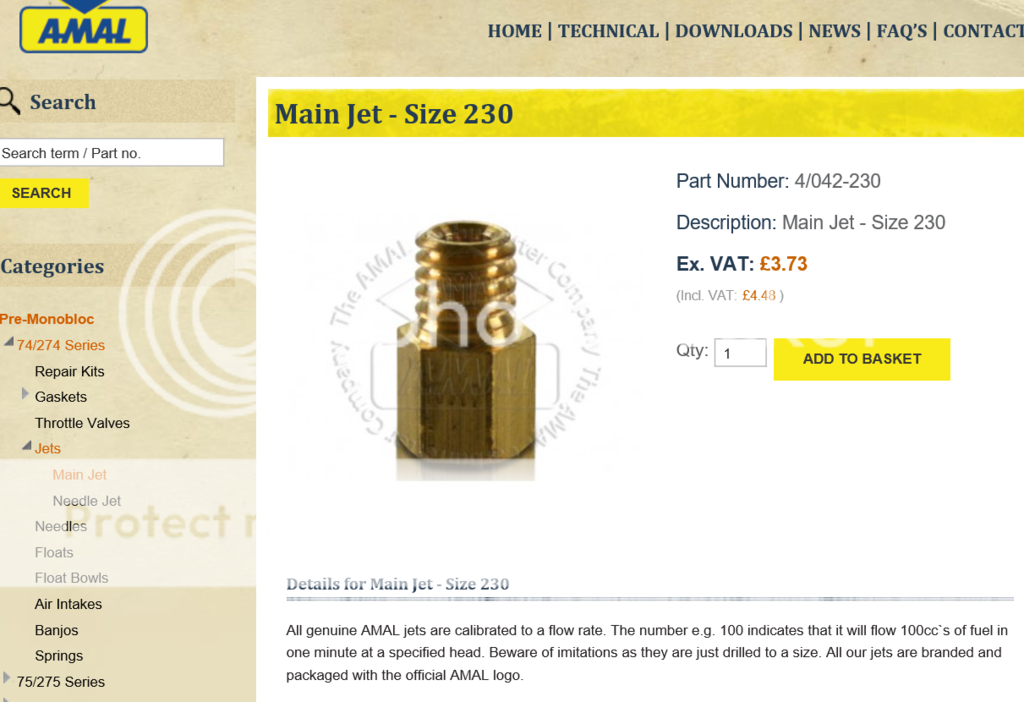

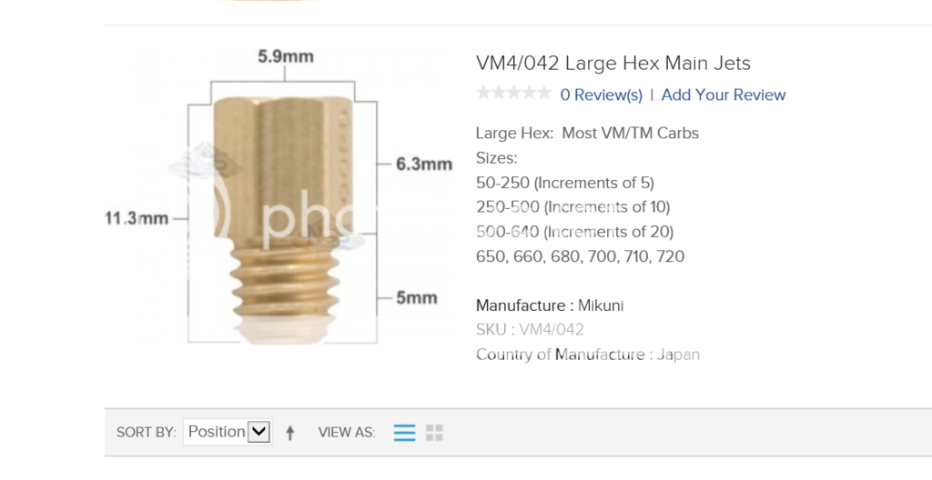

Have you looked at the main jets for the VM? They are exactly the same as AMAL. They are interchangeable and the Mikuni part number: 4/042 the same as AMAL. Have you ever measured the critical parts in a VM and notice for a given application they are the same as you would use on a MK2?
Barry Johnston wrote an article on the history of AMAL's influence on Mikuni for a Japanese Motorcycle magazine before he died. I have been trying to get my hands on a copy for years. It would answer a lot of questions. Also Burlen seems to have some of the AMAL records. Maybe they could shed some light on the subject.

Good information, as always, John. In a pinch, it's easier to find Mikuni main jets locally. Nice to know they will also fit a MkII.
It's a shame that MkII owners will never experience the fun of playing around with all those lovely Mikuni needle tapers. laughing

Who big fella, the 4/042 is used by AMAL in earlier models. Our Monobloc, and Concentric MKI & II models use part number 376/100.
While Mikuni lists a mirad of needles there are only about 5 that will work for a given needle jet. If you take a minute to understand the tapers and which bleed/primary needles they work with. Less when you separate the two and four stroke needles. Thisis not unlike AMAL. You will also find that the single tapers work best for tuning a Mikuni on a four stroke for the street.
With a bit of study it isn't hard to make sense of the Mikuini catalog which is unnecessarily complicated.

OOPS! My bad, I misunderstood you,John.
I found that experimenting with different needle jet/needle tapers can be just a whole lot of fun. laughing And, what works on my engine/intake/exhaust combination can be totally wrong for your bike. I've never found any suggestions for sizes on the bleed-type needle jets, though in theory they are more suited to 4-stroke engines. The 'hood' on the primary type does cut down on exhaust reversion, though.
Allan: I've heard that AMAL does indeed size main jets by flow. The numbers on the needle jets are the size, however (106 = 0.106"). According to the Victory Mikuni book, Mikuni main jets are numbered by fuel flow, #250 flows 250cc per minute. The same system might be used by AMAL? It gets a bit more complicated with needle jets. Each letter is 0.05mm larger than the lower letter, while each number adds 0.005mm to the diameter. An O5 measures 2.625mm, P5 is 2.675mm, P6 is 2.680mm.

Am I not right in thinking that Amal measure jets by flow rate through the jet whilst mikuni measures using the physical aperture of the jet.
No, both main jets are referenced to flow. While both needle jets are referenced to dimension.
There is an old British industry reference that refers main and pilot jet sizes to an appropriate inch dimension. I posted a link to part of it on britbike a while back. It is useful in a pinch but I doubt you could get any results plus or minus 10% of the flow you require. Anyone interested in all this should be on the look out for a set of jet drills made by Anderson & Forrester located in Colorado. I have used my set in a pinch for years...
