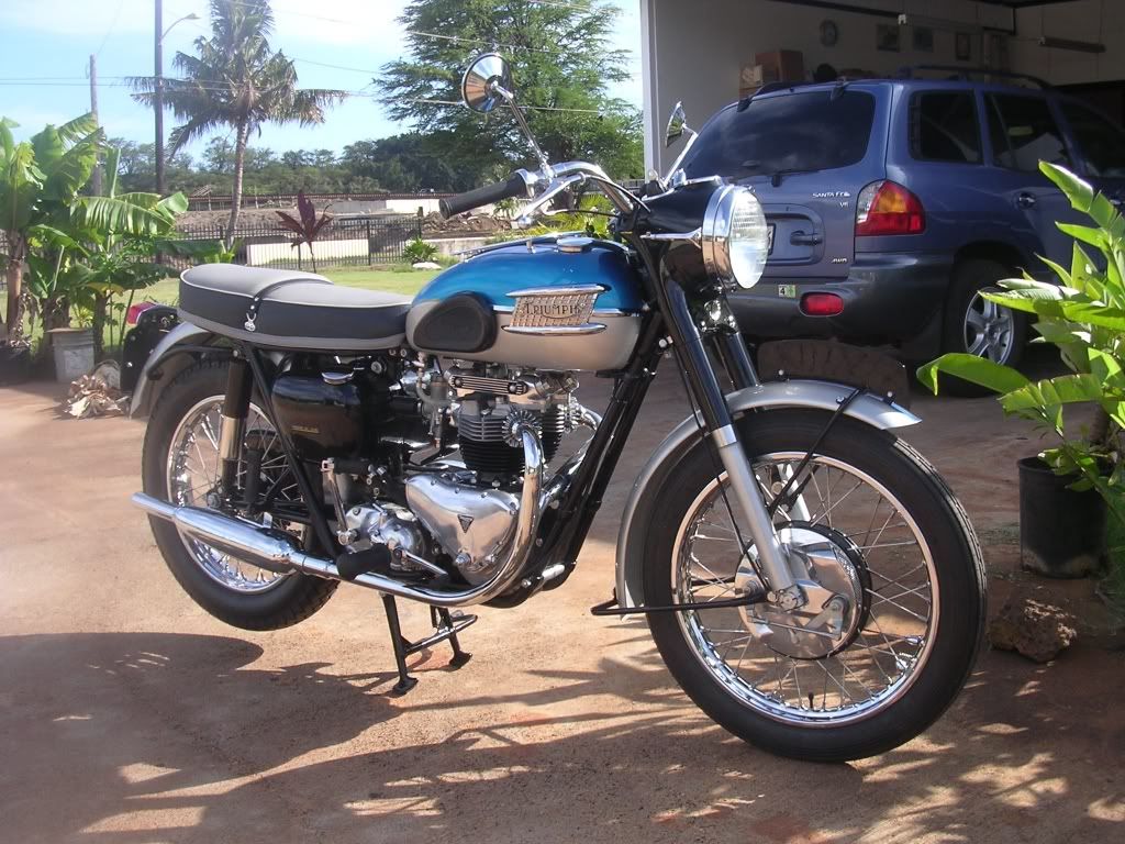

Cas,
I've only had one Commando, so it can't be mine. Maybe Dave Webster, a real Norton/Guzzi nut here.
I did sell a '62 Thunderbird to a nice couple in Kona a few years ago. That makes at least one more Triumph over there.
They won't sell it back to me...dang....
This bike's head I sent to the mainland for the works and it was 8-10 years ago now. I got the Amco 45 guides and 7mm Kibblewhite black diamond valves, 500cc racing springs and titanium retainers. Total overkill for a backroad cruiser. Oh, well, should never have to mess with it again...
I think I've overcome most of the challenges of trying to build a decent Triumph out in the middle of the Pacific. Shipping is still kind of a sore spot....
Drop me a note if you get hung up on something. I still have some parts, tools and whatnot. I've backed way off working on bikes and concentrate on my other hobby mostly, which is antique electric fans.
If you get a chance, send your numbers to the National Motorcycle museum in England. The do record searches for free. Maybe I can find the email address here somewhere...
Many T-birds that are here were originally bought by Montgomery Motors in Honolulu at auctions in Australia. Australia used T-birds for some years as police bikes. This bike was one of them. It was found on Molokai in deplorable condition.
Montgomery Motors brought them over, customized them, and sold them mostly to servicemen.
This was one of my most expensive restorations....by far.

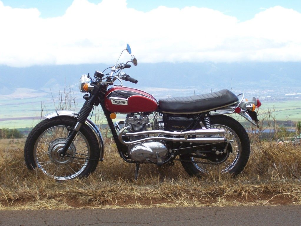

My neighbor is an ex jarhead F4 back seater who bought this bike new in '71 when he was coming back from 'Nam.
1971 Triumph T100C
It still only has less than 4k miles from new. I've restored this bike for him now.....twice. The first time, it just needed a paint job and a careful going over. The second time it got powder coated parts and new chrome and all hardware re-cad plated.
Runs like a swiss watch.....a bit buzzy on the highway...low gearing, but sweet.

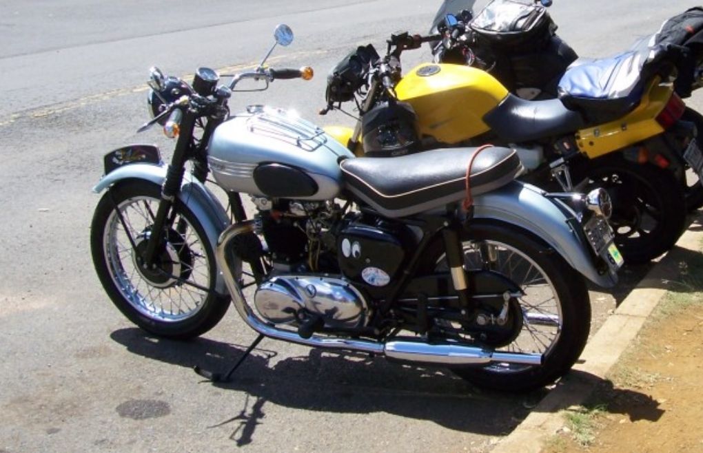

Since I've been back on Maui, I've done up a half dozen Triumphs that are now back on the road. Most linger in garages here because of the lack of expertise to get them running and keep them that way. There are an unknown number of Triumphs here and all over the state. I know of probably a couple dozen here, but there is likely four or five times that number actually here.
In addition to that, there is a Brough Superior here, a 30's BSA single, at least four rigid Triumphs, three that I'm responsible for and the other day I spotted a British Racing Green 750 going down Haleakala highway two up and I couldn't catch him.( I was in my car).
I don't look for work...it finds me...but I still get some satisfaction out of getting another one back on the road.

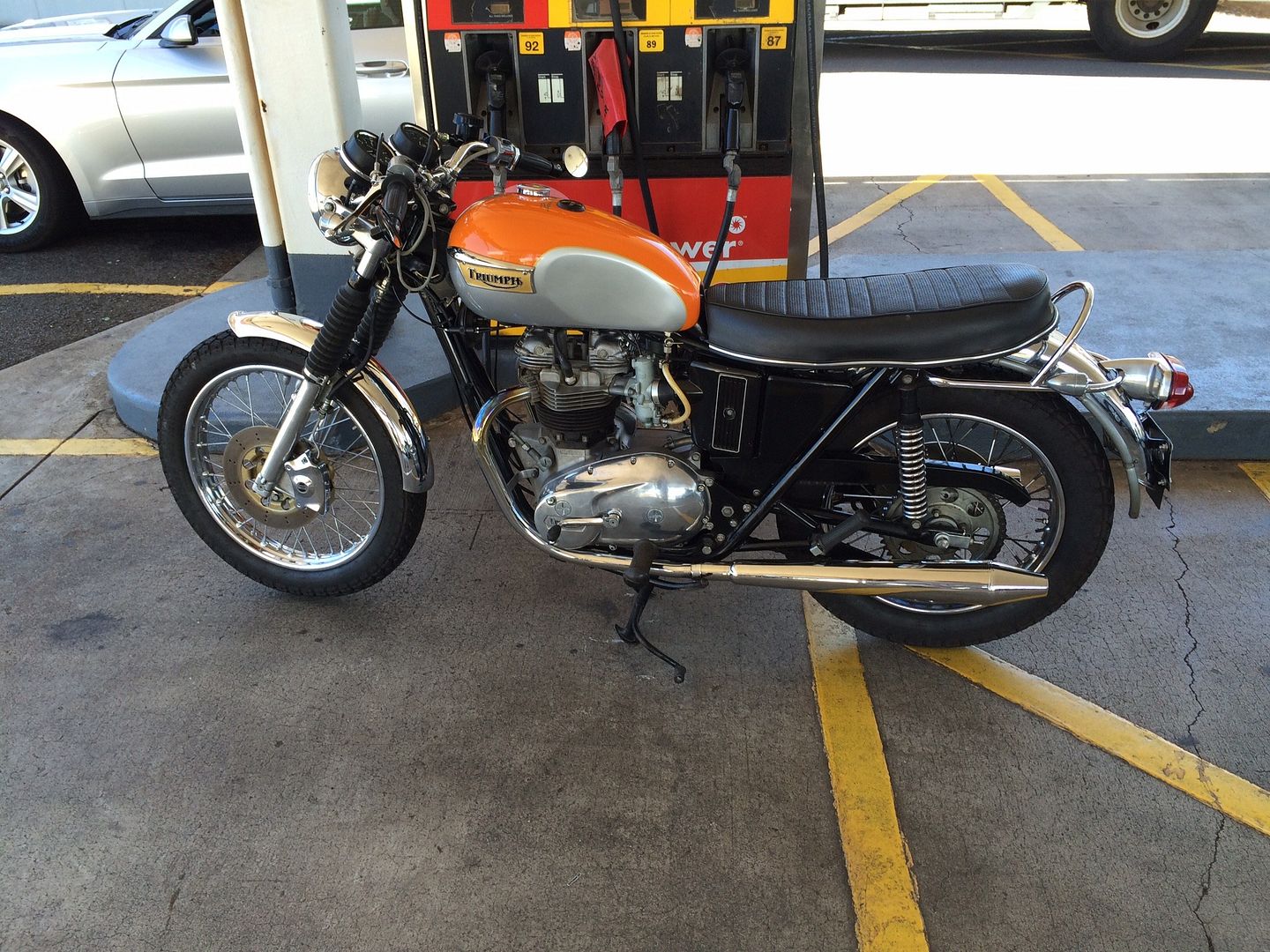

A buddy of mine over on Kauai had this bike over there.
1976 T140
I worked on it for him a couple of times. Once after he crashed it going over the Wailua river bridge. He moved to Maui, then a couple of years later I did too. Then one day earlier this year, this guy shows up in my driveway with the same bike. Gotta love island life....
Mechanically, it was pretty good, but with new AMAL Premiers and a Pazon ignition installed, it runs super now. A paint job, new brake rotors and exhaust system really smartened it up, too.
This bike has about 5k miles from new, too. Those are my favorites to work on.

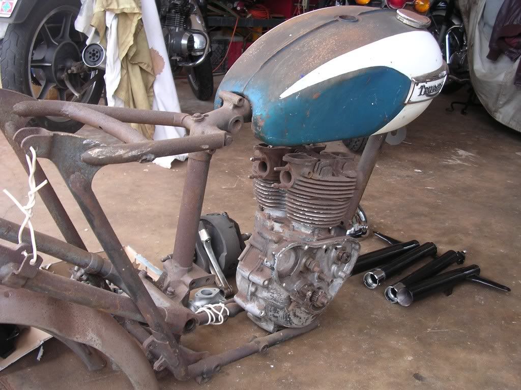

Bill, I don't have any flattering images but here is one as-pulled from the PO's garage. Would you believe he lost the Ca title and somehow got the Hawaii system to issue him with a new one?
I added new tires, Boyer ignition, solid state reg/rect, new chain and a '69 front wheel (the old one is in the shed).
[img:center][/img]

Sweet. These T-birds are great cruisers, usually smoother than TR6's and Bonnie because of their lower power and consequently more reliable, too. Such a deal. Since they weren't very popular in their day(everyone wanted faster sport models, of course) and they were seen as old man's bikes, that's always kept the prices lower. But everyone who has one will tell you what good bikes they are.
Great mod, too, with that front wheel. Note my '62 has one, too, but maybe you missed it. I tried to disguise it by cutting off the outside ring and polishing the whole thing.
Also, I love the sound of those whopping big mufflers. Lotsa "boom" from them making them sound like bigger bikes.
You scored yourself a real treasure there.

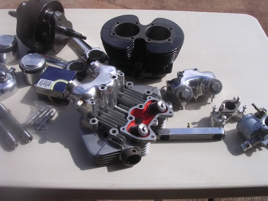

As far as how many Triumphs are around. Get this. The frame and many of the bits I sourced for my current ride came from a guy in Pahoa. He was building a duplex framed T120 last I heard. So right in your neck of the woods is another Triumph nut.
I started my project with a motor I sourced from a guy here on Maui a number of years ago. He ran a bike shop back in the 60's and 70's and had 7 garages packed with parts, each garage dedicated to a different brand of bike. His family wanted it all gone after he passed away and charged 500$ per pick up truck load. I could only afford two, but I got probably four complete bike projects and a lot of parts. This was in it.
I sold most of it off locally and there are several bikes running around complete from my parts score.
I made this bike from one of the projects. Non matching numbers and no paperwork. I run Vermont license plate on it and haven't had any hassles so far. (Knock on wood) I should say the numbers match now since the frame I got from the man on the Big Island was never stamped. Very cool.
