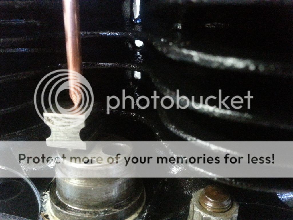

I see your points on the follower radius determining the duration (dwell) of the cam. It is indeed a large can of worms.
Where is my drawing board?
Edit:
That first picture of the tappet block in the cylinder base... It appears that the block is not sitting square to the base flange.
Is that designed in or is it a flaw?
I ask because if that block needs to be 90^ to the flange it will change the modifications you need to do. In fact it would change the valve timing, wouldn't it?
When I watched the posted videos last night (assembling the vintage engines at the factory) it is quite easy to spot all the subtle reasons for these to be so far apart from true. Even torquing parts with "T" bars, and no fixtures to hold the engines solid.
Now add 40 plus years of running out of true... Large can of worms indeed.
yes it was designed in and yes it is an annoying flaw.
it's how you keep the camshaft outboard of the crank and then have the rocker and valve assemblies tucked in closer to the cylinder centerlines. the triumph solution.
norton and bsa solved the problem differently, but then again it is nice to be able to time the triumph cams separately.

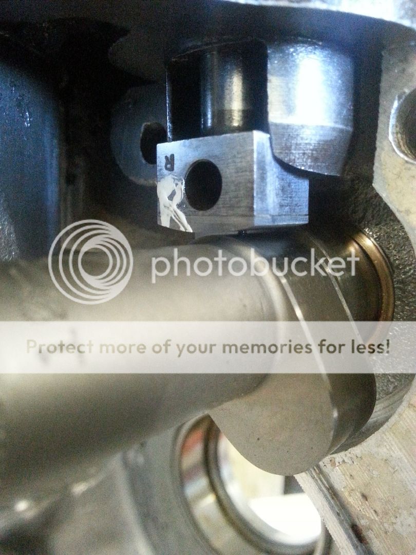

john, while you were submitting that post, i was down at the shop filing down the ears on my guide blocks.
i can't make the annoyed emoticon appear here, but it should.
i took off just enough to allow the cams to rotate with about 0.005-0.008 clearance, so that i could see what might need to be removed from the inner recess or from the face of the tappets themselves. but i have some more guide blocks and tappets coming from eBay, so by the time this is over i'll have enough trot line weights for a whole summer of fishing.
if i raise the guide blocks by using shims, i will still run into the bottom of the cylinder flange before i can go all that much higher. so i'll have to come up with something. but at least dave madigan has adjustable T120 pushrod tubes, so that particular headache can easily be solved. i've done some measuring this morning.

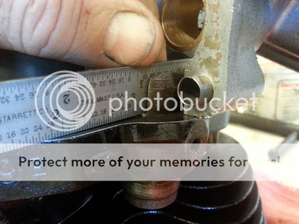

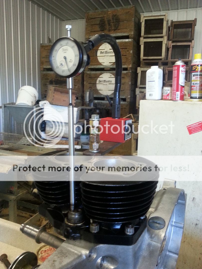

so here is where i am. clearances are easy to measure just by sticking a feeler gauge in between the cam and the lifter, and seeing how much i can put in before it rubs. have checked only the right side, because i can take that tappet in and out without undoing the jugs. obviously both sides need to be checked. the setup is easy, using a new pushrod, here on the exhaust side:
with the tappet in, and seated on the base circle of the megacycle cam, there is less than 0.001-inch deviation --none measureable, in fact, literally-- as i rotate the cam back and forth a few degrees. nice work on the cam, clearly. i have no complaints on megacycle's work:
with the cam and the exhaust lifter installed, i could get only 0.353" out of the nominal 0.375" lift before the top of the lifter hit the recess in the tappet guide block. so i took the lifter out and put it in upside down to use for a measuring tool:
i was looking for just a difference between clearance at base circle and clearance at cam nose, and the reversed lifter makes this easy. instead of the pushrod, i took a piece of soft copper wire and hollowed out the top in the drill press and pointed the bottom on the grinder. crude, but it varies less than 0.001" through the full lift of the cam, even when rotated on an off-center drillway in the exhaust tappet:
^^^it's really straighter than that, but the wide angle lens on my telephone makes it look curved. didn't realize until just now how much longer it was than necessary.
anyway, using this set up, the exhaust side cam lift is a genuine 0.373 inches, a bit less than the advertized 0.375. since the exhaust tappet hits the recess in the guide block at 0.353-inches, i obviously need to come up with 0.022-inches here, not counting a few thousandths for running clearance.
on the intake side, the cam rotated clearly with 0.002 clearance. the actual lift of the intake side was 0.371", again less than the advertized 0.375", but close enough for my level of skill.

so at this point, i know i have 0.002-inches of clearance between tappet and guide block on the intake cam, at a full lift of 0.371 inches. a bit less than i'm comfortable with.
on the exhaust side, i have a measured cam lift of 0.373 inches, but only 0.353 inches of clearance above the tappet top before it hits. an unhappiness level of 0.020 inches.
so how much can i trim the exhaust guide block? john healy has pointed out the 45-degree fillet at the insides of the tappet guide block. putting a straight edge in there and carefully just missing the 45-degree fillet gives me a gap i can measure with a feeler gauge:
i don't have enough hands to show the feeler gauge in there, but no matter. when all was said and done, i could set the straight edge in the recess on the exhaust side, just missing the 45-degree fillet, and determine that i could fit in both a 0.024 and a 0.003 feeler gauge blade together, total of 0.027 inches.
0.028 would not go.
on the intake side, i need to find 0.001 inches to get a running clearance of 0.003 inches. just a light skim of the tappet guide block will do that, but again i need to retain the fillet.
on the exhaust side, i need to find 0.020 + 0.003 inches, so it seems i can get that by trimming the recess in the stock tappet guide block by 0.023 inches out of the available 0.027 inches. doable, so long as i can retain the 45-degree fillet in the recess.
in other words, i don't need to trim either intake or exhaust tappets to get a running clearance of 0.003 inches with this cam, basing my estimates on these tappets in these positions.
my refaced tappets actually vary in length by a bit, so i need to look at just how long they are.
but i am out of time today and have to crash.

Kevin, I'm far from anything of an expert, but I personally would have measured your lift with both case hands bolted together, you could very quickly alter how close you are to the Tappet block. A strip of plastigauge would tell you how much clearance you have.
If your going to use the adjustable push rod tunnels, then I would be raising the cylinder and skimming the top face.
For the cam, get your micrometer and measure the base circle, deduct this from the second measurement which includes the base circle and the full height of the cam.
The next measurement is at the valve, that's how much actual lift you have.

you're right, i'm not going to be running half a motor, so i'll check with the thing assembled. but just trying to see where i was starting out at didn't need precision.
also i purposely didn't use a base gasket for this, to allow for all the available squish when assembling the top. i could solve the clearance problem instantly by using a thick enough gasket, but i would lose squish and compression. the composition gaskets i have run 0.015 to about 0.020, and i have a copper one that measures 0.021 that arrived in the mail yesterday to experiment with. it may be that your idea about using a gasket and skimming the top is the simplest way to do it.
on the rocker geometry, obviously you want to get it as right as you can, because there is exactly one setup that gives maximum valve lift, and it's the one where side loading the guides is minimal and balanced for and aft. i've read where people tune powerbands by playing with this, but it starts to go over my head really quickly. i tried three base gaskets once on a bonneville (stock pushrods) to see if it would let me run regular gasoline, and the rocker arm misalignment was dramatic.

I thought triumph push rod tube seals came in a variety of thicknesses?
If your set up uses thicker ones heres what i would do.
Dont worry about the inlets 2 thou is two thou, it will increase with heat.
For the exhaust raise the lifter block by 25 thou or more with a spacer and fit correspondingly thinner pushrod tube seals . , if you use a base gasket you will have plenty room for the inlet
tappets. But, I would check with both cases together, you wont get full lift with the cam unsupported at the far end.

i agree the solution is looking like shimming the tappet blocks up a bit. i've got some coming now from eBay so i can try out john healy's suggestion of trimming one to use as a tool for measuring clearances. i've already trimmed the ears on two that i have so that they clear the cam nose, but that idea was when i was still planning on making up the rest of the clearance by refacing the tappets.
i didn't measure the tappets before i filed the ears so i don't know how much i took off, which i need to know before i can come up with the appropriate shims.
gavin, messing with an assortment of seals has always been a curse of the triumph pushrod tubes, but it might turn out to be a blessing on this instead. shimming the tappet blocks requires the least changes elsewhere, as the neither the tappets nor the pushrods are affected (within reason). shimming the block and then skimming the top requires more changes to the stuff in between.
