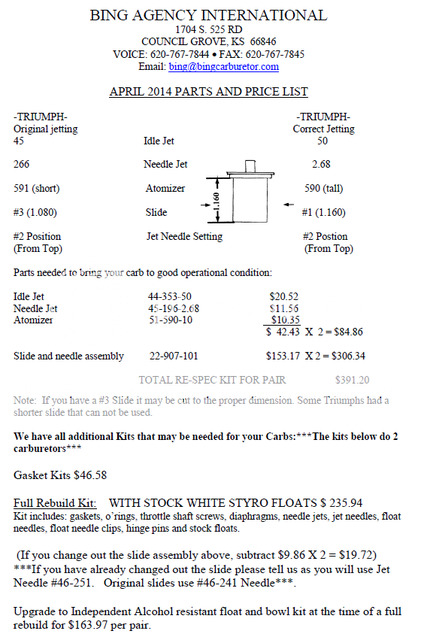

I have an 83 TSX that has Bing carbs (not AMAL). They have been sitting for approximately 20 years and to get the bike up and running again before I start the rebuild I need to give them some attention.
The Triumph part numbers are just about useless but I have managed to track down some BMW threads and info and found these guys Bing Agency International. I sent them an E-mail with the numbers from my carbs and they sent me some info as well as price lists.
Within the price list it shows that the original jetting is not the correct jetting and if I decide to purchase new jets then to have the correct jets it’s going to be an additional $30.87 added to their kits.
I am still exchanging E-mails but I want a second opinion (I know It might be better answered on a BMW forum).
Here are the original jetting’s
• Idle jet = 45
• Needle jet = 2.66
• Atomizer = 591 (short)
• Slide = #3 (1.080)
The correct jetting’s are as follows
• Idle jet = 50
• Needle jet = 2.68
• Atomizer = 590 (tall)
• Slide = #1 (1.160)
The cost for the correct slides is $306.31 but according to them “If you have a #3 Slide it may be cut to the proper dimension. Some Triumphs had a shorter slide that cannot be used.”. I only have one carb torn apart but the slide has a 3 stamped on it so I’m guessing it can be cut (I sent them an E-mail asking about this).
In total I can buy one of two kits the first of which includes all new jets, gaskets, “O”-Rings, and floats for $266.81 (pretty much everything aside from the correct slides). The second kit has everything but the floats and its $204.09.

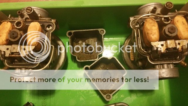

For $60 is getting new floats worth it? (It also includes the pivot pins)
Also what do you all feel about getting the larger jets?
I want to do the carbs once and not go thru this again for some time after rebuilding so once they are fixed ill buy some 4 cycle TruFuel this stuff is amazing and has a much longer shelf life than the gas from a station. This way I am hoping I can reduce the amount of crud left behind to damn near 0 and I’ll just let the bike run its self out of fuel, pop the bowls off, and clean them out before the gaskets dry up so I can store them until im ready to assemble the bike.
Any other suggestions or am I looking at this in the wrong light?

I wouldn't replace those floats; they look fine. I would change only replace the pilot jet (idle jet in Bing speak)and play with rest of the stuff later if necessary. You can buy a rebuild kit that consists of all O-rings, diaphragms, and gaskets from a BMW dealer or specialist for $73.64, which does both carbs. It does not include float needles, which you may need at $17.55 each. The kit P/N is 13 11 1 258 051 and the needle P/N is 13 11 1 335 318. An important item to note is that the choke discs are I.D.ed L and R as if the carbs were on a BMW. They should be reversed for a Triumph.

I am slightly confused as to what jettings you are referring to here. Just be sure that what you call "the correct jetting" is for this particular bike and not some BMW, you are somewhat unclear on this. Is what you call "the Original jetting" what it had from the factory, and why would this be wrong? From what I read over on the Members project forum your Grandfather who owned this bike before appears to have been a person who knew very well what he was doing. I therefore would not mess with his jettings until it is proven faulty.
There is no need to replace the jets just for starting up the bike! Just clean everything up and replace gaskets and perhaps the odd dried out o-ring or two. If you are setting out to do a complete restoration of the bike a carb overhaul is just an hours worth of work before you fit them back on before startup, nothing to think to much about know.

I agree with Simon that there is no reason to change the jetting of your carbs, before you have the bike running and found that the current settings are incorrect.
There is no reason to assume that the previous owner made a mess of the jetting of the carbs.
Make sure you use the correct data, advice from a BMW source will certainly not be of any use for your Triumph.
My advice is : leave the settings as they are, and start with giving the carbs a good cleanup.

No, because you're not jetting the carbs for a BMW.
• Idle jet = 45
• Needle jet = 2.66
"Idle jet 45", "Needle jet 2.66", "Plunger(Slide) No.3" (and "Main jet 140")" are what's listed in the TSX parts book, so why do you think they're wrong?
Is this supplier you are dealing with suggesting their jetting recommendation is a better option than the original spec. as this may be a different matter entirely.

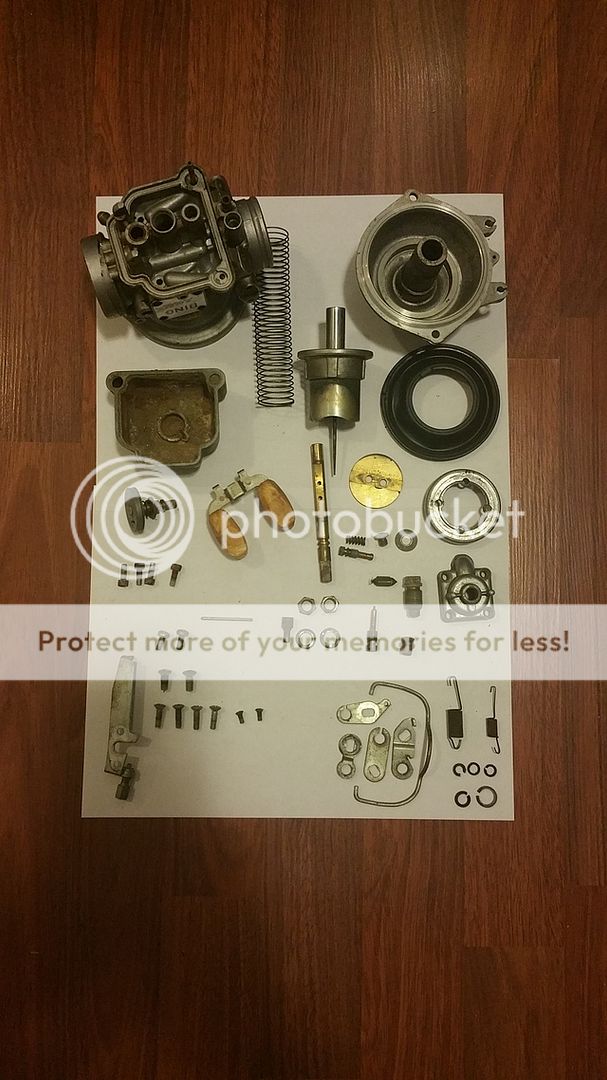

If you want to save money, keep the existing jets as I doubt they are knackered
a good clean is all they need.
Many people report that a small "harbour freight" ultrasonic cleaner is good for carb parts.
Rubber parts do deteriorate over time/exposure to sun/fuel

Excuse this post because I am very tired and just got home from work (been up for over 20 hours).
I tend to jump from one thread to another because my project thread may only attract a few people vs. a thread titled “Bing Carbs” might attract an expect or lack thereof but either way.
I by no means have any idea as to what this company is saying in regards to original and correct jettings that’s why I am posting here.
The below image is a copy of the PDF they sent me in regards to the triumph carbs (not BMW)
Now this carb is a type 64 CV carb (from my understanding) and all the CV carbs take the same needles and have the same jettings. This carb isn’t much different than the ones on the BMW’s the only major difference is where mine says BING below it AMAL is engraved instead of the Bing numbers.
I do plan on doing a full restoration and if re-jetting is worth the time and effort in the end then I am game however I agree it should be something done after I get it started up. If everyone says no re jetting is not a good idea or worth the time then I’ll just buy the new parts that match the current and fix the carbs once and not twice.
I have no idea what a larger jet value will allow (I am assuming more fuel, better combustion ratio, more power) because I know very little about carbs.
If I have time I’ll just call the company and see what they have to say as far as why theirs an original and a correct jetting.
The bike will be started with its correct settings I just want to know what I want to do in the end before I make an order.
Thanks, if we'd had that information from the start then I think we would have had a better idea what it was you actually wanted to know, as I think many of us who replied were under the impression that you thought the jets you found in the carbs were not the correct original jets.
As the carbs are to the original spec. then there's no reason at all why the bike shouldn't run reasonably well with the carbs set up as they are, however as already mentioned, these carbs were originally set up on the lean side to comply with EPA, so the "correct" spec. suggested by the company for Triumph Bings may well offer some improvement in running when compared with the "original" specification.

I am with the others clean it up and see how it goes. Lot of info here:
http://brook.reams.me/2015/05/08/1983-r1...ebuildrefinish/
The original jetting from my May '82 workshop manual is as follows:
T140ES2
Bing CD
64CD
Main Jet 145
Needle Jet 2.66
Needle Pos 3
Piston 5
Pilot Jet 45
My '81 machine was set up similar and ran horribly rich. Fouling plugs etc, I thought it was just flooding which these carbs are prone to, struggled for a year with it. However I discovered an original rider's handbook for my police machine and found the following listing:
Bing Type 94
Main Jet 145
Needle Jet 2.64
Needle Position 2
Piston 3
Pilot Jet 45
It now runs much better and is no longer pi$$ing fuel through the engine. So do run it and then decide.
