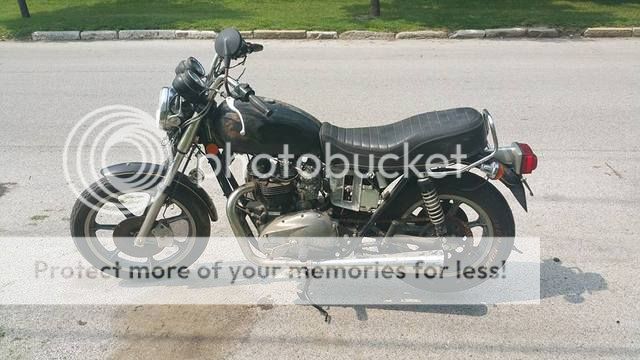

Due to recent events I wanted to re-introduce myself and my bike to the forums.
My name is Chase I am 26 years old have just recently obtained my motorcycle license. I obtained my license because many years ago my grandfather gave me his 1983 Triumph TSX. My grandfather bought this bike brand new and after many moves and traveling across the country the bike found a home under a car port with a majority of the parts sitting in a tub in a station wagon.
A few years before my grandfather passed away he asked my mom to take the bike and put it away until she felt I should have it. Now that I have grown she felt it was a good time to give it to me.
It has been sitting inside out garage for almost 15 years and have been touched but once or twice. My step dad took it to a friend’s shortly after we picked it up and managed to get it to run but since then it’s just been sitting. (I threw a huge fit that someone other than me was touching my grandfather’s bike and I think my step dad appreciated that so didn’t touch it again)
Here are some pictures of the bike at my parents’ house and on my trailer ready to take the ride from Kansas to Illinois.
Here are some more pictures from when I got it home

The first thing I did once I got it home was try and piece this puzzle together by putting what parts I could onto the bike and begin to make a parts list. Here is the aftermath.
And because I told my fiancée I wouldn’t be working on the bike for a while she thought it would be fun to catch me in my lie and post it on Facebook.
Since getting the bike I have created a large list of parts I know I need because I am missing them as well as a list of parts I need because they are obviously broken (still adding to this list).
Ill list these just in case anyone might have some laying around or might know of where I can get them for a great deal. As of right now I cannot afford to be spending any money on parts until likely after Christmas.

Welcome on board, you have an interesting and quite rare Triumph,.
My plan would be , steady , read all you can about late triumphs 71 onwards, the OIF in Frame, which your bike is built on was std for years, the motor , has an electric start which sets it apart from most all of its ancestors.
You will probably find that not one supplier has all you need, some folks specialise and the market is better for it.
youre info so far looks good.
Post it over.
Post on the triumph board for more details and views,

One thing you will find unique to your bike is that it has Bing carburetors fitted from the factory as compared to Amals most every other Triumph prior to around 1980 came with.
Regrettably, there isn't the wealth of knowledge on the Bings as there is on the Amals. Here is a good source for Bing carburetor info though:

A few things spring to mind. The bike looks fairly complete and has been run. Does it really require a full ground up restoration? Anyway....
While many things will need to be ordered from specialists, there are also many that can be found elsewhere without the price premium you will pay from dealers. For example, bearings direct from the suppliers, grade 5 automotive fasteners (by 83 I think zinc plated UNF/C were used) for most frame and cycle parts can be matched and purchased from fasteners specialists. Plain rubber grommets and O rings are available from most hardware stores etc.
Elsewhere in this section I have posted a fairly simple paint and panel guide that could help you get that tank all black and shiny again.
Lots of advise can be gleaned on getting the electrics sorted and connected back up.
Well, you get my drift

I would tidy it up and run it, the main issues will be with rubber parts as they harden/crack with age so new tyres, brake hoses etc along with the other list of parts you need. Do a full lube on all the cables etc, flush the frame out and fit a Charlie's filter. Run it for a couple of years and then once you know what works and what doesn't plus you understand the beast a bit more then strip and do a full restoration. As long as you run an oily rag every few months over all the chrome and wheels they will not get any worse.

I understand yall saying do a dry run before paint however the bike has already been started in its current condition so I see no reason to try and restart it until it’s complete.
Mt step dad had it running for a short period of time but it’s sat since then. Getting into the engine should give me a better idea as to what needs replaced obviously but if yall think it would only need seals I’m sure I can handle that no problem.
As far as paint goes I talked to my co-worker who restores old cars as a hobby and has a full shop with paint booth he said it will likely cost about $50 just for simple black and a base coat he has the rest on hand.
Really I would have him do all the black and then have the mud flaps, tank, and sides sent to get the decals painted on and then cleared.

Since it has sat for sooooo long I would still pull the head/cylinders to inspect in there. At the least there will be surface rust in the bores, and stuck rings. At the worst, one cylinder could be full of water, and goldfish, beavers, lillypads.
There is nothing in there that is scary Crazyeye. If the cylinders pull off in good shape then the bottom end should also be fine.
The primary side (clutch) is simple. Pull it apart, inspect, put it back together.
I agree w/ these fellas that YOU/this forum, are the best chance the engine has.
I also agree that a mock up is mandatory. If a REAL restoration is your goal, then there is nothing stopping you from getting the bike sorted with whatever you have, fire it up, and then strip it down, and restore it.
This will save you a pocket full of loot so you will have cash for gas, and maybe even enough to take the girl out to dinner.
Remember... Loads of people call bikes "She or Her". the women you live with will ALWAYS get jealous if you use those words around them. Save some dollars to take the real "HER out, and mock it up first.
2 cents... sorry!

the woman already knows she is second heck if not third on the list haha. This is the current affair i have.
My only question is what more of a mock up do i need than this?
The parts in my list are mostly to replace current parts that are bad and a few that are missing. The only thing that bolts to the frame and isn't would be the master cylinder and chain guard. It has been started and ran i just don't feel comfortable starting it without inspecting the engine first.
I am not worried about doing the work to the engine myself I just don’t have a lot of experience doing tear downs and rebuilds and none on motorcycles.
I’ll take your/the forums word for the engine and will at the least attempt it myself once I am ready.
I do want to get working ASAP but I’m forcing myself to sit and wait until I have some more info and can get some things around the house sorted out first as well.
How long ago? What did it sound like ? Smoking? Did someone ride it down the road? Someone can get a better idea of what to do by seeing and hearing it run! May just need servicing, mechanical fixes such as brakes, wheels, forks, etc! Then start worrying about cosmetics. You are obviously on a budget, thus the Go Fund Me thing. If you get it running, you will have a general idea of things. I know so many projects that get started by an enthusiastic person. Then funds, time and enthusiasm are in short supply, and the boxes are sold as a project. Don't be one of those guys! You can always tear it apart later and do the $15,000 restoration!

+ 1 for getting it running, then tackle the worst bits first. New tyres, fluids ,battery and brake parts, then ride and learn, this will be a fun bike to ride.
Ive no experience with Bing carbs, but BMW used them for years so parts should be out there.

Personally, when possible, I like to get them running first (as has been stated, to see how it runs, what sounds it makes, etc). But, you don't have to hold your breath long till someone crucifies you (with their keyboard) for running a bike that sat instead of tearing it down to the crank first, just in case it has some trash in the bottom end that might destroy the engine.
My solution is the FIRST inspect the sump plug (another move that some people do flips over, as they believe the sump plug should NEVER be touched). If there are fine bits of metal in the sump, don't run the engine till you flush it from top to bottom to ensure no bigger chunks show up. If there are big chunks (the size of a small tooth on a key, or bigger) DO NOT run the engine till you split it open and overhaul it.

For me being pretty new to motorcycles i really feel stripping down will give me a munch better idea as to what im getting into.
Also you mention the sump plug GrandPaul however i have no idea where this plug is located without looking at one of my books. I think i would better learn about the engine how it works, and where things are by taking it apart and having it on the bench.
Time will tell what i end up doing butthe way ilook at it we can all tale then apart in differant ways but as long as she fires abs runs when she is back together then what's the difference.

Maybe it has already been mentioned but don't forget you need to factor in tools to suit the bike if you are going to go inside the engine, remember the partial downfall of the British motorcycle was due to the home mechanic so reading the workshop manual is paramount along with using tools to suit it.
Because it has a family history I guess you know why it was parked in the first place.
It was parked because my grandfather moved it and then became ill and couldn't find the physical strength in himself to rebuild it.
I will be getting a handbook and doing more research inside the engine side of it soon. Ill also purchase or use Trats.net loan a tool program to loan tools if necessary.

...you mention the sump plug GrandPaul however i have no idea where this plug is located without looking at one of my books.
It's a big hex-headed plug on the very bottom of the engine. DO NOT TOUCH IT until you have the correct SIX-POINT (not twelve point) socket or box-end spanner to remove it. When you DO remove it, do so carefully, making sure to hold the tool square to the head of the plug (it's at a slight angle), otherwise you will start mangling the hex head; once that starts, it's all downhill from there.
