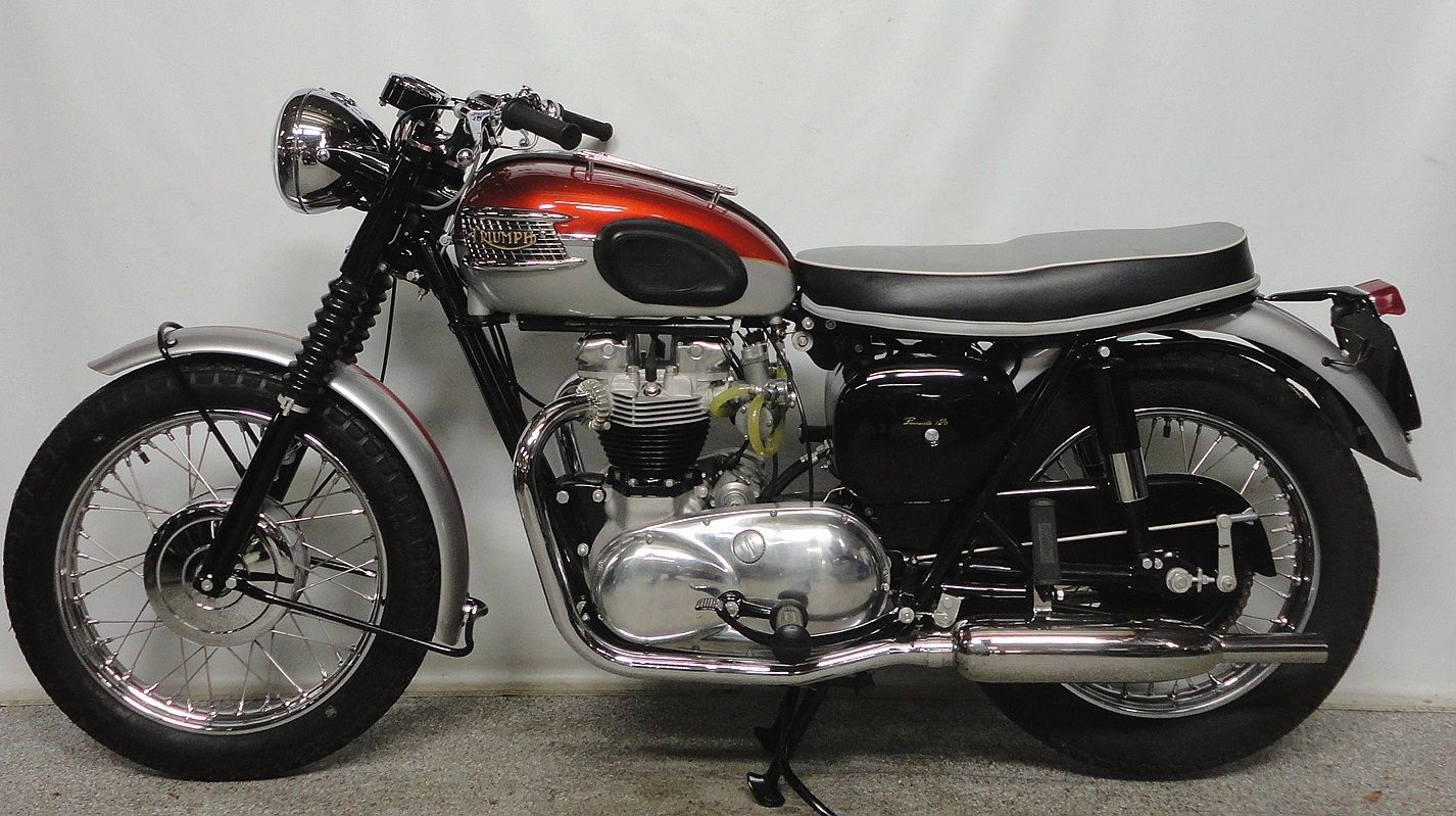

The color of the '61 in the photo seems off a bit. It's called sky blue and this one seems to be a bit too green, I think. Anyway, the home market '62's were also sky blue and silver sheen with black tool boxes and oil tanks.
I've seen several original olympic flame '62 tanks and they were much lighter in color than this one, more of an orange actually. Still, the ones I've painted I laid on the flame a bit heavier and the color came out very much like this bike here. I took this pic off google image search. I don't know who owns it, but apparently they like the darker color as much as I do.

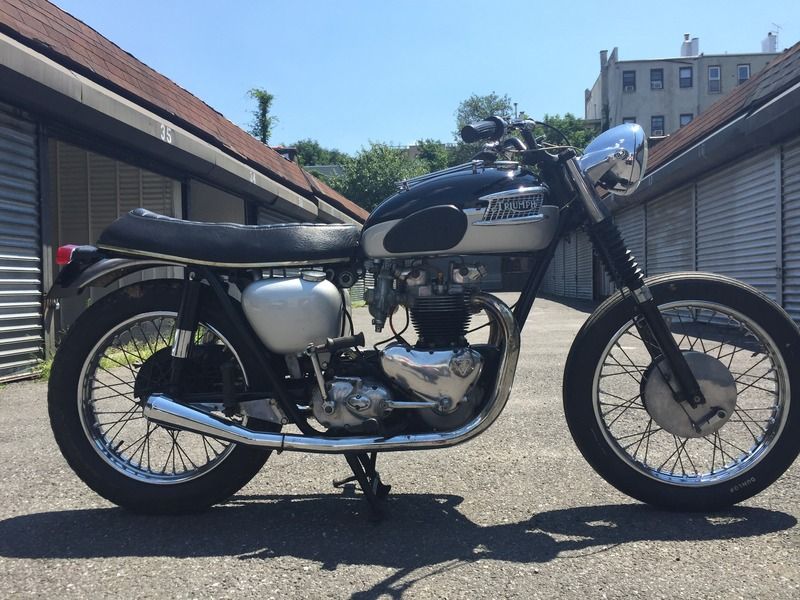

Are we talking performance wise or more in the aesthetic department? The previous owner of my '61 Bonnie had decided to paint over the sky blue with a standard black (he claimed it was BSA nos A65 paint) and changed the gold stripe to white, however the stock silver remains intact. The silver is fantastic! Likewise the TRIUMPH on the badge is silver, I'm guessing it's not the stock badge, but is definitely authentic. If I had to choose between the three, it would be 62. Also, correct me if I'm wrong, but didn't a majority of the seats come for the American models have a single color black seat? I think that bit is mentioned in Gaylin's resto guide.
Here's my 61. Yes I know there is plenty wrong but it's a decent base.

As far as I know, the '60 had an all black seat then gray tops after that. Yours looks like a much later seat to me. And I don't think there is anything "wrong" with your bike. If you want it to be more like standard spec it's just a matter of buying the parts and bolting them on.
