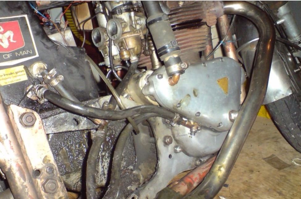

There isn't much to show.
Closer up. Excuse missing gearbox.

...man, that s a big MF breather tube.
In my motorcycle it would looks so big; may be having another breather could fix the problem?
Or may be those possible 2 plus 2 little ones on the rocker caps?
Re: Triumph Pre unit T110 oil leaks [Re: Maddoman] #609703
07/23/15 1:38 am
07/23/15 1:38 am
Posts: 7,419
Posts: 7,419
It can be done nore neatly than mine.
The wide part is where the BMW reed valve is.
Vents in the rocker caps are easy to make, because you can take them to the workbench, but I'm not sure they have much effect.
