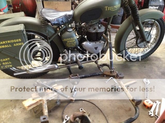

Lisa and I were going to the spring OVBSA swapmeet Saturday but couldn't decide, should we take the blazer or ride out as we were only hoping to find some BSA kickstart rubbers and a few other small things. Well it is a swapmeet so just in case we did take the blazer and I'm so glad we did. Just look what we drug home for the old flathead. Been wanting a chair on that old nail since I got it years ago. And even more so since I refurbished it a bit 3 or 4 years ago, but could just never seem to make it happen, till now! smile emoticon Now where'd I put that OD green paint?
It will be going on this old girl;

Wow! Good score! That'll look great on the old twin.
I'll be interested to see the questions AND the answers regarding mounting the hack. I understand that its a mysterious art understood only by the initiates .....

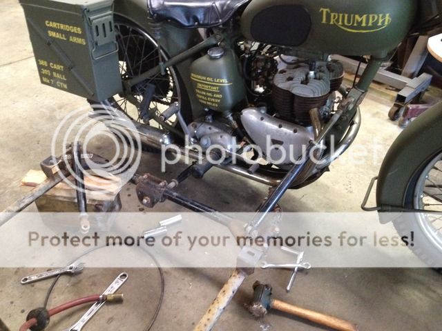

In your second photo......it looks like the front lower mounting strut is missing????? BUT.....look at the two on the right...the lower and the upper are pretty much in the position you'll want them mounted when you get that far. The lowers need to be at right angles to the bike and the uppers need to be angled out away from each other.

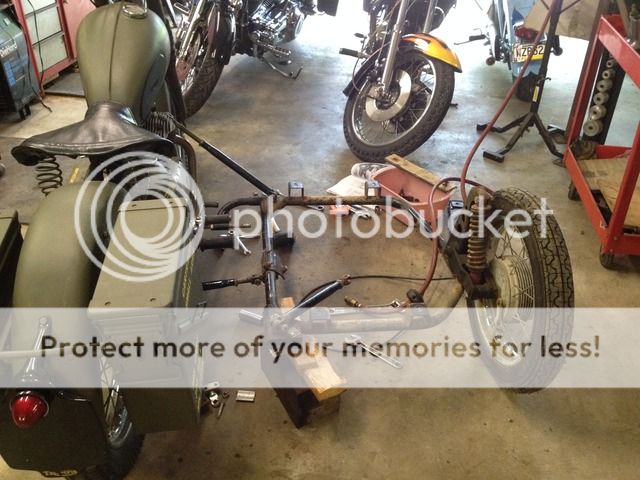

Well I finally got me a day off work and being as I read the directions I figured I might as well do some fitting up. Heres where I am now. I had to stop before I wanted to today because a few parts are missing, just a few particular nuts and bolts but I want to find the right ones. This thing has all metric and I figure to keep it that way as itll make it a pain down the road if its mixed ( I hate that).
If anyone in the know sees something Im doing wrong or off somehow please school me some, as this is the first one Ive ever tried on my own. Ill post more as soon as I get the fasteners I need.
Also been thinking I might like to try and make my own box for it, something different maybe but not sure yet. Baby steps I think.

breeze1954 - looks like you're on your way to building a beautiful classic rig. when it's done I suggest doing some miles in a big parking lot. hacks are a totally different critter from a solo bike, and you have to stick with it. 25 years ago when I built my B50/Squire combination, I thought I'd built a monster, having never driven nor ridden in an outfit, but my wife and I hung in there and after about 30 miles it all made sense, in fact we rode a 110 mile Lucas run from Cable's that year, and had a ball, even though we got lost. check out Bob Wark's Sidecar Installation Instructions on his warkshop.com website, you probably already know the Warkman from Marietta, OH he's an old sidecar man and always ready to help you with good advice. I'll be 77 in August and still can start and ride both my outfits, I no longer ride solo bikes, but hope to keep riding for a long time yet. besides, my wife likes to ride in the hack. good luck! Bob Kent, OVBSAOC #3

Ok then, heres some pictures of the mounts. They are the only way Ive found that will let me have the proper lineups the books say I need. I cut some pipe to go around the frame so the clamps are good and snug, but Im wondering about the upper rear. Maybe I shouldnt be as I couldnt get it to move and dont know how else to put it. What yall think, will it stay put? Im thinking to strap some weight on the bare frame just to try it out and see how it does before I start on a tub.

Looks good from here! How does it measure out?
Track, tow-in, lean. Do you have a picture from the rear we could see.
It's all a compromise but 3 out of 4 of your points look square to me.
The rear upper could be prone to rotate on the frame with that angle, I'd roll it over 90 degrees and shorten the strut.
Measure up, make some match marks on the fittings, take it for a spin and see if it shifts.
You're gunna like the way it rolls. What's the worst that could happen?

Hi Don, thanks for the reply. I dont like the looks of it either, but not sure what to do with that rear mount. I tried other places but then nothing else would line up right. I guess I could cut the strut shorter so it would fit straight to the frame. That might work if I can still get on the kick start.
Anyway, I have it at; 11 7/8 frame to frame, 1/2" lean out and 3/8 toe in. The papers said 12 frame to frame but every time I tried for that everything else went nuts on me so Im going to hope it works there. Does that sound about right?
Nice setup ya got there by the way, love the tail light on the car, where's it from?

What's the overall track width? Center of tug tire to center of tub tire.
Hey it looks good to me, you would have to shorten the strut to get that last point.
Take it out and see if it flexes much.
53-54 Dodge Meadowbrook, Plymouth Savoy on the taillight.
Got the focused backup on the front.

Morning Don, sorry but I got numbers backwards, its 3/8 lean out and 1/2" toe in. I also measured width this morning and its 42 1/2. I hadnt checked that before as none of my papers questioned it. Is there a proper width it should be? On the rear mount, Im thinking Ill try it out as is and if everything else works and handles good, then Ill shorten the strut so its straight to the frame. Dont want to cut anything till I know everything else will work as is. Straightening out that mount shouldnt change the rest I dont think.
BTW: are those donut marks I see in the picture clap
