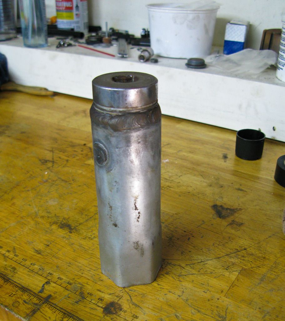

If you remove the gearbox, a standard 1-1/2" socket will work. If you want to leave the gearbox in, you will need a Deeeeeeeeeeep socket. AFAIK, there's not really enough room to get an open ender in there unless it's really thin or you grind one down.

Yes, if you don't pull the gear cluster, you'll need a very deep socket to get on that sprocket nut. One option is a 3/4"-drive socket with an outer hex fitment at the wrench end. Then the tranny mainshaft can go right through, and you can put a wrench to the outside of the socket. There doesn't need to be a whole lot of torque on the sprocket nut, as it has a locktab washer to hold it in place.
When I changed my sprocket I got this tip on here somewhere. Every long socket I found cost an arm and a leg, use a water heater heating element cheap-o socket from Home Depot or plumbing supply outlet. Then just weld on an old rusty socket to the end of it. Worked like a charm.
cheap-o 5" long 1 1/2" socket
