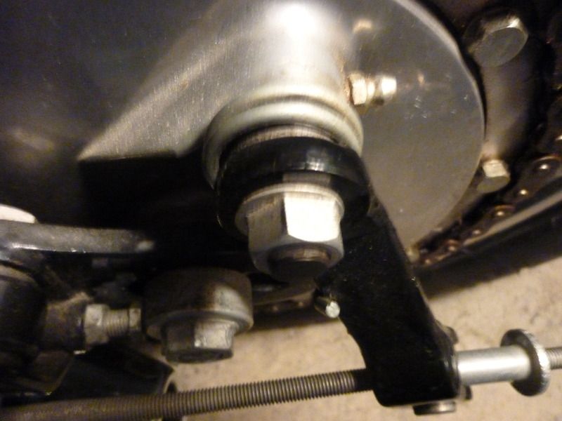

I'm wondering about I need a return spring for the brake pedal, for my 1968 A65 Lighntning?
Please see photo:

The return spring(68-6134)loops around the pin on the brake plate and hooks on to the brake lever.

Ok, I got the spring on the brake plate. So I don't also need a spring at the brake pedal?
I'm just wondering about the small hole in the brake pedal tubing, it looks like a spring end could fit there smile

Oil hole.
