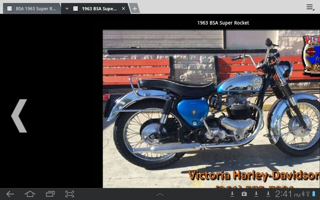

The seller has taken the bike off his website, so this screen save is the only photo I have. I'll be changing the bars for something a bit lower.
Glen

Looks like a nice bike Glen. Although I always thought they looked a little odd with the small U.S.tank.

Already found a 2 leader brake and complete wheel for it, $100.
The tank is next. I think I would forget to fill that little one often enough!
Too bad, the paint on it is very nice. I don't think it is the correct colour though. From my reading the 63 s only came in metallic red and the Sapphire blue on some earlier bikes was quite different than this blue.

I actually found those original bars quite comfortable, on my '63.
If you wish to sell them on, I might like to purchase them?
Got an A10 they'll go right onto...

Once I get the old girl home I will try them out and maybe try some lower bars on there as well. If I do change them out, will definitely contact you here.

My 1963 A10 was a good 'un. I found the high rise bars to make it extraordinarily comfortable to ride. I miss the old girl.

Thinking maybe those western bars just need to be rolled back a bit to look proper. Right now they are tipped way forward.

The size of the tank and the western style bars are great looking. Unless you plan on long rides, a larger tank isn't needed. That tank looks to be in great shape. Keep it.

From reading original ads, BSA shows a choice of 3 gallon and a 4 gallon tank for the 63 Super Rocket. Then there is discussion on various forums of a two gallon tank. Any idea if this is a 2 gallon or a 3 gallon and which type of gallons those are?
3 Imperial gallons on a bike that gets 60 MPG would give a range of 150 miles with 1/2 gallon remaining for headwinds etc.
Glen

Yes--I agree--"beauty is in the eye of the beholder".
But to me the A7s and A10s always looked spot on with the 4 Imp gallon tank.
The US tank looks IMHO like a pimple stuck on the top of the frame.
