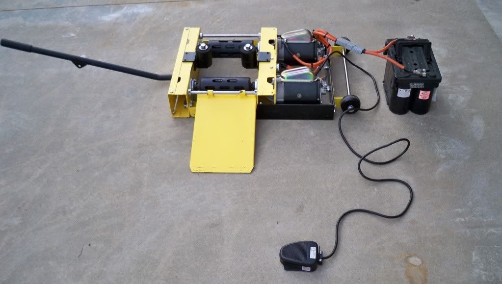

Magnetoman,
Alex is right about the rubber and the single motor, assuming it is a good starter. Art chose the Ford starter, initially, because he said it had the highest HP on the dyno. He also pointed out that the concept is to simply spin the rear wheel up to a suitable speed so that when the clutch is engaged that the flywheel effect of the rotating wheel is enough to start the bike. Although we have all done it, the object is not to use the motor or motors to sustain the rear wheel speed of a non-starting bike. At the track you often have a bike that won't start wheeled over to your rollers for a spin. That is when two motors and two batteries are useful. Good starting bikes don't need much prodding.
My routine was to roll the 500 single in front of the Doc Z, put it in second, roll it backwards with the clutch engaged and in gear until it hits compression, then pull in the clutch and roll it back on the rollers. Get the rear wheel up to speed and let the clutch out. The engine is as far away from the compression stroke as possible so it spins up nicely and starts immediately. Only a few seconds of roller power necessary. Static CR is 11.5:1, however, I have two motors, mostly because they were cheap.
The only other mod I made was to add bigger centralizing rollers (sawed up an old boat trailer roller) to the existing mounting spots. This keeps the rear wheel from moving sideways. It also keeps racers with really big rear tires from asking for a start.
I added the black frame and removable handle just to move it around easier.

Magnetoman,
I suspect the frame is the same. I made the black frame around the motors and mounted the wheels there instead of the back because the motors are the heaviest item on the starter.
A note on the rollers. The ramps don't close flat for packing if the rollers are in place. It was not an issue for me as I carried the rollers and bolts in the tool box with the starter pedal. Just two pieces of angle iron welded in a "S" pattern with a 1/2" nut welded underneath. Taking them off is only an issue if packing space is a premium.

Originally Posted By Gary E
Several years ago when my knee finally failed to live up to the kick start task of the Hornets and Firebirds 10:1 compression I built this setup.
It's a very nice looking setup. Yours is one of the youtube videos I watched earlier that didn't show problems with the rear wheel hopping around.
It has 2 Ford starters and I utilized a large Group 29 deep cycle battery.
The DocZ site recommends for their dual-starter configuration a deep cycling battery that delivers 875 CCA, which is defined as the no. of Amps it can deliver for 30 sec. at 0 oF. I only have one starter and I promise not to try to start a motorcycle at oF, but the temperature coefficient means that corresponds to a capacity of ~1300 Amps at ~70 oF. However, the intended purpose for DocZ's recommendation is to have a battery that lasts a full racing weekend without recharging, which isn't how mine will be used.
I'd like the smallest battery that will do the job because smaller is lighter, easier to move around, and less expensive. At the definite risk of overthinking this, I measured the current required to start the 6.8 liter V10 engine in a Ford F350 (which itself has a 750 CCA battery in it). I found a surge of ~150 A for the ~1 sec. it took for the engine to start. Since spinning a rear wheel up to speed is less demanding than spinning a large V10 engine, 150 A is an upper limit on what I would need.
The second aspect is Ampere-hours. Group 29 batteries are rated somewhere around 125 A-hr. In the spirit of this very rough estimate it means such a battery could deliver the required ~150 Amps for 50 min. before being fully drained. I can't imagine using the rollers for even a full minute on a recalcitrant bike before realizing I have to stop to do more work on it before it will start, at which time the battery would go back on the trickle charger. A 30 A-hr. battery would deliver the required ~150 A for 12 min. which is a factor of 10x more than I expect I will need.
The third aspect is being able to recover without damage from having been deeply discharged. This would be needed for a battery used on a long racing weekend, but not relevant for my use.
The above (over)analysis indicates a normal, not deep cycle, 30 A-hr. battery delivering 150 CCA (=230 A at 72 oF) would be fine for my use. So, ~60-80 A-hr and 450 CCA should be sufficient overkill. Absent information to the contrary, that's what I'll be shopping for this weekend.

Gary E's set up looks very well thought out . I wish i had one . The only thing missing is circuit protection.
Car/truck starters are commonly wired with no protection , but there are some good capable circuit breakers made in the 12 volt 200amp range
That could do the job . the breaker pictured is made by Blue Sea Systems .
This circuit breaker , made for marine use , is water proof with a manual switch to turn the circuit off when not in use. It is a time delay design that is capable of passing 400 amp for 20 seconds, and will pass its rated 200 amps forever.
... there are much cheaper version out there , but I'm not sure of their reliability.
I just found that breaker on Amazon for $75 and a generic "Grainger approved" less elaborate (but waterproof) one on Grainger for $27.
Now that you mention it, $27 is cheap insurance ($75 is more expensive insurance) against shorted battery terminals that almost certainly would result in flying shards of plastic propelled by a quart of sulfuribc acid.

I haven't got a circuit breaker fitted to mine--but it is a good idea.
What I do have is a switch on one of the battery terminals (cheap from any auto store) which I turn off when the starter is not in use (the vast majority of the time).
This isolates the battery from the rest of the system when not in use and is I think a useful safety feature. It also ensures that the Battery Tender is devoted solely to the battery and is not feeding any minute electrical leaks elsewhere.
