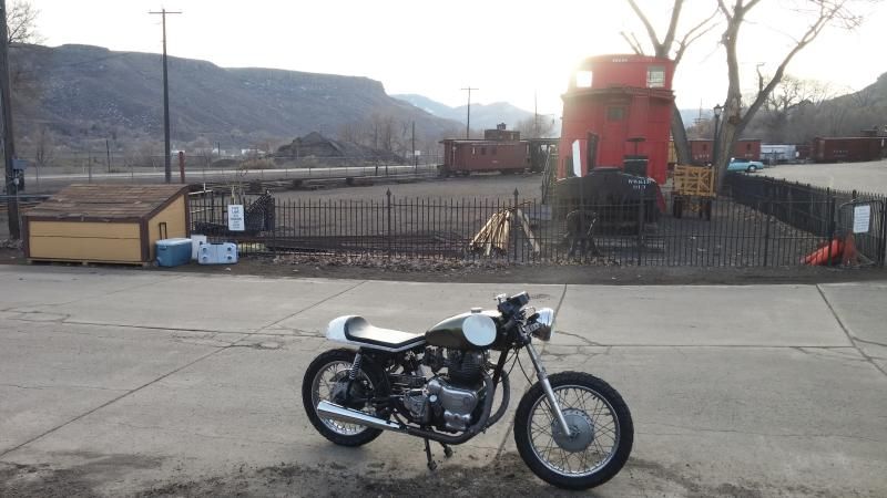

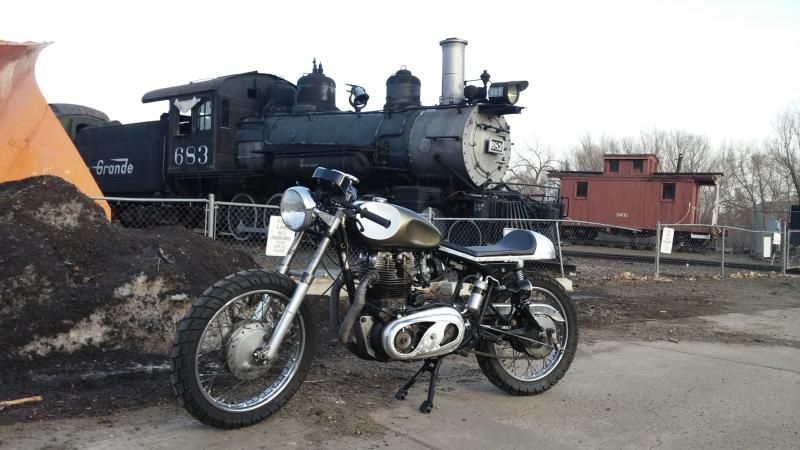

My name is Scottie, and I just found this forum. Thought I'd share my project. It's a 1958 Royal Enfield Indian Trailblazer, I call her The Blackhawk. The bike sat for over 25 years before I rescued it from a barn. i originally restored it and built it into a bobber style bike 2 years ago. Last summer, it fell over in the driveway and dented the tank, so I decided to build a vintage cafe racer. Too many parts to list, but major ones include a new AMAL 930 MK1, Thorspark electronic ignition conversion, bored +.040 over, primary converted to a dry set up, kustom steel battery box that contains all the electrics and battery, and kustom paint.
How she looked when I brought her home
Version 1
Version 2
Version 3 - Full Kustom Cafe Racer

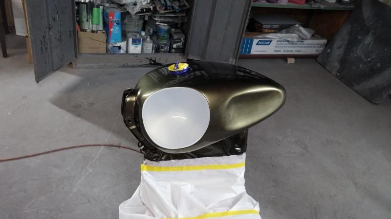

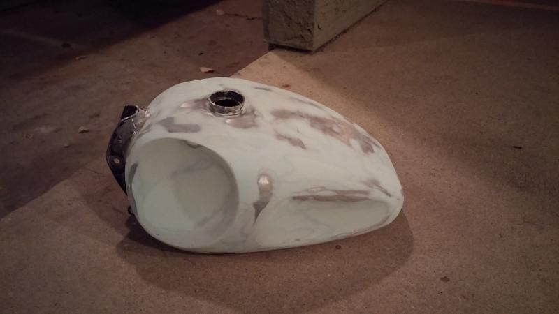

Thank you! I did in fact build everything myself, with the exception of the seat pan which I had outsourced by a custom fab shop, Bedlam Werks. It is fabbed from 16g aluminum, and the whole seat only weighs about 2 pounds total! I did do all the grinding designs on the seat pan and made the pad and skinned it myself. The tank was the original RE high capacity tank, I shaped it myself and then had about 15 hours of smoothing it out before it was ready for paint. The paint itself is black and white base coat, with a heavy dose of gold pearl over the top. Interestingly enough, the color ended up coming out chameleon British Racing Green, which was even cooler than I intended. Hahahaha! It's not finished yet, as I still need to add sponsor (and my own) stickers and reclear. I also want to clear the primary cover to seal it up., and was even thinking of grinding the timing and tranny covers to match as well. I like to do things differently, and everyone either paints or polishes their engine covers. That's why I am think of grinding all the polished metal and clearing it to make it more unique and different than everyone else's bike.
Here are some pics of the paint work for the tank. smile
