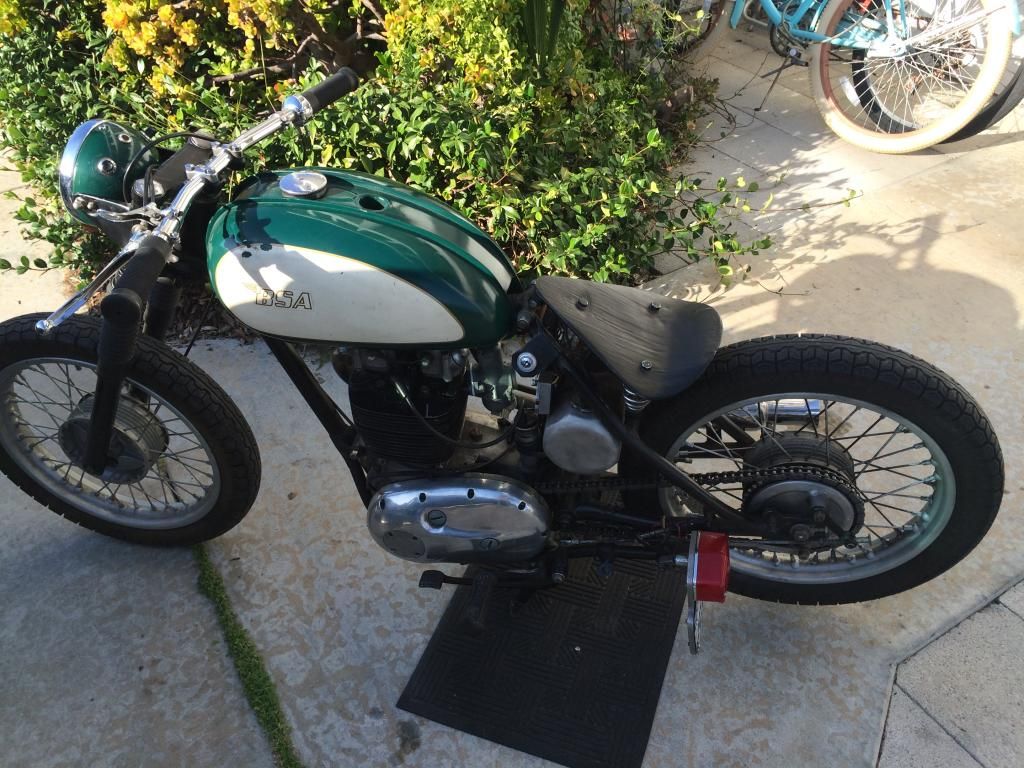

Hi guys, I have a BSA B44 441 cc. My situation right is someone converted the original frame into a hard tail by welding those 45 degree hardtail cross bars to the original swingarm. The frame in general is way to small I feel, there's not even any room to put an airfilter on my carb. I wanted to replace the entire frame. I've found BSA hard tail frames for larger BSA's like the a50/a60 but can't find one specific for my engine. I'm in san diego, California, anyone know where I could buy a frame or have one fabricated ?

no but I do get your point. It would be much easier and cheaper to hunt down a rear frame loop and put it back to normal. Anyone know where I could find one of those? the ones on eBay look pretty screwed up, and I'd prefer to find one with the mounting tabs and all that for the shocks seat, as well as the support cross bars. Getting a freshly fabricated one would be better.

I'm slowly figuring all this out and it turns out what I have now is a 441cc engine, mounted on a bsa frame for a 250cc model. The frame number is C1546469. That's why I have no space for an airfilter, its put on with a rubber elbow off to the side. As I said the guy hardtailed it by removing the subframe and mounting the cross bars off the swing arm. This is my first bike and now that I'm developing an eye for this stuff, I know it looks like shit. Not just because the swingarm/hardtail but because I also have those bars just below the swing arm where the passenger footpegs used to be mounted, so there are no clean lines at all.
So it looks like finding a proper bobber/hardtail frame for the bike isn't going to happen because they're all made for 500/650cc engines. That would also probably mean I'd have to buy bigger tires and new front forks to make it look right, at that point I'd might as well buy a new bike.
Everyone is telling me to find the subframe, or rear frame loop as its sometimes called, which holds the seat and mounts the top of the shocks. Here are the options:
A. I could find an entirely new frame made for the b44 engine, with the subframe already attached. But would that also mean I would have to buy new front forks and bigger tires? It would be helpful if I knew how big the tires and forks are on a b44 to figure that out.
B. Just stick with the little 250cc bsa frame i have now, since I already know the mounting tabs and all that lines up perfectly, despite the frame being too small for the engine, and just find the proper corresponding 250 cc subframe.
