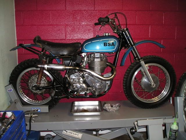

I would concur that it looks like a Jim Hunter concoction.
Was this the other one you were referring to? This was claimed to be a Jim Hunter bike but the seller, from Southern Oregon, has a rather dubious reputation. I think Julian that is on this site from Europe ended up with it. The tank paint does look similar. Jim Hunter, as much as he hated Jap bikes, liked to use a small Honda front brake.

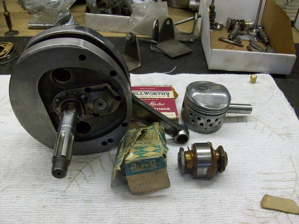

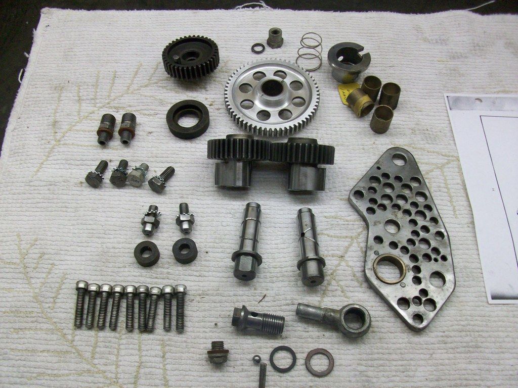

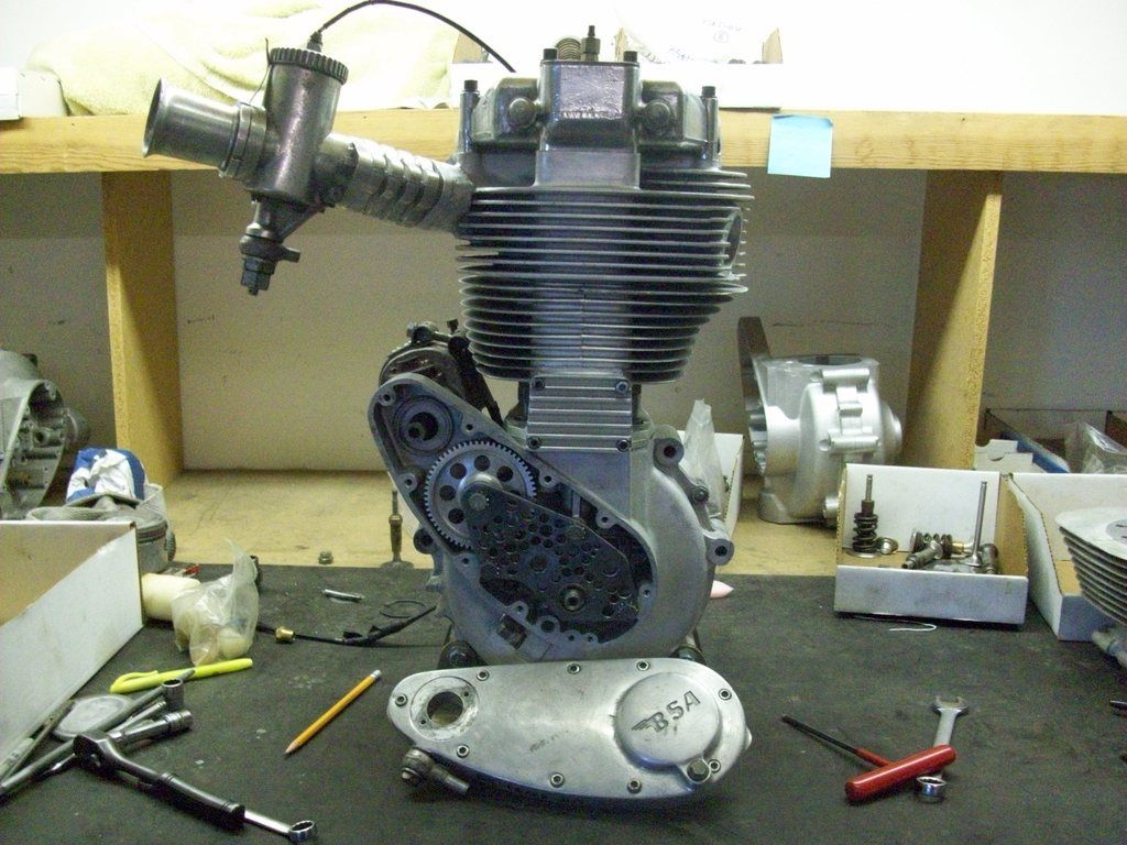

Plate 2 Lower end
Oval flywheels and new Alpha Bearing
Timing chest. Scrambles cams 65-2446 x 2. Webco aluminum idler gear. Drilled timing gear plate. Surprised it didn't have the needle bearing conversion.

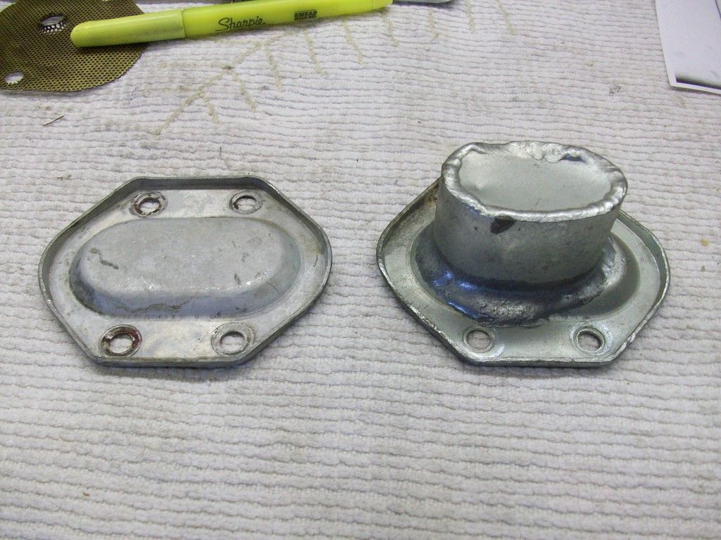

I guess it seemed a good idea at the time. Sludge trap or a remedy for pump cavitation?
Time to breath some life back into this old war horse. Off to Jake at Halls Custom Vintage. Lots of Band-Aids to remove from this old racer.

Does anyone know what the extended intake tract does to torque curve? I would think that it lowers the RPM at which ram effect is greatest, but how does that change the shape of the curve? Do you gain enough mid range so that you don't miss the loss at the higher RPM range?
