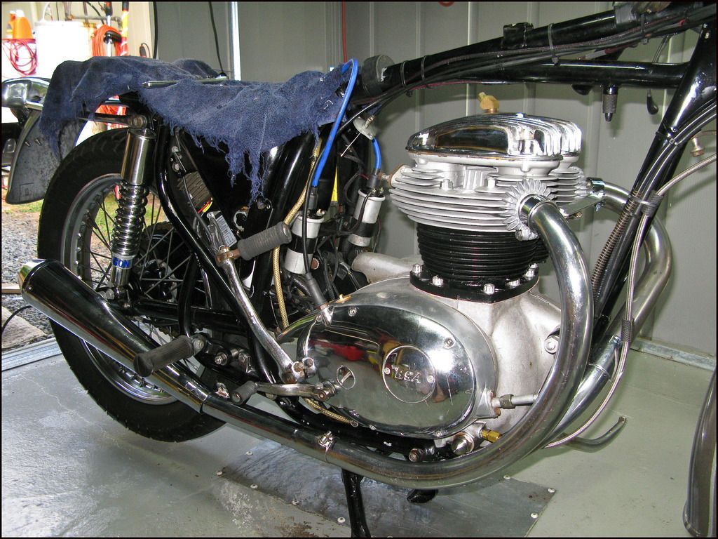

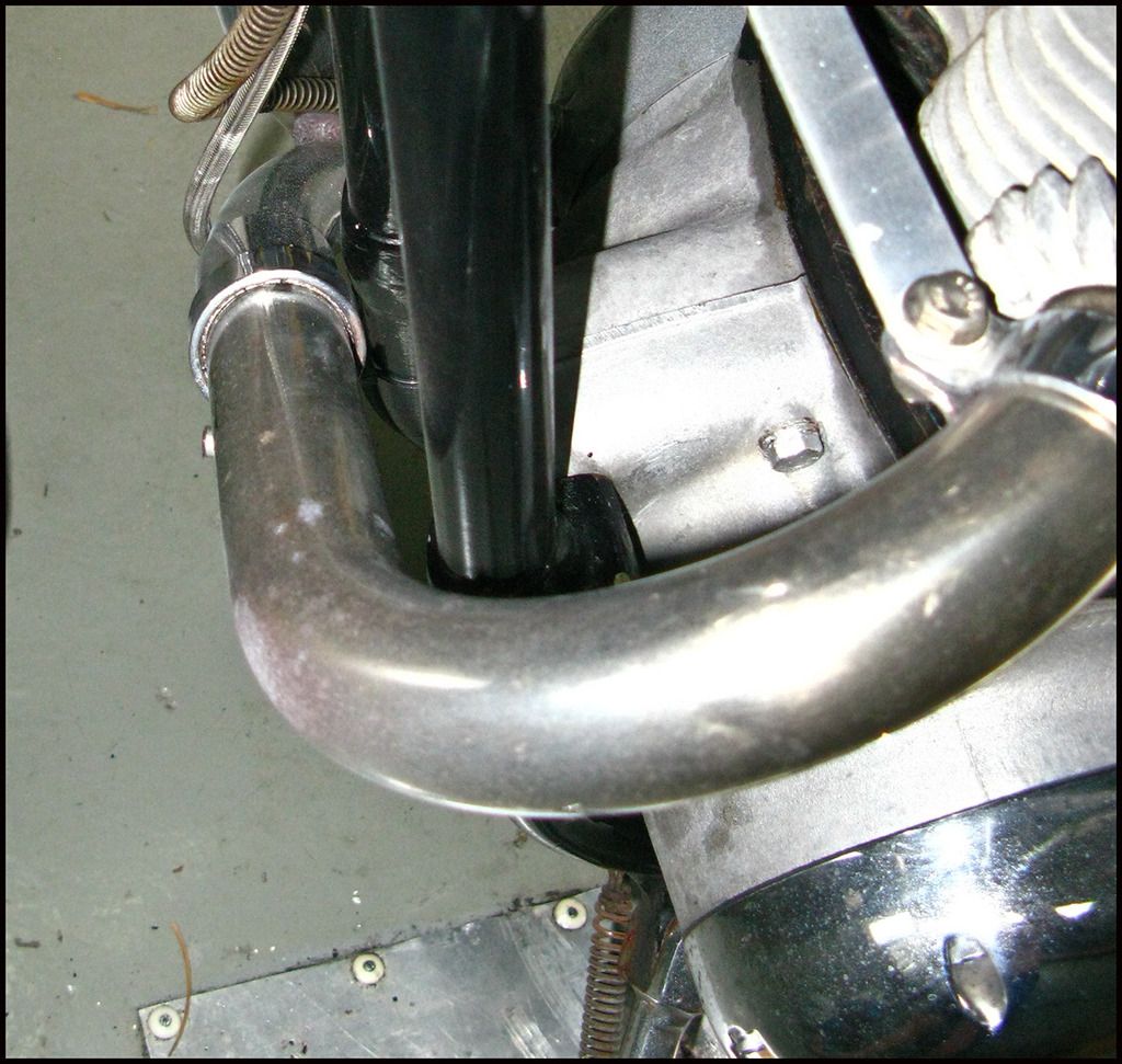

I understand you on wanting to install siamese pipes, of all the different modes I have done it is right up there at the top. I was lucky enough to find a used set on eBay for $100. I think they are used original pipes, the tubing is thicker than re-pops today and they did not have the two little tubes at the top for a threaded rod to connect them so they would stay seated. Also the chrome appears to be heaver. Was not sure what would show up at my door being from eBay but was very pleased with them. No dents and chrome was in pretty good shape.
No problem installing them, they went on much easier than expected after reading what a bitch they could. Might just be the re-pops that are the problem. I just taped each side in the head about 1/2" and then started to fit the left side into the right side, taped them in a bit more, taped the connection together a bit more and just repeated till they were seated.
Clarence is tight on the down tubes, left side is about 1/2" to 5/8", right side would say 1/4". It might be possible to weld on short extension pieces to the ends that slip into the head. If memory serves me I think they slip in about 1" to 1.25" it might even be more than that. Don't know how that would change the geometry of getting the two sides to fit together but I bet it could be done if the extension pieces don't have to be too long.
Good luck with your quest, plus the sound they make is sweet.

You saved me taking pics Roger! So no worries. The pics you took show how tight the fit is on the siamese pipes. I have my doubts the will fit a wet frame, which is a physically larger frame in a lot of places.

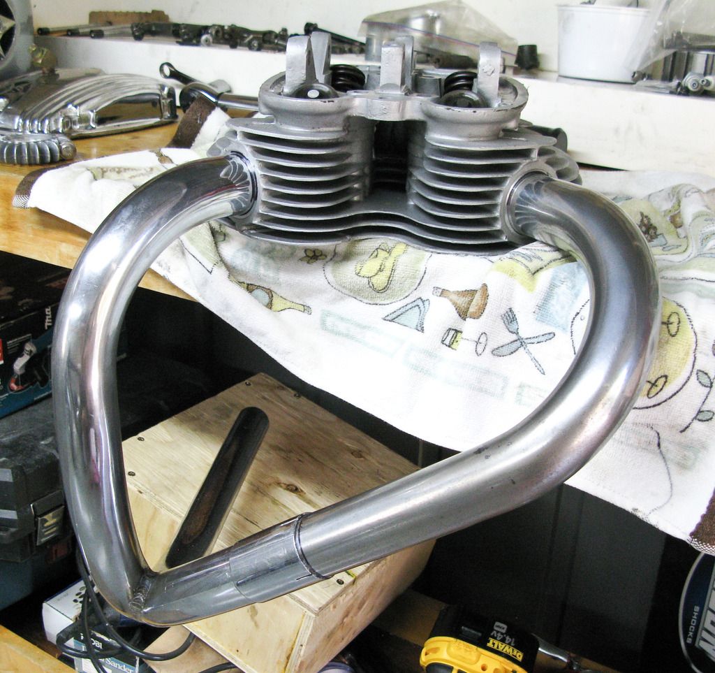

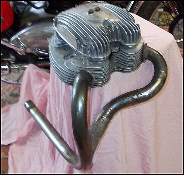

Looking at the set on eBay that I want to buy, they look like they have a bit more room than your pipes. They may not be seated all the way, which might make them look like they have more room.

Just bear in mind that you are looking at 2 completely different sets of Siamese pipes.
The pictures of Rogers bike don't have the same tie bar set up as used on the bike posted below and must be from another manufacturer and the two sets of pipe may be very different in ease of fit and the amount of clearance.
The lower set up looks very much more like the pipes my 65 A65 had on it with the long threaded stud and nut arrangement with a small bit of tube welded to the underside of each side of the pipes for the stud to run through.

That was my point. The set I'm looking at buying appears to have a little more clearance and I might be able to get away with them on an OIF bike.

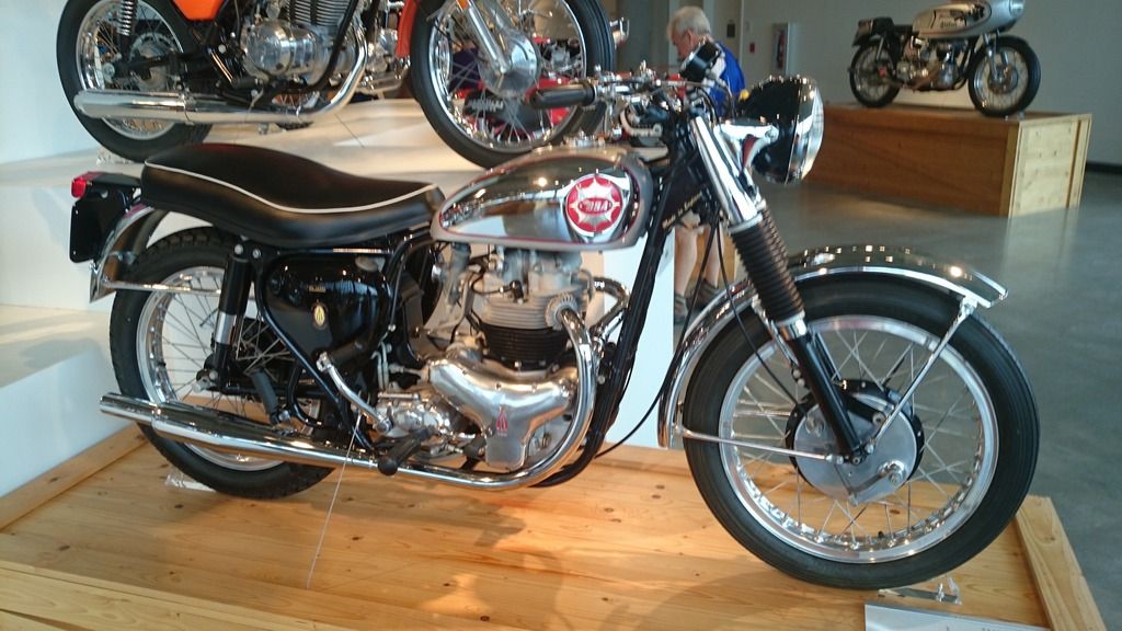

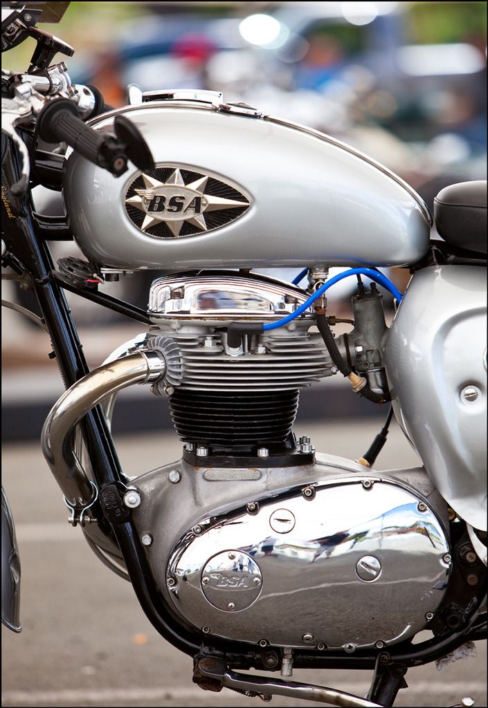

Going through my pics. yesterday I came across this one. When I first started looking around for siamese pipes someone from Australia (cant remember his name) had an add in the buy and sell forum had a set for sale and sent me this pic. of them. He had a potential buyer ahead of me and ended up selling them to him. They look like they are on a late model A65 head, he wasn't sure where they came from, I believe he said they were SS. I didn't know much about siamese pipes at the time and never noticed the bend in the left side pipe till I looked at them again yesterday while posting.
Then last night a friend sent me some pics. he took at the Barbers Museum on his trip last week. If you more enlightened members have info on it please chime in as to the pipes. Could this type of configuration work on a A65 in a late model frame?
Could this be a possibility for barreto if they make repops for this bike today?
I also found these pictures. I was not able to find another set that looked like this for sale. If someone knows where to find one, I'd appreciate it.
I went ahead and ordered a set of reproduction stock pipes, but would still like to pick up a set of siamese pipes that work with my bike. I studied the eBay set I posted and figured out that the pipes were not seated all the way, and would probably not fit my frame if they had to move any closer to it.
