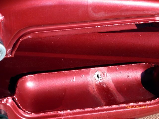

A long time ago I had someone braze the rear support bracket in my tank. I then painted the tank, trusting that the guy knew what he was doing. Ever since then I've always had a gas leak. I recently discovered a hole in the underside of the tank at the location of a braze. Why he brazed it there, I'll never know. I would like to seal up the hole. The tank hasn't had gas in it for over 25 years, so I'm not afraid of brazing it. I know that I could line the inside of the tank with something like POR 15, but I'd rather braze it shut and be done with it. Fortunately, the leak is on the under side of the tank so if I mess up the paint a little, it won't show. If I did braze it, I would surround the area with wet rags or heat absorbing paste to minimize the damage to the paint. I'm looking for opinions and suggestions as to how you would seal this leak and why you would choose this method. The hole is about 1/8" x 1/4" and is surrounded with braze metal. All input is appreciated. Here are a couple of pics to show what I'm talking about.

Since the hole is already surrounded by brass from a previous repair, I would repair it by brazing again - proper preparation and heat control and it should never be a "leaker" again
A sealer could be used in the event that the repair weeps a little fuel, but the size of the hole is too large, imo, to trust a epoxy type resin sealer ( the only kind I am familiar with)

I'm with Charlie. With the contamination from the original repair any other form of welding will become so contaminated it will likely be porous. If you donít want to braze it you will likely need to cut the current repair out and graft a patch of fresh steel in.

there's a product called Marine Tek that is specifically for patching a gas tank. I used it with success on a Triumph tank

Grind off the existing braze flat.
You will not get rid of all the braze and this will contaminate the joint if you try to weld it.
So braze on a mild steel patch. You are fortunate in the position of the hole in that you can braze on a small patch above and around the hole and it will not show when on the bike.
But don't assume that all the fumes are out of the tank.
I have only seen one gas tank blow when a welded repair was being attempted--and it was not a pretty sight.
Use the old dodge we used when repairing a tank in the pits between races.
Take out the gas taps (cocks) and connect a piece of rubber hose from your car exhaust to the gas cap opening and run the car for ten minutes.
This gets rid of all the fumes and you can then braze away.

The engine exhaust works...In fact the Russians during WW2 directed some engine exhaust into aircraft fuel tanks to make them less likely to flame when hit by bullets...
I weld/braze bike tanks often, did three repairs just last week. I drain the fuel,remove petcocks and use the shop vacuum on "blow" with a home made adapter to ft the tank filler opening. About 1/2 hour to dry up any fuel fumes.Usually let the tank air out overnight, then the next day blow with vacuum for 5 minutes....
Before any open flame or welding I have a propane hand torch on a 6 foot stick.. light it and wave it over the filler opening.. It won't blow but it might momentarily flare...no big deal if your body isn't over the opening.But after doing the described I never had a tank flare ....

Thanks for all the responses. I believe I will use low pressure compressed air hooked to one of the petcocks to blow through the tank while brazing. I like the suggestion to use a torch on a 6 foot stick. Hillbilly Bike, what do you use to confine the heat to the repair area? I don't want to have to repaint the tank.

tommy b, do not connect an air supply to the tank while attempting to braze it, you will be making a bomb which will go off as soon as a naked flame gets near it and believe you me I have seen my share of bombs from where im from. You need to connect an inert gas supply to the tank, not an air supply that has oxygen in it. The easiest method is to start a petrol engine and connect a hose from the exhaust into the tank, this means there is no oxygen in the tank after you have expelled it with exhaust gas so an explosion shouldn't take place. Notice I said shouldn't take place. Also please be aware then you will be working very close to a source of carbon monoxide gas which can kill if inhaled in in fair amounts.
This is the way I braze petrol tanks after drying them out for a day or two and I haven't had an explosion yet. In saying that I am still on edge when I am brazeing as I know its a petrol tank and that there is still a chance that it could explode.
Don't let these comments stop you from fixing your tank, I just want to make you aware of the possible traps you could fall into. Hope it works out well for you.

Thanks for the tip. I'll be working outside so CO should not be a problem. I guess I just run a hose into the fill port on the tank and let the exhaust gas escape around the hose an through the fuel valve ports, right?

My father was a radiator and gas tank repairman. He filled the tanks with water and with a small bubble at the point where he was working, he could repair the hole and not be exposed to CO, or any chance of an explosion and it's much faster to finish the job.
Well, that's how the pro did it.
Could be a problem getting a small enough air bubble right where that hole is, though.
I used to tig weld holes like this in fenders and such. I could weld this one up is about ten seconds. I'm not a welder, either. Just part of my job at the time. I personally don't see a problem with the brass. Just grind it off and go for it.

If I were you I would grind it back a bit and braze a patch on it
but im not you and I have the use of mig ant tig sets so for me I would cut it out and weld a piece in to it.
