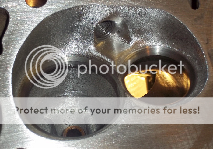

This video may show a bit how port configuration can effect throttle response. I'm experimenting on a theory, Bigger carbs ports and valves flow more air therefor make more HP, how ever there are side effects and other factors. What happens if one finds and fills the big port where the airflow is pretty dead? Will it flow more or less? The carb and valve are the same the port is only filled where air is very slow moving, all that can do is speed up the flow of air through the port giving it more energy and more volume past the valve at a given RPM,(I'm guessing that is what is happening) the effects of which are pretty cool. Interestingly the thing effected is throttle response, turn the throttle it goes, turn it more it goes more.
https://www.youtube.com/watch?v=1Bb4XfUkyVU&list=UUUP_VDGHuTLC5wUtLg-Y8dA

Im thinking what IMO you need to figure out first is the flow numbers you need on the intake side that will make the horsepower in the RPM range you need. It helps if you have probed the port velocity before hand and after porting. The loss in velocity if there is any can be regained along with throttle response by filling and reprobing the port to win back some velocity. IMO This high velocity also helps creates better intake pulses to take advantage of as well.

By only filling the dead area, I was able to keep the same main jet but increase max RPM ( to a point where I didn't want to see if it would go higher) esp in the lower gears.
Increase in torque was noticeable, where as normally you would down gear the bike to improve acceleration, you can now upgear the bike and improve acceleration - sounds daft but the rpm's climb at the same rate regardless if the load, the taller gearing just turns the back wheel more for the same rpm
Mixture at lower throttle openings was effected however ( now too rich) and it would be interesting to see how high you can lift the floor until it drops off.
The way I see it on a flow bench, the higher the velocity the higher the CFM on the flow bench.

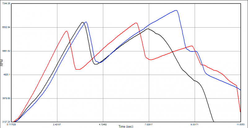

RPM graphs before and after Bulldog: Red trace is latest spec with extra fill on the port floor, slightly retarded cam timing and 12.3-1 compression. All traces are roll ons from 3,000rpm. The main difference occurs between 3,000 and 4,300rpm and gives a massive improvement in that range and below, and does not diminish top end, so it is a definite win especially useful in 3rd or 4th where throttle response in that range is so much better.
Gear change out of second on red trace is at 100.
I've since lowered the comp to 11-1 though the higher comp gave no problem other than distorting the head gasket around the centre head bolt where I have now fitted a spigot that is tight in the gasket and should prevent distortion.

There you go! And here I thought you hadn't logged any info. LOL So, yeah it looks like you did get, if not more power, better throttle response overall throughout the revs. Was this info obtained from data logging?

Bulldog, that's using a veypor data logger. The rpm graphs are very dependable, sometimes the speed messes up which puts the dyno HP measurement out, But rpm against time is good for comparisons.
